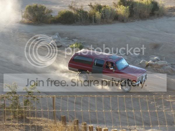

Wow ! can't beleive I've never posted my chopped&bobbedburb on here :crazy: It's on 39.5 boggers w / 6" bds front springs , flip shackle w/ 56" long springs in back & Custom anti wrap bar . 1 tons w hydro assit . 350 ( soon to be 454 ) sm465/np205 . Put it together quite a few years ago .

XMLs, a true 38" tire. Iam gonna test them next weekend at truckhaven.

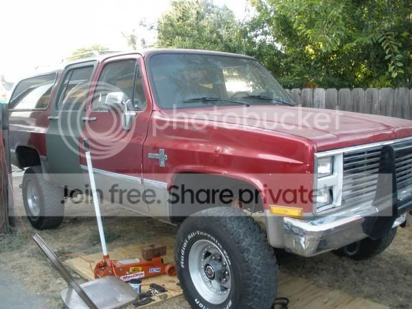

The rockers were also raised and a few other areas were reenforced.
