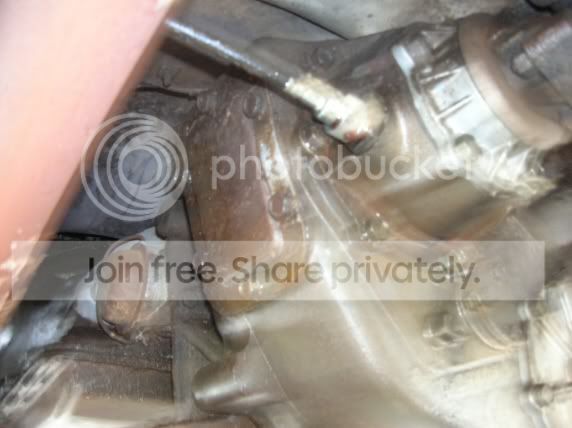

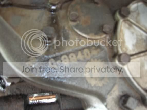

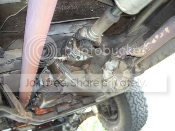

my local parts monkeys lack the proper hardcopy doccumentation to look up the kind of information i need. thier text based computer parts search makes a positive ID damn near impossible. anyway here are some really bad pics of my t-case and based on the poorly drawn pic of a NP205 in the chilton manual i just bought it somewhat resembles what i have. but i like a more positive ID.
i was just poking fun, i work at CarQuest.
and when we search, it shows the transfer case model. i searched my '69 and it showed the rockwell transfer case in the computer. also tried a '72 K20 and it showed the np205. i guess if you arent familiar , you arent familiar.
oh and that IS a 205.
i dont have anything agenst part guys, i just remember a time when they had several books behind the counter with pictures and break down diagrams seems they have gone away from that or they just dident want to help me, either way i got what i need and the seals are ordered. on to my second question about the tranny swap, would the output shaft my TH350 has work for the 700R? or do i need to buy a diffrent one and is there any diffrent adaptor i may need to get for the 700R to bolt up to the NP205? will the current crossmember and mounting location be a bolt on or will i need to relocate and drill new holes? ive never been told to assume anything but from what i could tell the bellhouseing and tourque conveter look like a direct bolt on to my 350 V8 and the burb had a LT1 350 in it so i shouldent have to change the bellhouseing or tourque conveter but coudl there be a situation whare it wont fit? the 700R im getting from what i understand has about 70,000 miles on it the fluid looked bright red and it had the factory filter on it still. but it had a slushy shifting feel b4 it was pulled. i plan to have this 700R fully rebuilt with heavy duty use in mind and i like the positive feel of the shift kit thats in my TH350 so ill want that in the 700R as well. if i can provide the shaft i need and the adaptor (if required) to the rebuilder they will attach it as part of the rebuild. then my last concern is my shifting linkage, as we all know in a 71 the gear indicator is for a 3 speed i have no problem removing the indictor and the gear display but will the ring on the colum and the linkage support the 4th gear? i dont want to go to a floor shift as the T-case lever would have to be relocated and im just to lazy to move something if i can make what i have work. i can repair whats on the truck but i have never done a swap of this magnitude before. i dont have any tools to fabricate anything so i have to use what i got. thanks for everyones input im just trying to see if this mod is feasable before i start shelling out $$$ for used trannys and a rebuild and put my truck out of comission for a few days
then you have it... that is unquestionably a np205... with a 27 spline input, 32 spline fixed rear output and 10 spline front output.
