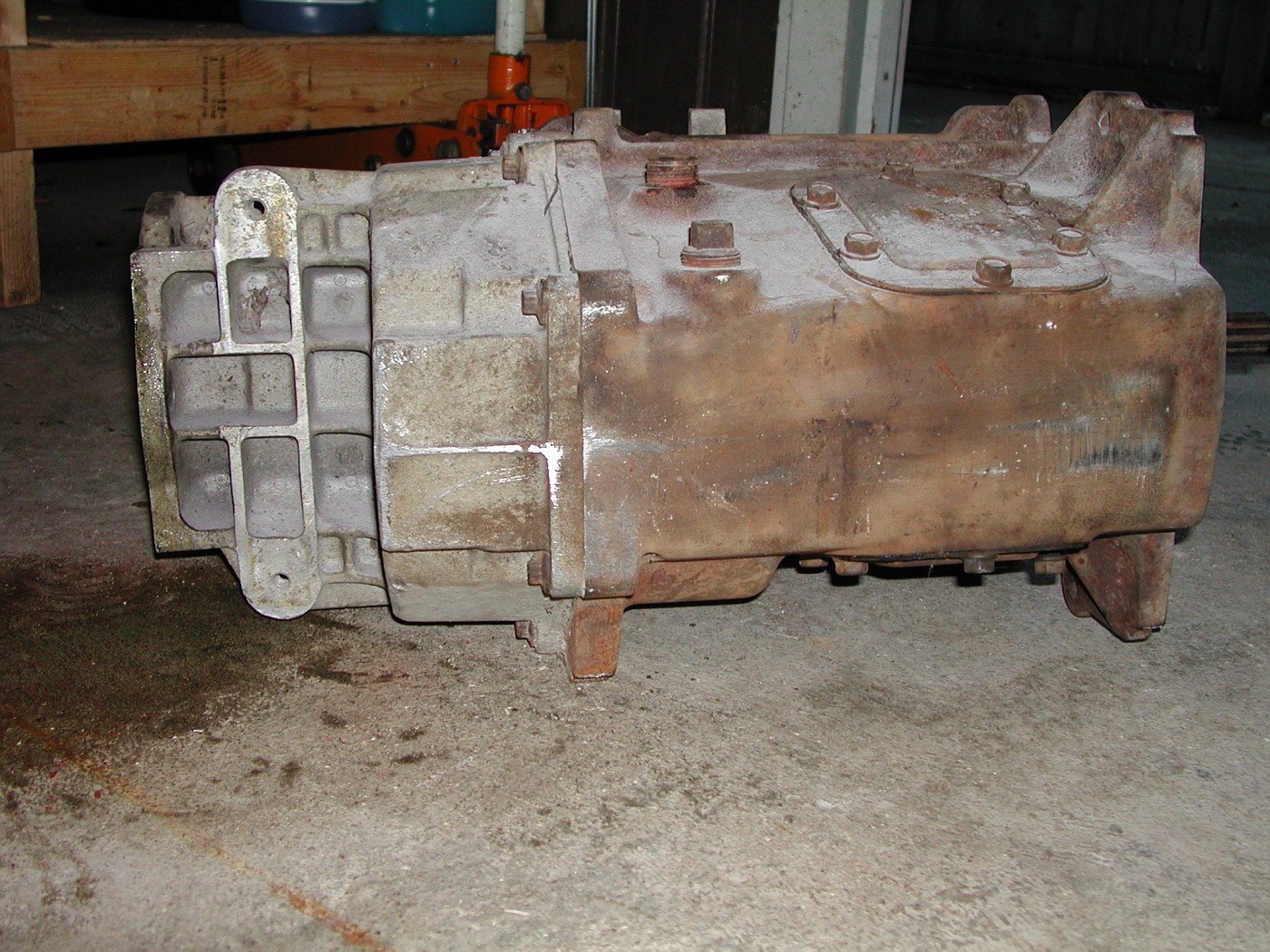

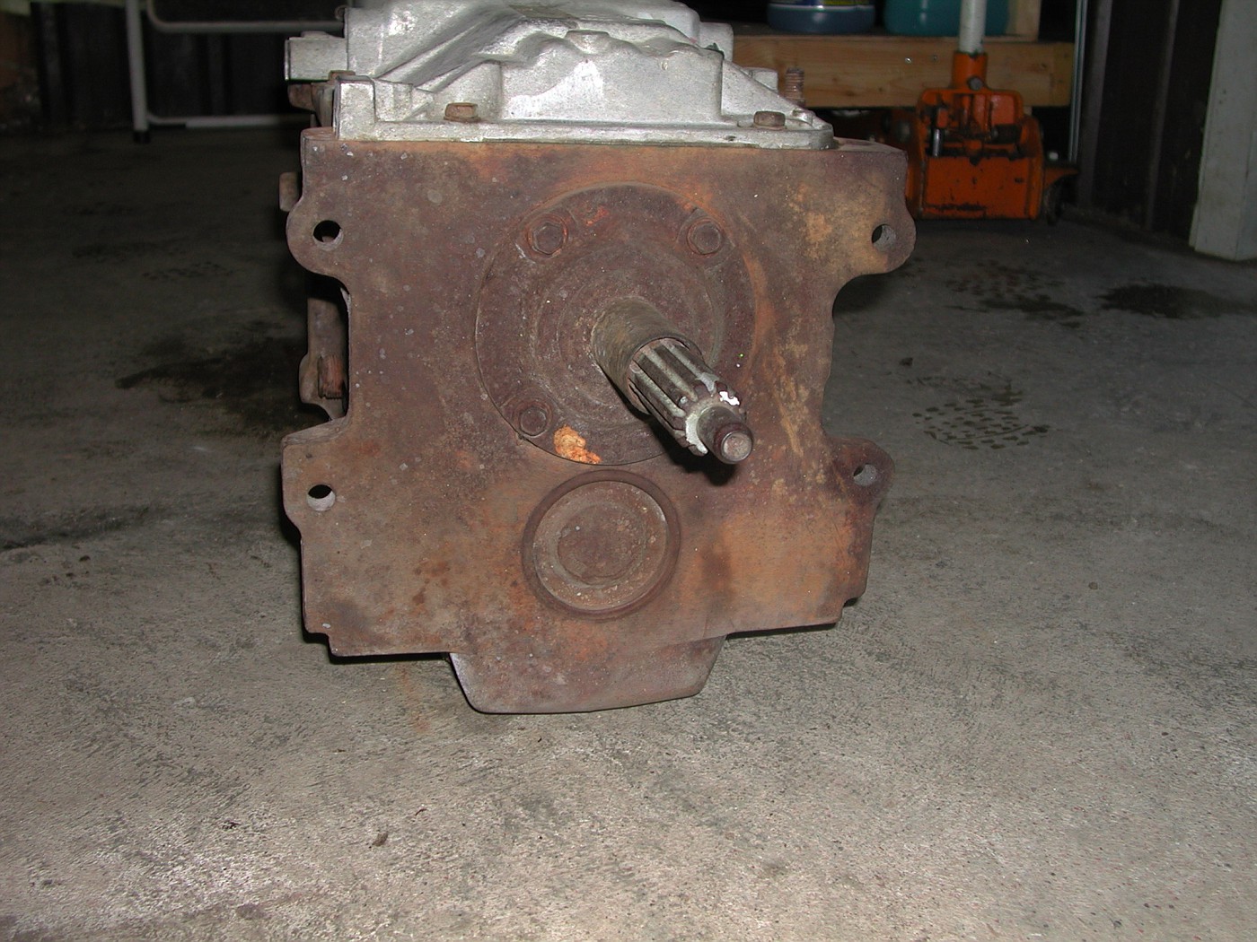

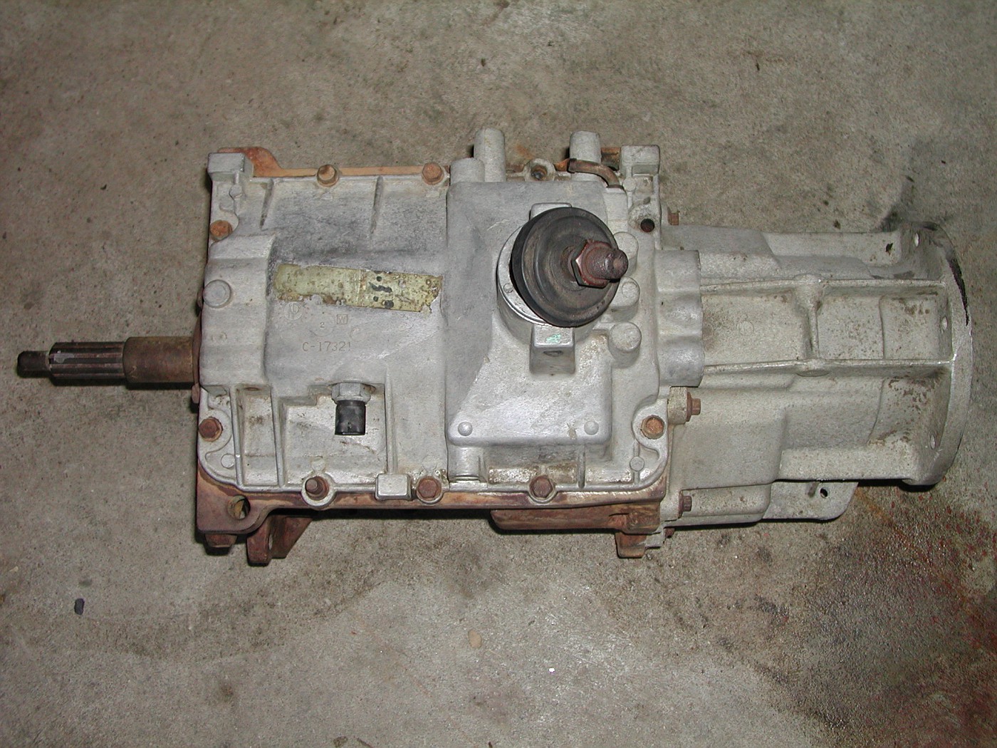

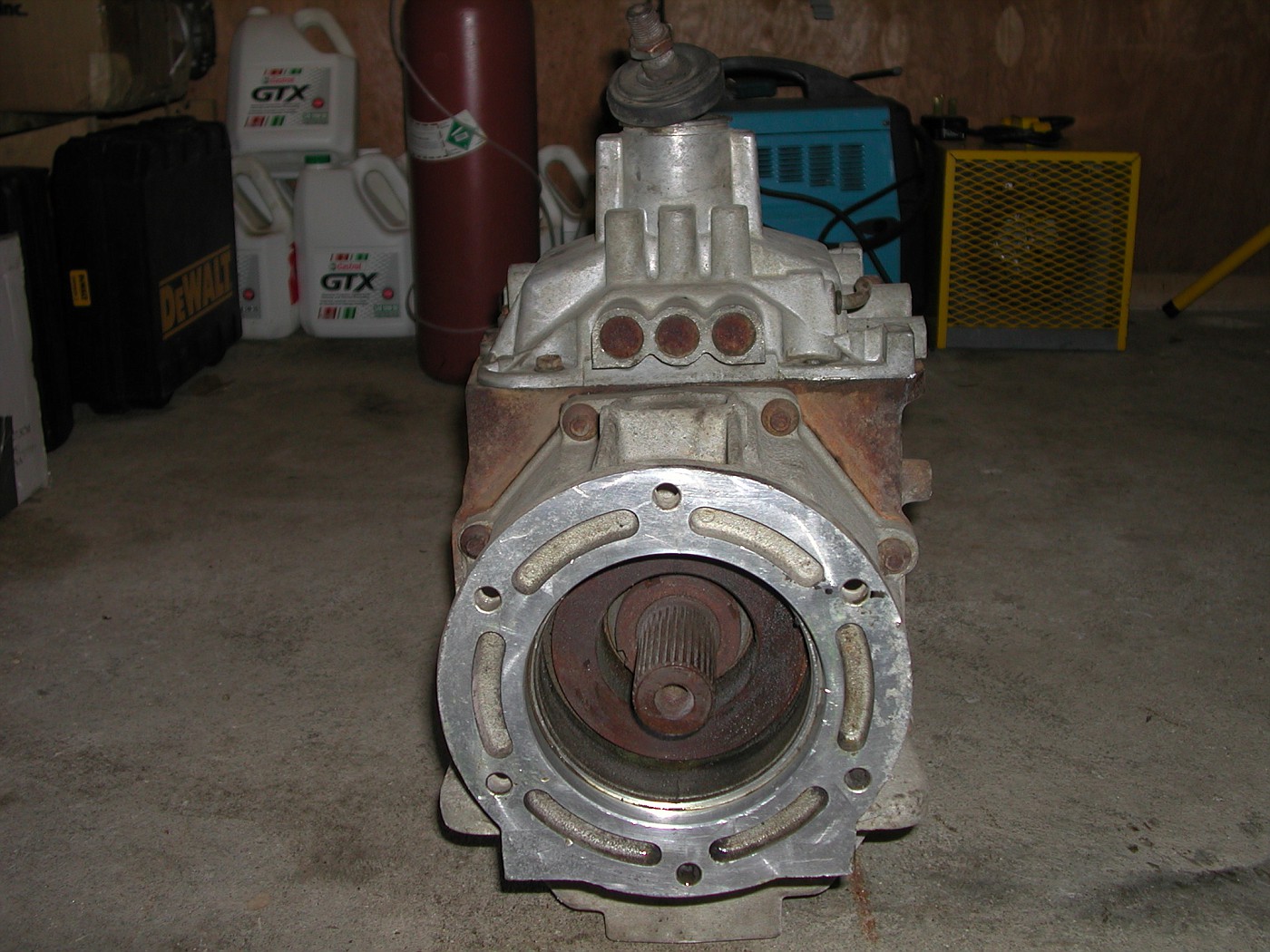

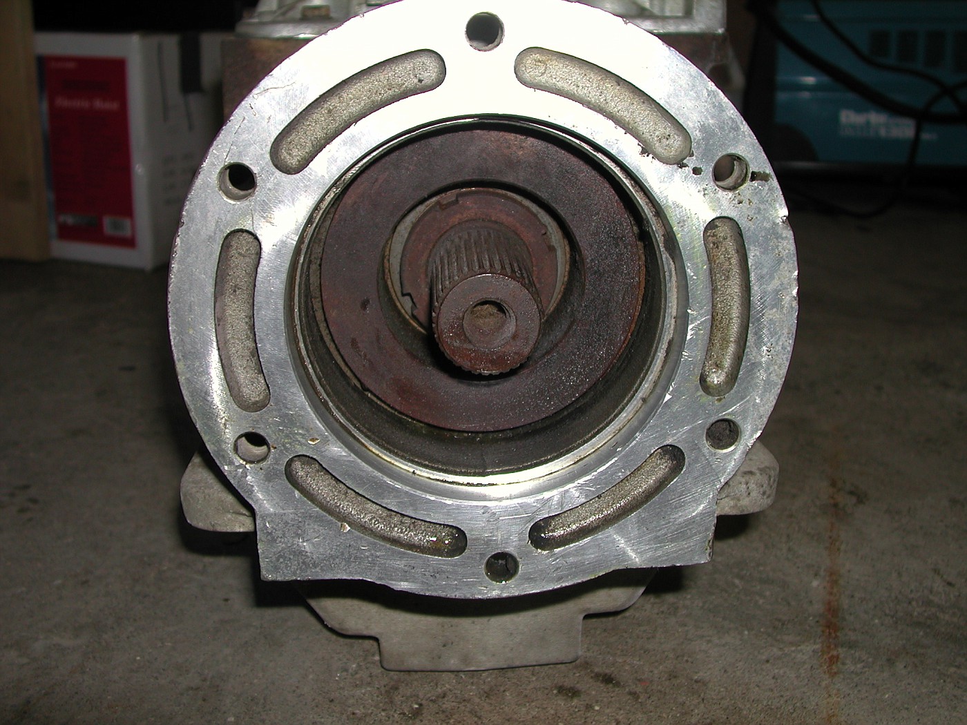

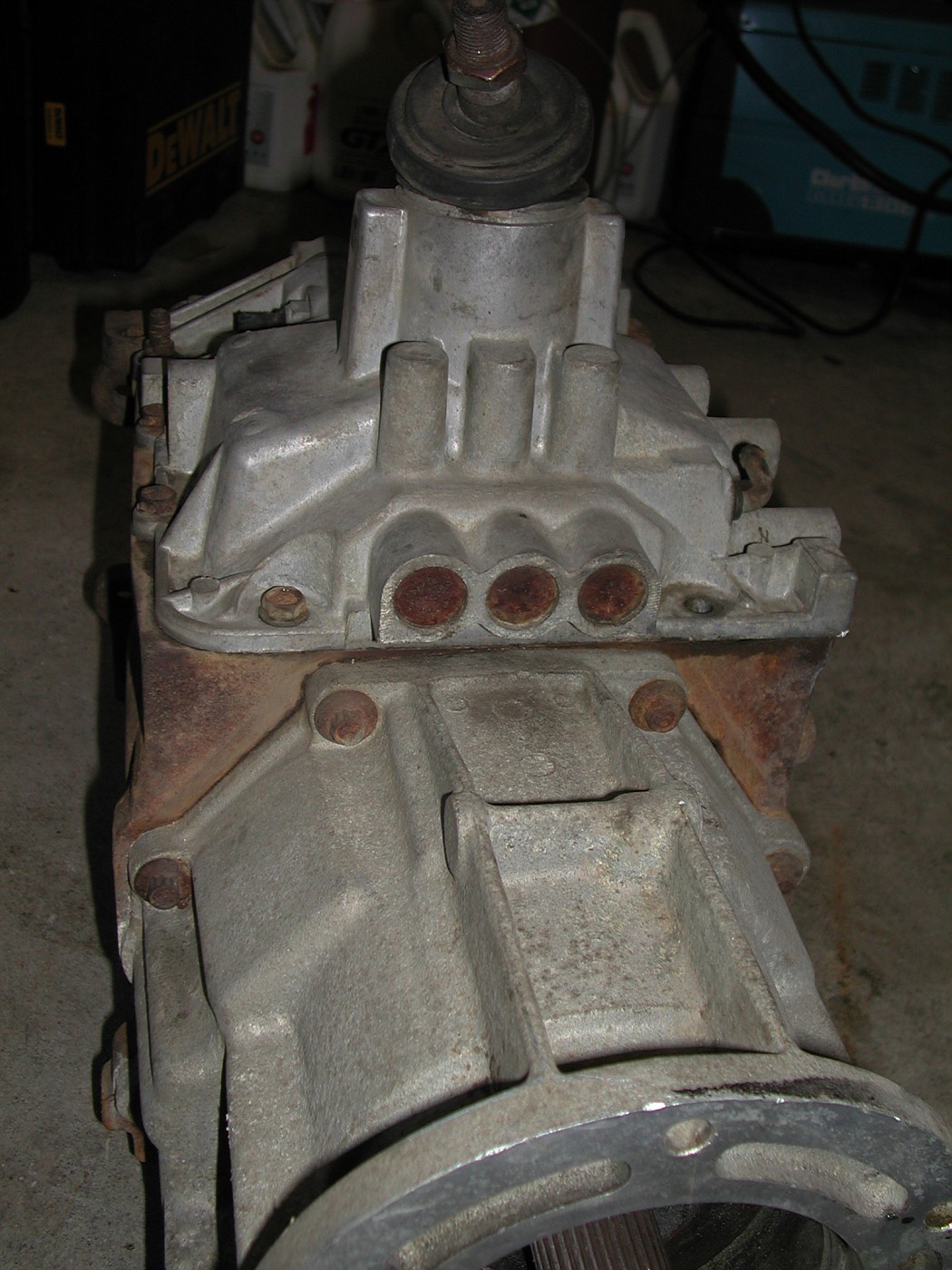

That's right...$475.00 CANADIAN dollars for a 1993 NV4500.
New from GM it was donated to a automotive school but was never touched,torn apart or installed in anything.
I bought it from a guy who worked with the auto class teacher.He was going to put it in his Jeep but being a GM NV4500 the overall length was too long so he let it sit for the last 5 years.
The surafce rust is from sitting outside for 6 months.

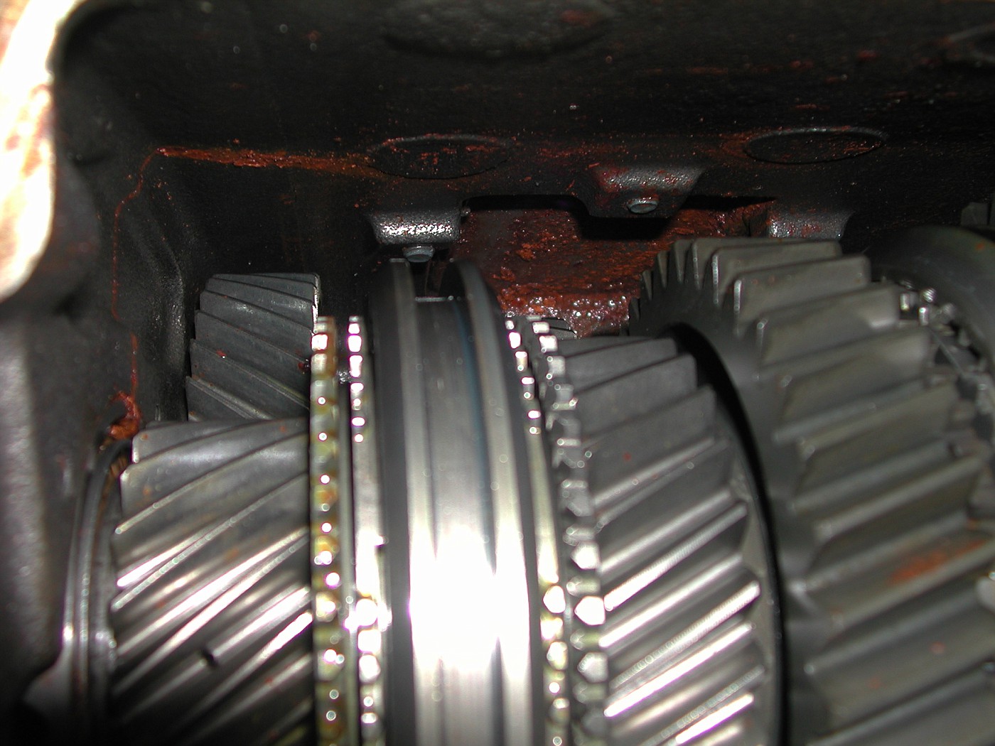

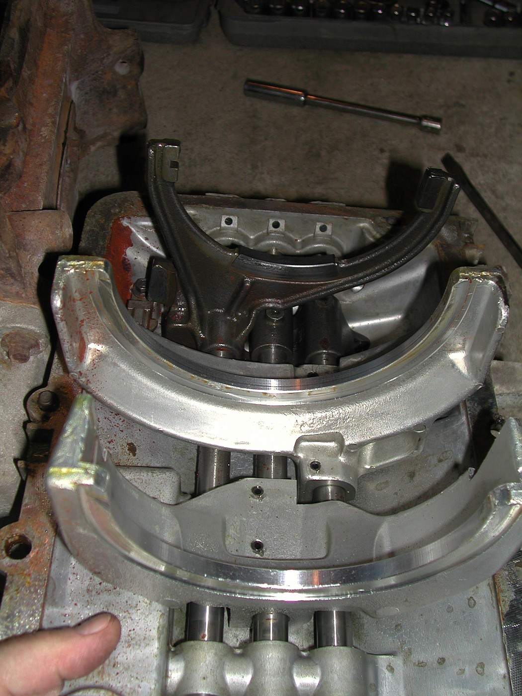

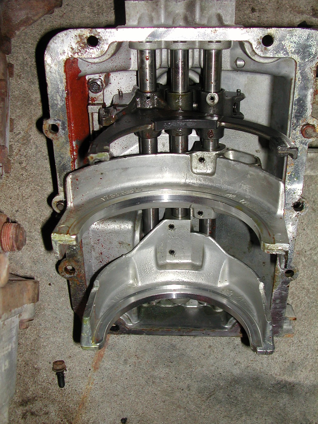

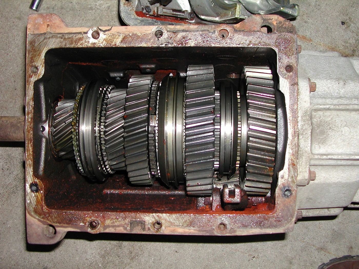

I took the shifter plate off and it looks perfect inside.The gears and shift forks do not even have any wear marks.

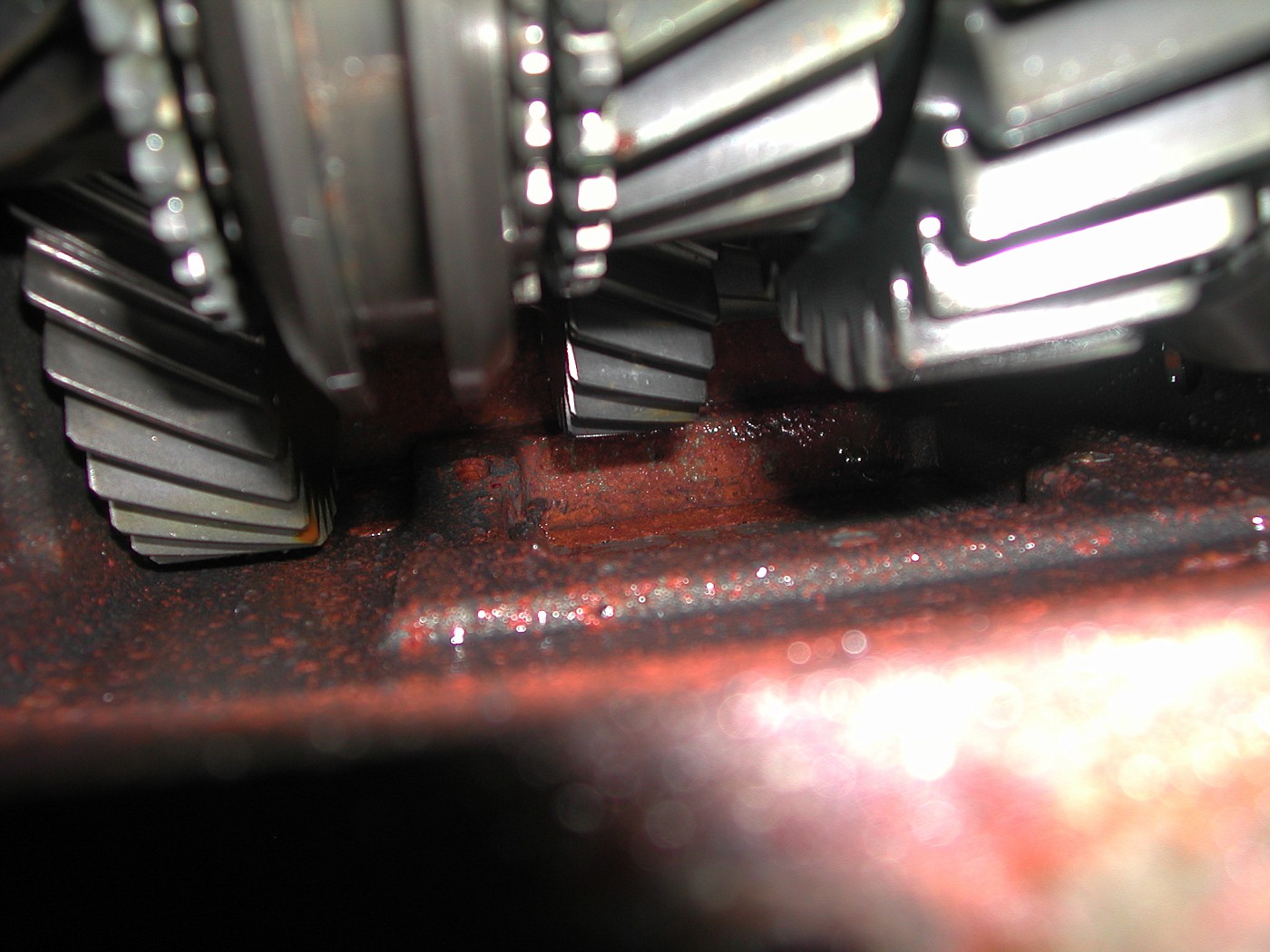

The bottom of the case has some minor suface rust on the inside but I'll take care of that with a sand blaster.

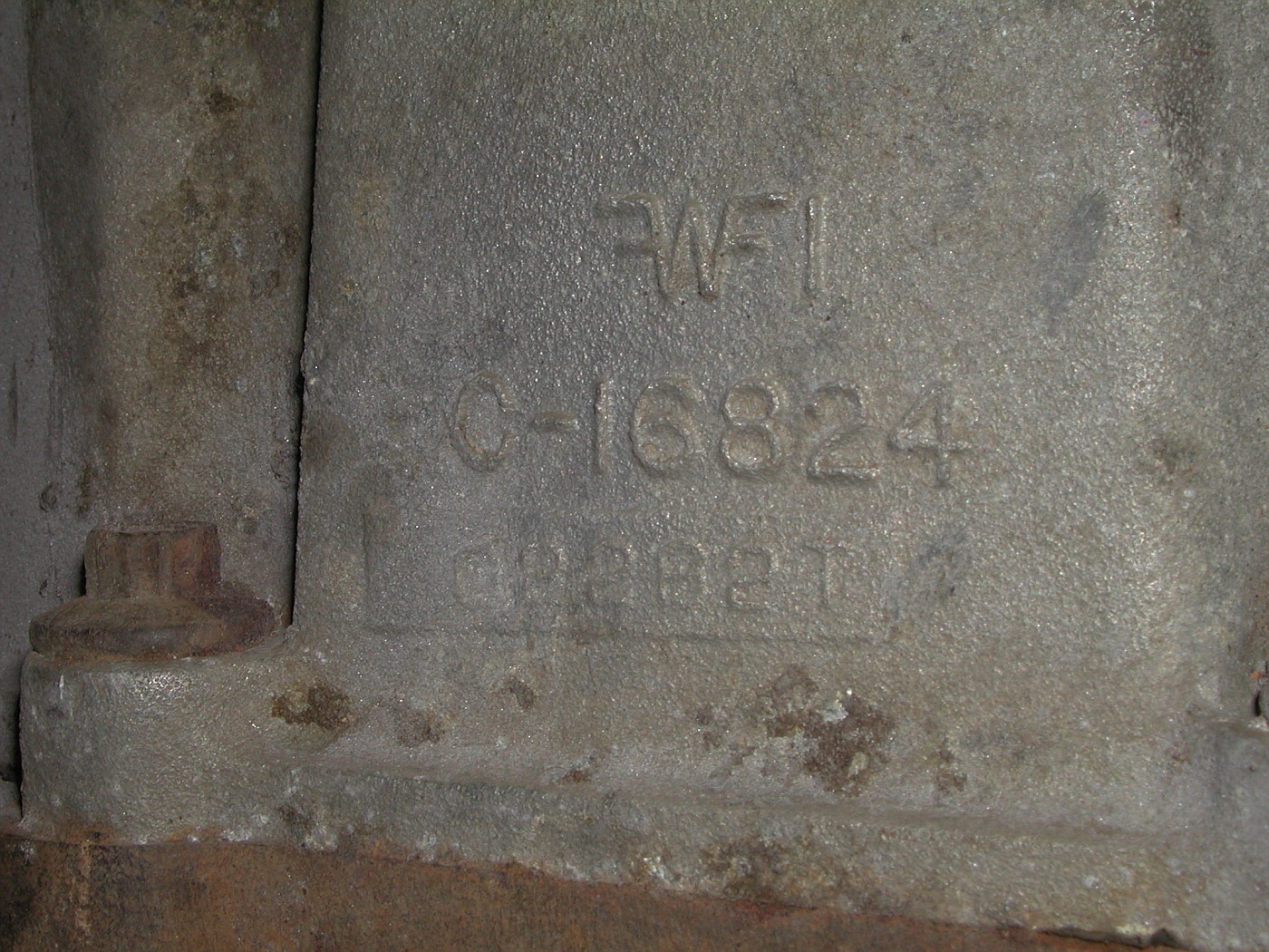

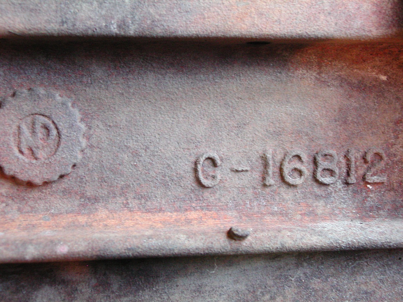

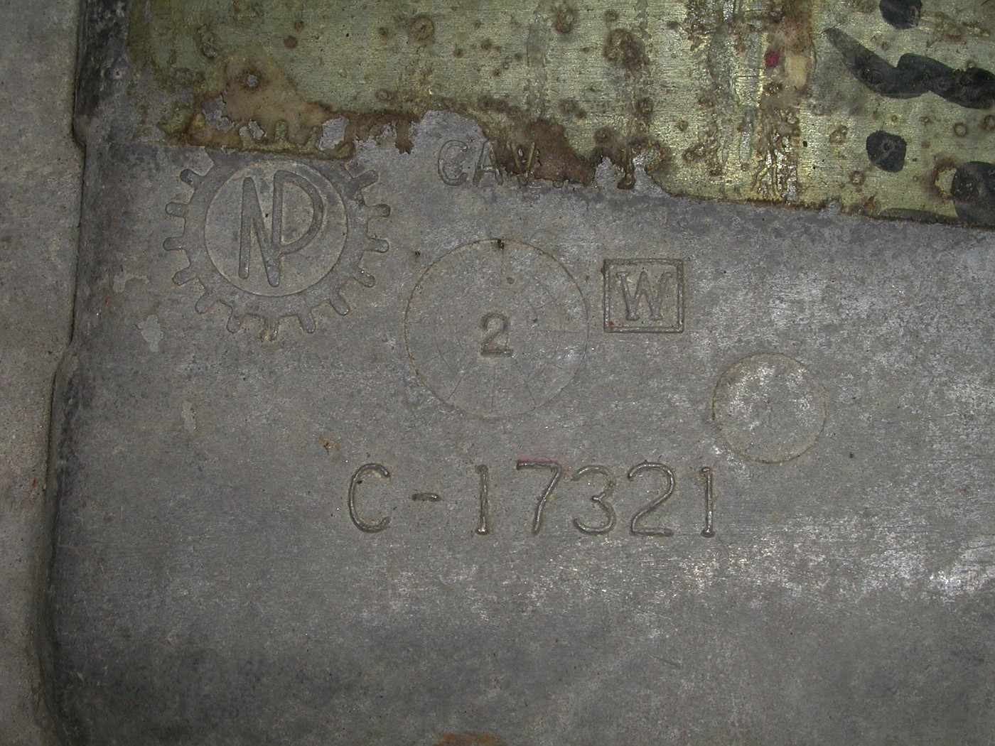

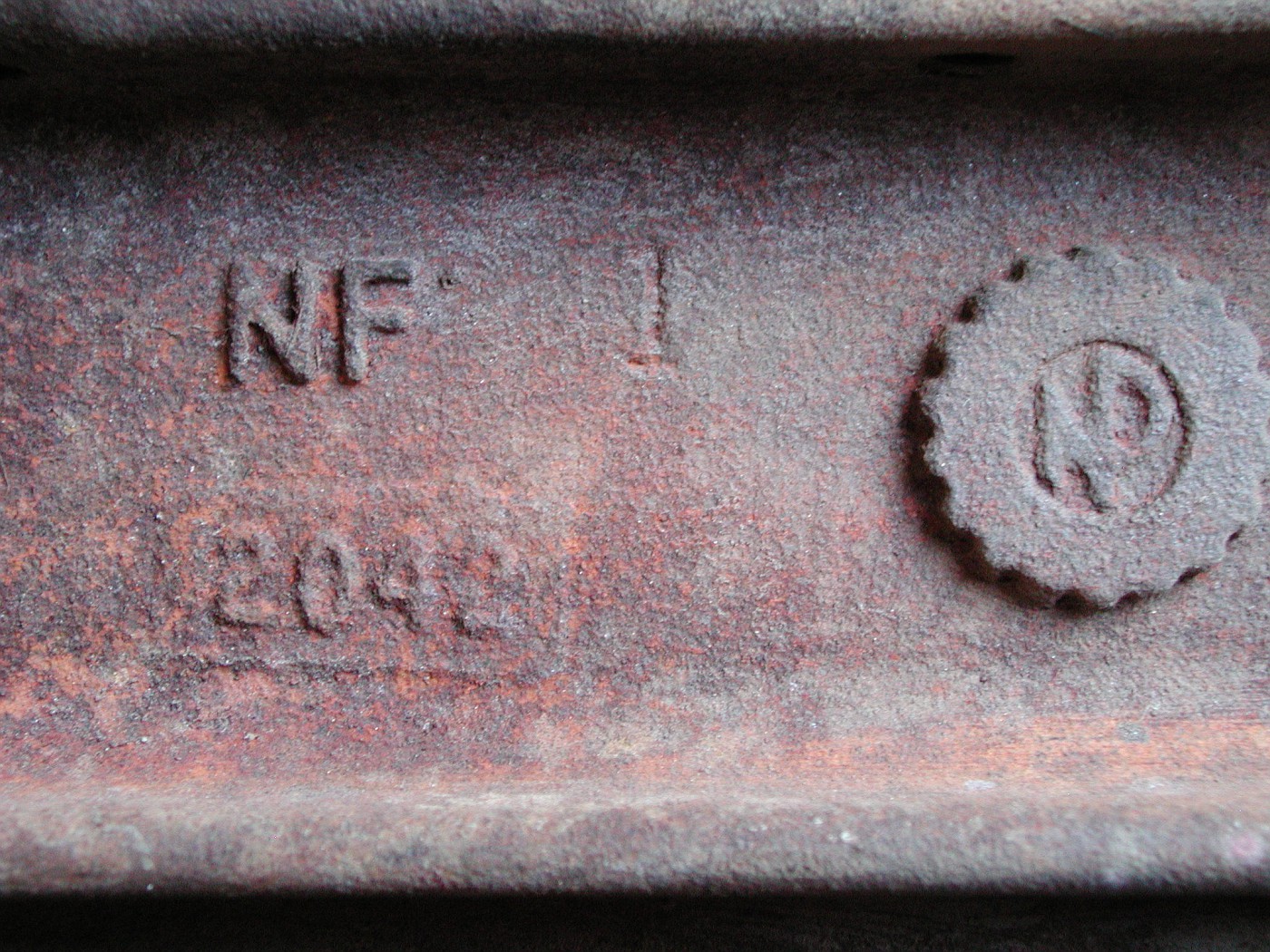

Here are a few pic's of the cast in numbers.Anyone know what these number mean?
This one is on top of the shifter plate.
This one is on the side of the 5th gear cover.
The next two are on the side of the main body of the trans.

um, i definetly wouldnt worry about the minimal rust inside. also, i hate you!:D

sweetk30....I'll try and clean the inside the best I can through the PTO covers but if I'm not satisfied I'll blast it.I was going to Blast the outside anyway.

Regarding disassembly, the countershaft will not come out without removing the rear bearing, or at least the cage. With that amount of rust inside I'd be sorely tempted to replace the bearings anyways.

Too bad they stored it outside with no fluid in it -- Some people really are daffed, lol
