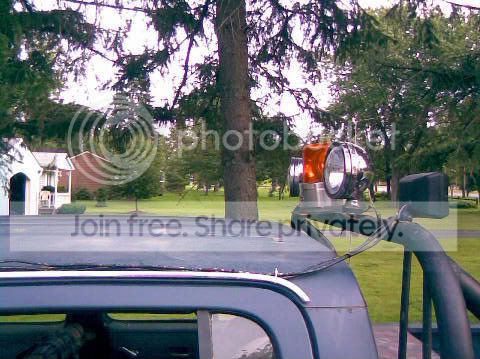

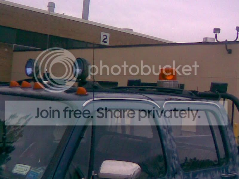

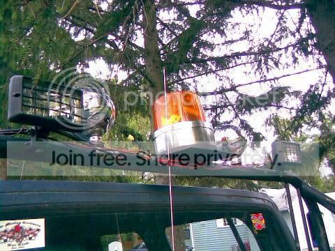

i built a 'bar' from stuff i had around, and mounted it like a headache rack... about 6 months ago, and now i don't reall like it... so i've been thinking of a way to replace it... i got a set of roof rails from a mini-van, grabbed the 'nut-serts', and some foam insulating tape... it's mounted now, and i have 4 lights mounted on it thus far... i still have a 48" federal signal jet stream light bar that i'm going to mount to it later, to remove my bubble light (hey, she's an all around duty truck...)

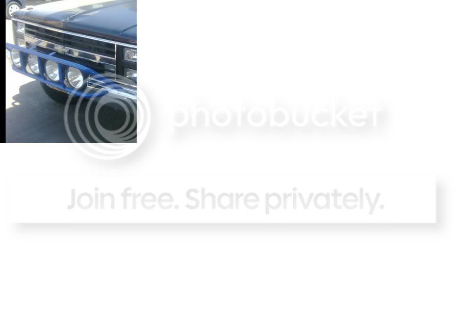

I agree with dremu... I built a light bar that attached to the gutters and after a few days of building I scrapped the whole thing and mounted them on the front bumper. It's too flimsy to really torque anything down.
