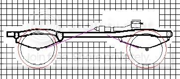

the wheel base as it is now
132 in
If i cut it a foot 120''
I made a lil pic
This is a 120'' wheel base
The motor back a foot
I figured on 56'' springs front and rear
12.5 degree rear u joint angle at each end
The front is a 10deg angle at each u joint
so I figure I can take another 6 to 8'' out of the frame without probs:dunno:
what do you guys think

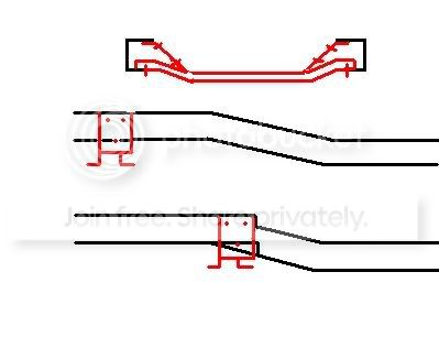

Well I have about 8 inches before it starts sloping towards the back
heres a pic
first two are like the stock 4x4 is and 2w to some extent but the first two are stock the last is what im gona do hopefully!
