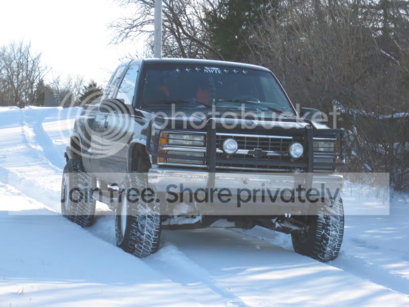

I have a 92 1500 with the 350. I am having issues with it idleing at stop lights. It will only die when the enigine warms up to operating temp. When its cold it has no problems sitting and indleing. Any help would be awesome
This is the truck
