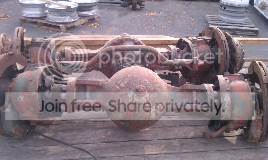

Ah, it's subjective. At least you can push around a D60 by hand.
These..... are heavy, about 5000lbs for the pair.
If you ever find a good deal on a Dana 60, then go for it. Otherwise, just fix what you have.
