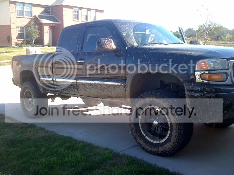

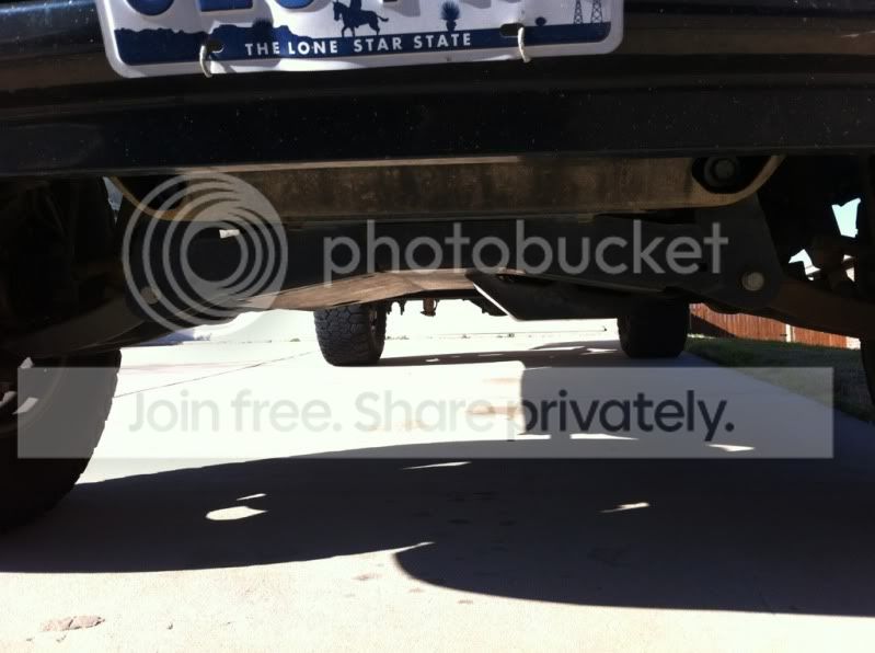

I used a superlift F.I.T lift kit on my 01 gmc. Im running 305/70/18 dick cepeks.
I chose that kit because of the ground clearance and skid plate that is included I haven't had any problems with it and Ive had it on for close to five years. The other kit I would recommend is a rancho kit they advertise it as a 4in but if you measure there drop brackets its the same as every other kit out there.

The first pic is my 05 2500HD with 37/13.5/17's
The second pic is with 35/12.5/17's
It's a CST lift with 5 inch blocks in the rear and whatever they use for front lift. The CV shafts are at the proper angle.
By dropping 2 inches on tires and an inch on width I gained 3mpg also rides a bunch better.
For a DD I wouldn't go higher than 35's you will get tired of climbing in and out of it.
Also they trimmed my front inner fenders to fit the 37's and they still rubbed. So you would have to go higher.
