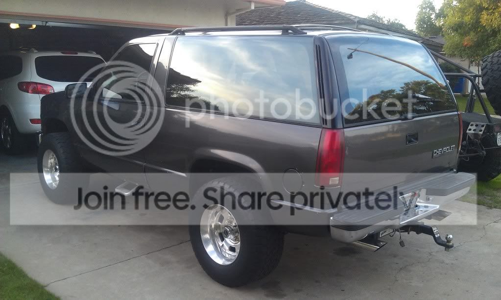

Its 3.73 now and i want 4.10s to match my 9.5 14SF with 4.10s, thats waiting to go in, It has. 32ish metric tires,
sounds wierd, but we are always hauling tons of weight and the extra gear would help

the most common parts on these trucks that cause issues with aligning it are the idler/pitman arms. As has been said before, anything worn out needs replaced, but my bet is that those are the two worst culprits. My 93 was the same. I did the idler and pitman and it helped a ton. It's just a poor steering design to begin with. Everything is pretty straight forward though. Drop the front skid, and go to town:waytogo:
What brand lift?
Depending on the lift and the vintage of the lift you could have all kinds of issues there. The multipiece subframe ones like to rattle apart, the ones with aftermarket control arms tend to not align well, the ones that relocate the steering down cause all manner of weird steering issues, etc etc etc.
Twelve or so years ago a friend had a '94 or so Blazer K1500 and had a ProComp 6" on it. The thing rattled apart on him many, many times. Finally he had his mechanic weld all the subframe pieces together after basically rebuilding the front end. Still wasn't perfect but it held together.
Yeah it does. If they're shot it'll let the tire flop in and out.

What brand lift?
Trail master lift...Pretty old lift, been on there since about 2001.
Multipiece bolt together subframe? Brackets that drop the upper control arms?
Steering drop components?

I know that the upper Control arms are aftermarket, But I will take some pics today and show you whats going on under there.
Ugh. Oy man. You've got basically THE lift kit setup for those trucks that caused most of the lift makers to change how they lifted those IFS trucks in the late 90's.
I have a sneaking suspicion everything is rattling loose and your steering components have worn. You're going to have a lot of stuff to tighten up, replace, and/or get in the correct locations.
Is that as simple as tighting re-tourquing the loose brackets along with replacing the wear items, Or will something else be required?
I know with my buddy's ProComp it was basically like reinstalling the lift kit. Everything has to be in alignment and torqued down just right to even start building from there correctly with the steering and such.
