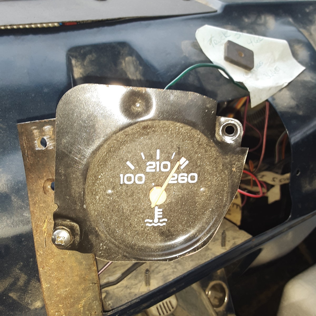

I'm guessing the stock water temp gauge isn't reliable?

I'm guessing the stock temperature sending unit is not very accurate? I just put dual electric fans on my 88 and they weren't coming on until the factory dash gauge read almost 260.
Using an infrared gun the thermostat housing wasn't getting hot enough to turn the fans on at 195 degrees until the factory gauge was showing just before 260 and then they would turn off at around 185 degrees which is where it is supposed to, and the gauge was showing just under 210.
Is it worth getting and using a new sender or should I just buy an autometer water temp gauge and run it to the same spot in the head?

Well that is odd. I let it idle on the driveway for a good 20 minutes and it would go like clockwork. The fans come on at 255 on the dash gauge then off at 180-ish over and over. When the fans come on, it cools it pretty quickly. I kept checking temps at the thermostat housing and exhaust manifold to make sure temps were correct. Now I have to figure out what the smell coming from the exhaust is. I'm praying it isn't coolant.

The factory gauge is reading 255 but the temp at the t-stat housing is showing 188 roughly. The fans are set to come on at 195 and off at 185. I put a 195 thermostat in.

There is generally nothing wrong with the factory gauges. Not by design. You are talking ~30 years, things happen. Bad connections, failed resistor, corroded wiring, bad sender, etc. Even at this age, a failed gauge is uncommon.
Below is a pic of a well used gauge that's the same vintage, displaying the oil temp in the engine sump, this winter. Seems reasonable to me given the conditons. My factory coolant temp gauge is within 10* of the temp shown by the ECM at the same location in the intake.
I'd figure out why the swing. Nowhere in the engine should you see that much swing with properly functioning components no matter where measured.
