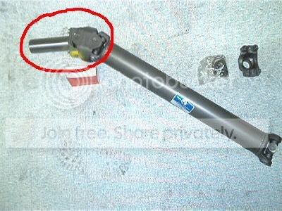

so i need one of these purdy shafts....
does anybody know if they can convert mine over or if i need to have a whole brand new one made. better yet i heard some old caddys or something had a TH400 with the same output as the NP208 and all you have to do is have it lengthened and the bottom yoke welded on. im gonna try to find that post, it's buried deep im sure...let the searching begin...
yuppers, thats the one i had for a while, its 1350 too. you can also take the other end and use it for the cv on the front shaft if im not misteken. ive had mine totally rebuilt since then so all i have left is the outer thingy. the slip though is only like half spline so when you take it to get it lenghtened ask them about a full spline slip.
if you can purchase whats circled in red separately then a driveline shop should be able to cut down your old shaft and weld it on

I sourced a drive shaft from a '76 Caddy Fleetwood for when I have my CV shaft made. It has the same spline count as the rear output on my NP241. Not sure if Olds or Pontiacs have the same arrangement.
not a good example but you get the idea what to look for.
