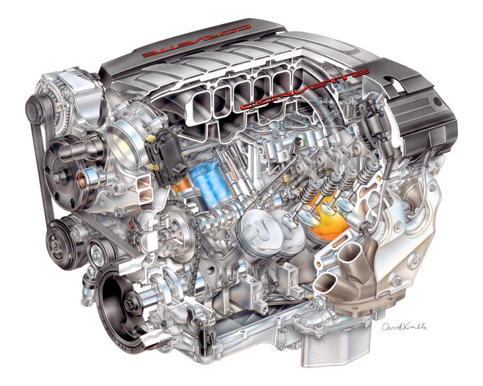

well, since im LS-iterate, would somebody mind explaining all this? I hear LT1 and i think optispark, lots of compression, and reverse flow cooling...
top of something in the first photo is definitely not LT1. whats the "T" for? truck? this a different style intake or completely different motor? and what gives it away?
The new “LT” is the next generation. It is a direct injected engine. There are many versions like the lt1, and supercharged lt4. The truck versions are called L83 and L86.
5.3 and 6.2 respectively. I notice them right away because I have installed a few in my buddies rides and my neighbor owns a swap shop that does them.
ah ha. didnt realize the new direct injection motors were common in the LS type engines already. I heard (year or two back) about one of the engines going into new camaro or new corvette being branded LT1 again? or did i dream that?
