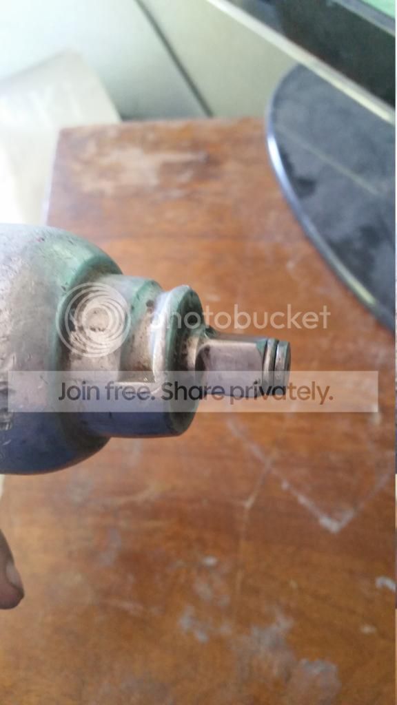

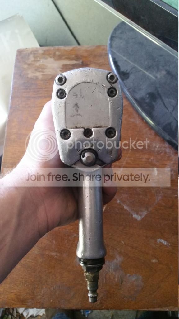

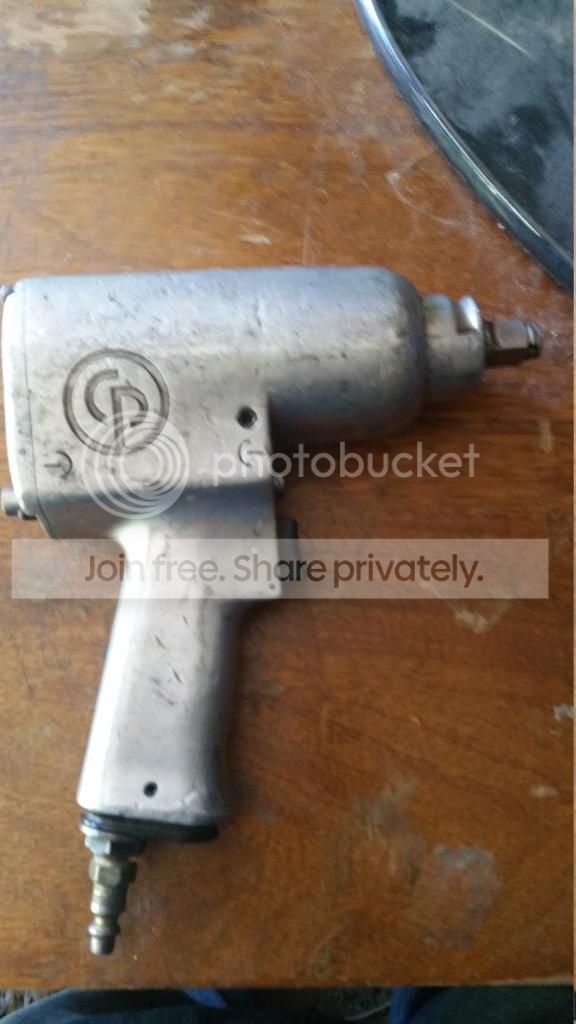

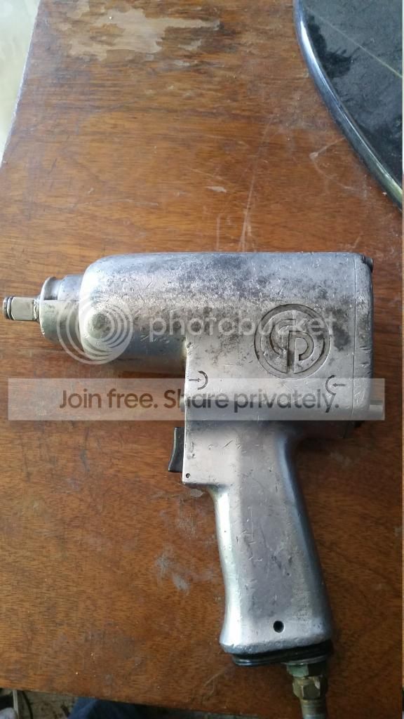

Found this at a garage sale yesterday for $1. It was frozen up but for a dollar I thought I'd give it a shot.
I sprayed kroil in it when I got home and let it sit overnight. Then today I hooked it up to air and twisted the part where the socket goes on (anvil?) With a wrench and it broke free. It works but has no real power.
so how hard is it to rebuild these? Is it worth rebuilding? anything I should know before cracking the case open?
And anyone have any idea on a model number? Looks like it had a label on top at one time nothing but residue left now

Yep, Chicago Pneumatic. One of the cheaper brands. Odds are the vanes are stuck. They are supposed to fly out and seal when the motor spins. If you go into it, remove them carefully, clean them well, and put them back in with a small amount of lube.
Otherwise, spray some solvent like WD-40 or the Kroil in it, and let it run at max speed with no load to see if the vanes loosen up.
I took it apart last night and some of the vanes were stuck. I got them all out and cleaned them. Nothing looks worn out of damaged so I'm not gonna worry about a rebuild. Didn't get to test it last night but I will tonight. Was only getting about 30 ft pounds before
