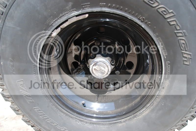

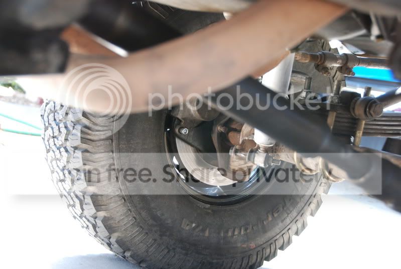

I swapped a d44 and 14bff. The d44 had the big external hubs, and one had a busted dial and was banged up so I threw on some mile marker 423 hubs.
I went with 15x10 rims with 4.25 backspacing. I used the Blackbird backing plates to avoid trimming my plates. Still had to smooth out the calipers though. Decided to throw a Powertrax No-Slip in the back.

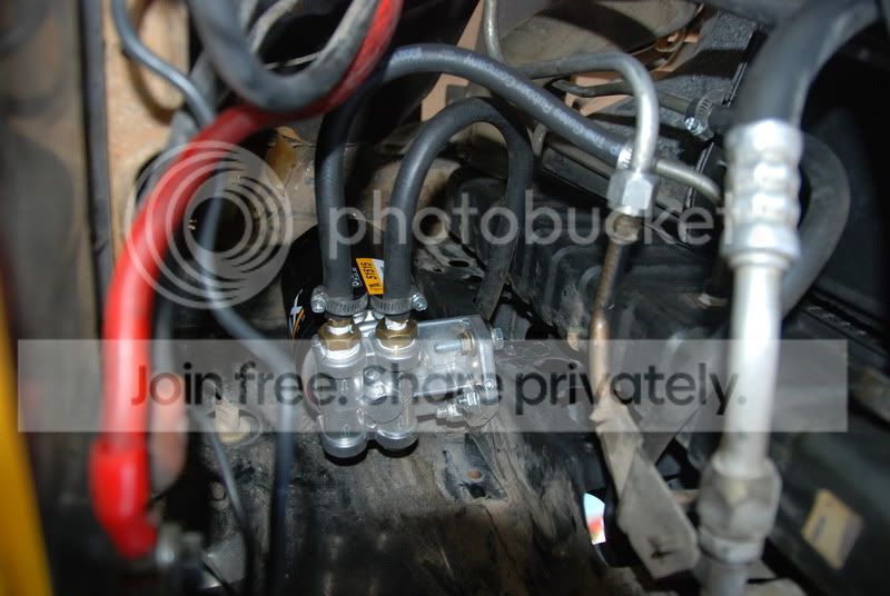

I also added a tranny filter and cooler. The temps from the high pressure port dropped from 210 to 165!

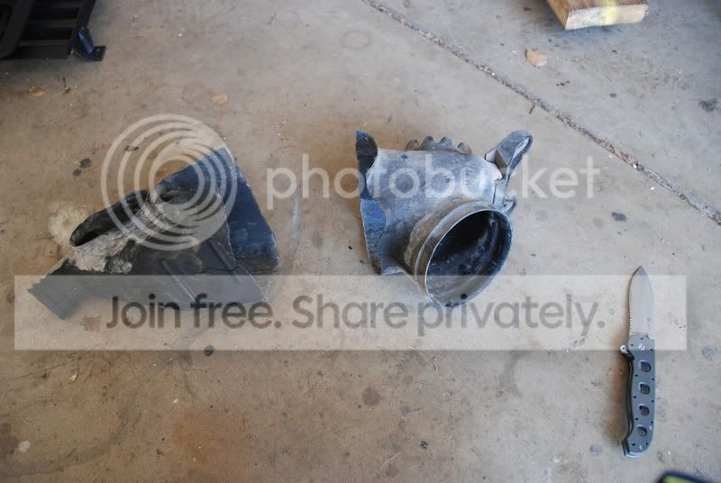

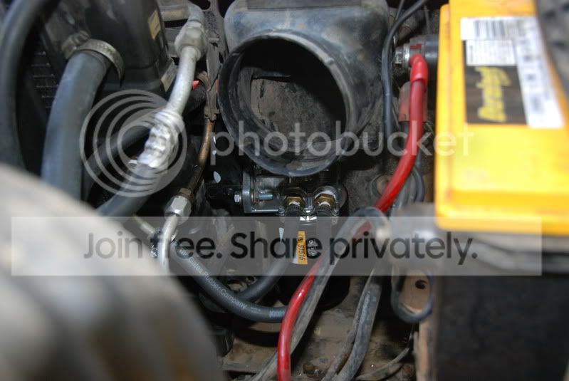

Here is where I mounted the filter...had to cut the air box thing. The filter is bolted to the core support. I cut the return line out of the rad and put the filter after the rad cooler, then it goes to the cooler, then back to the return line. I chose this location to keep the rubber lines short.

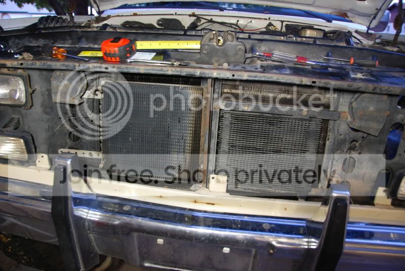

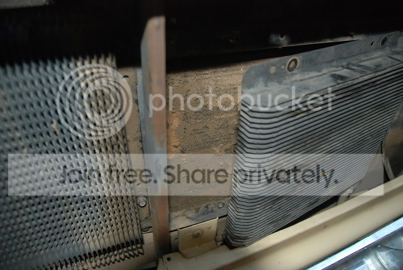

Look what I found behind the oil cooler...bunch of dry mud! Cleaned it, now my A/C blows a little cooler.
My tranny cooler was a jy find, and the damn thing leaked under pressure...so I bought a similar sized one from autozone for $60 p/n 911679 (no pic)
