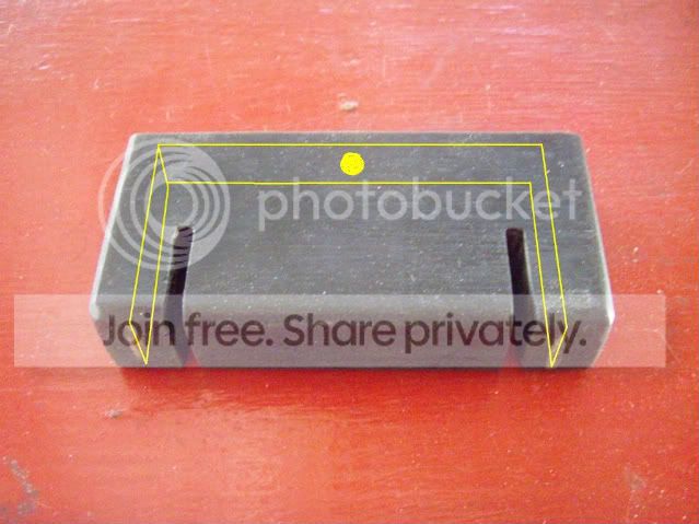

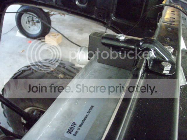

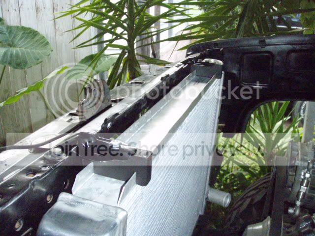

first i made these

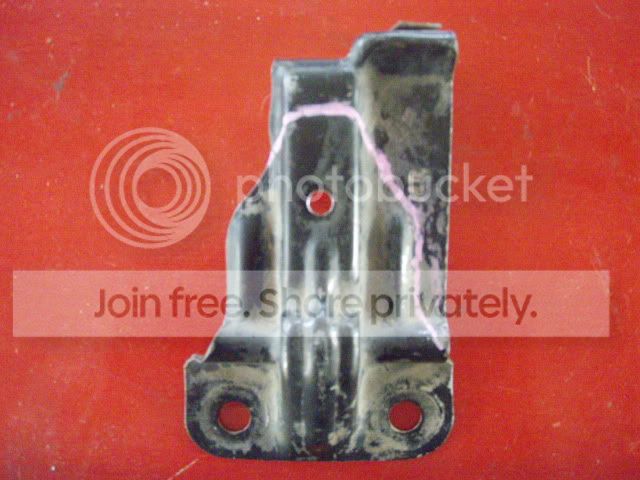

then i cut the stock brackets

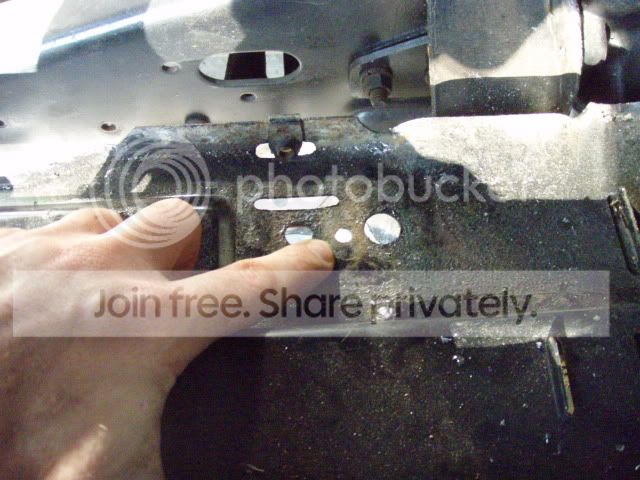

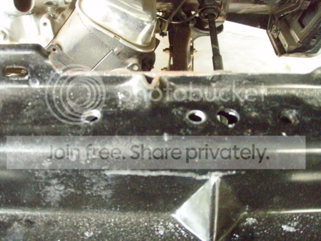

after that drill a couple holes at the bottom of the core support
then some on the top.

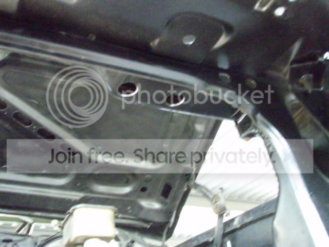

i also trimmed the lip off the top.
then some underneath to get to the nuts

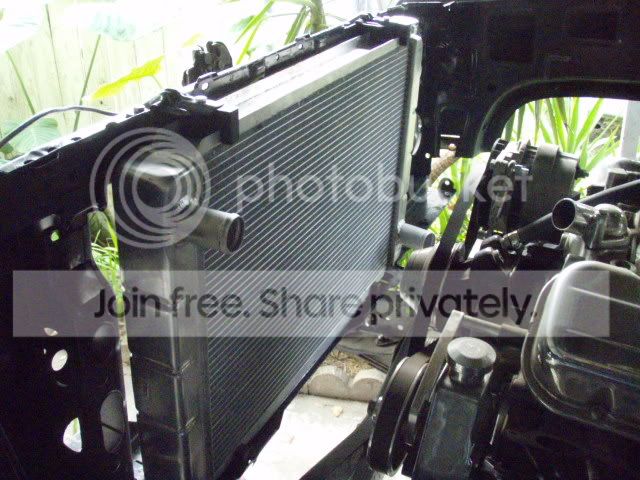

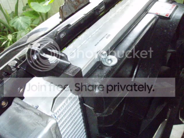

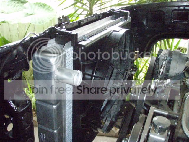

some lock-tite and DONE! very snug.
i know i just posted this last week but i need to add it and some other stuff to my build thread. bare with me. theres more comming.

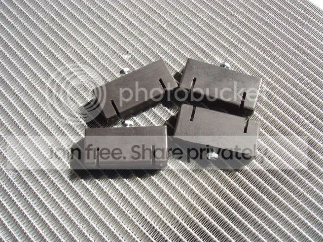

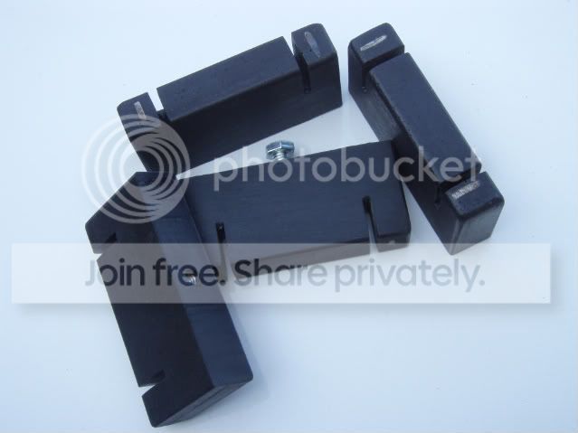

its rubber i molded around metal. then i tapped out for a 1/4 bolt. like this.
Very nice....if our rads weren`t different, I`d have ya pour me a set of those mounts :D

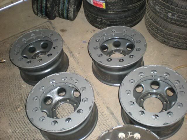

i did manage to scrape together the money for a set of these.
havent got them yet. mine are going to be powder coated black with half rock rings.
