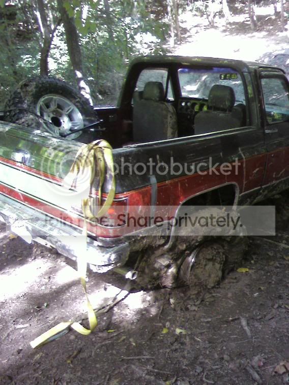

then the same day those pics were taken, the night wheeling kicked my butt

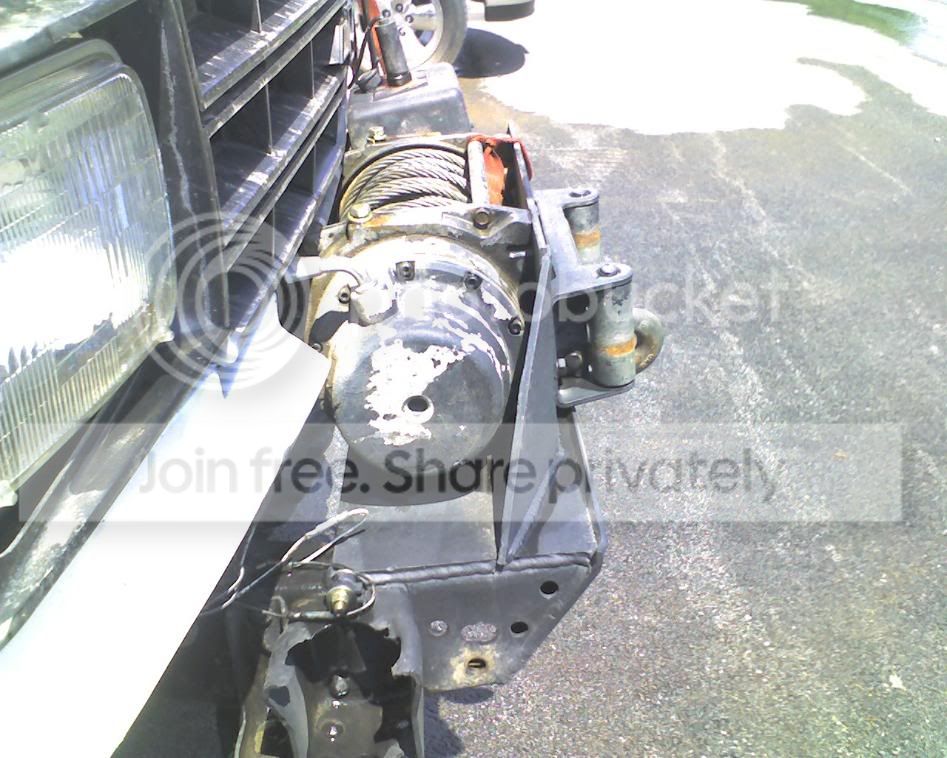

12,000lb Warn whinch

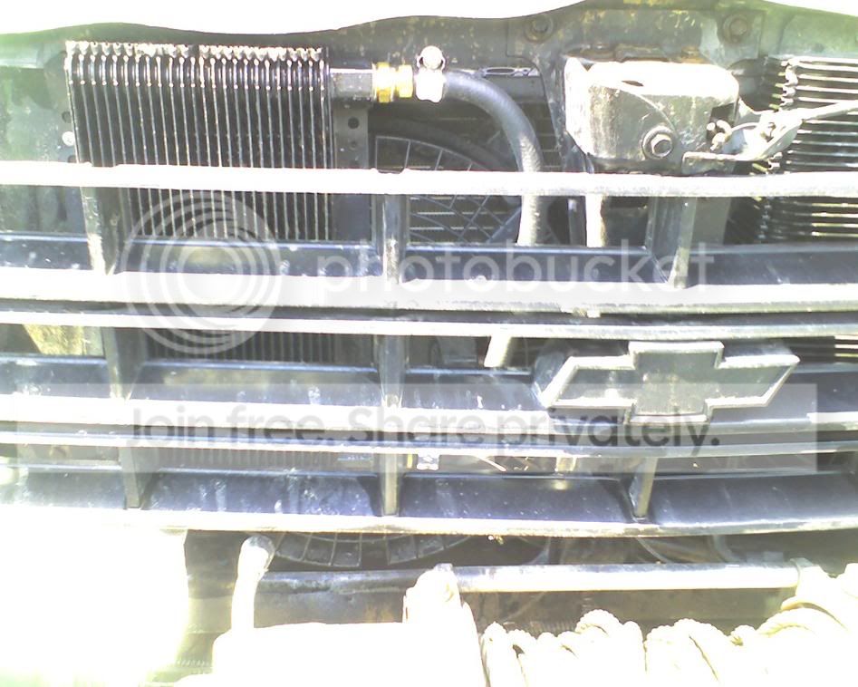

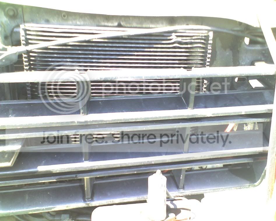

aluminum 350 conversion radiator
dual nissan 10 inch electric fans

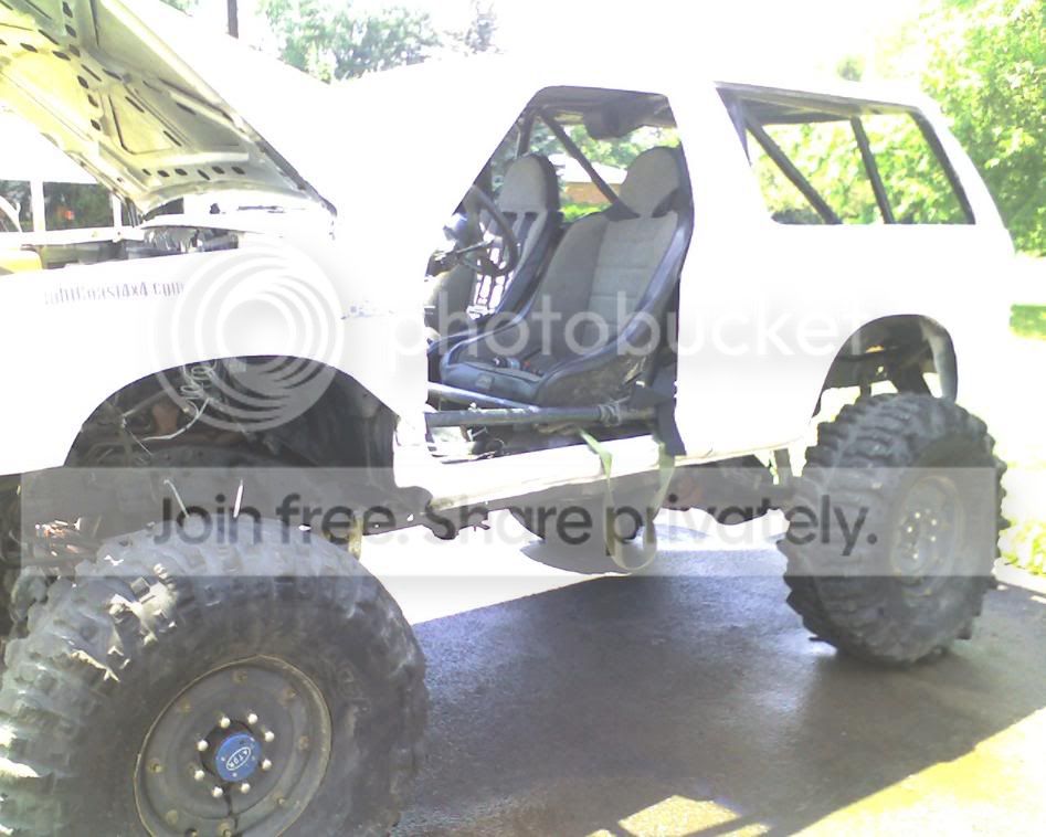

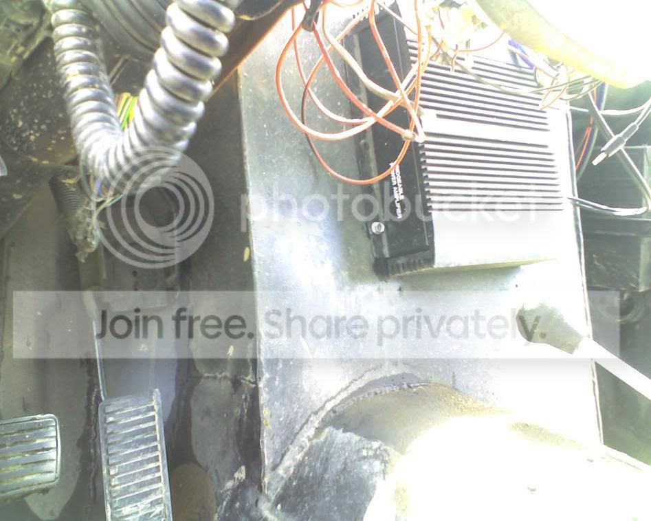

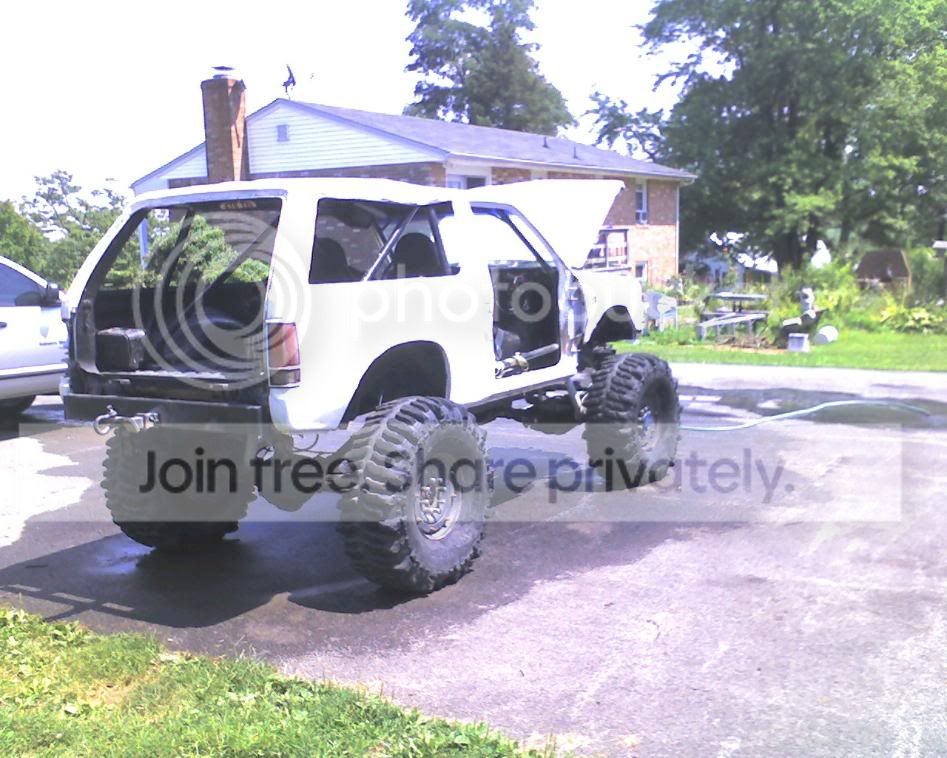

Moved the fire wall back about 6 inch's to make room for the stock 350 motor, then cut the floor out behind the seats to allow the cab to sit down around the frame. Welded in a piece of plate and then built a cage for the fuel cell to sit on. here are some pics of what was done and how it sits now.

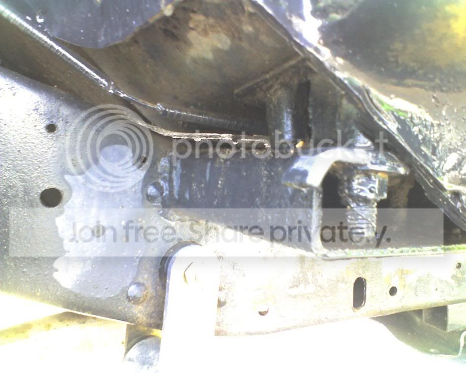

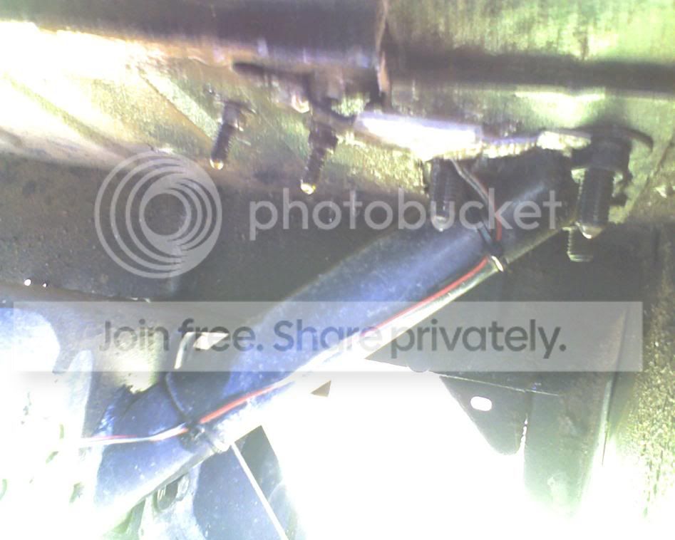

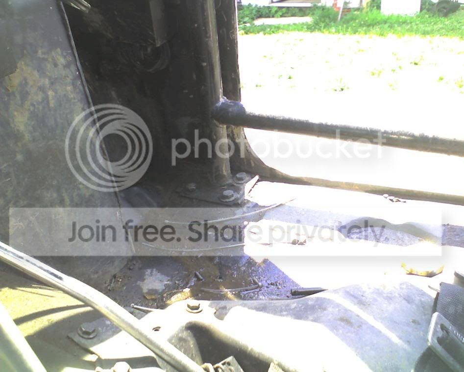

Removed the dash to allow room for the cage to be snug agasint the firewall. We used Jeep spring plates as the cage base, then we sandwiched the chasi between the frame mounts and cage mounts.

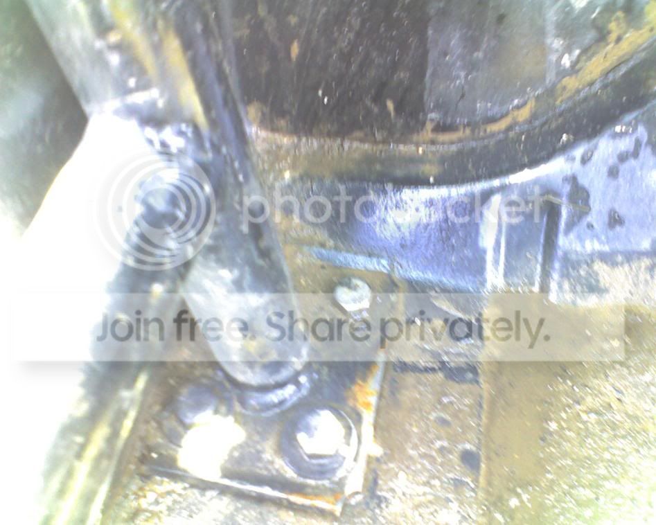

This is the front cab mount, pretty simple.

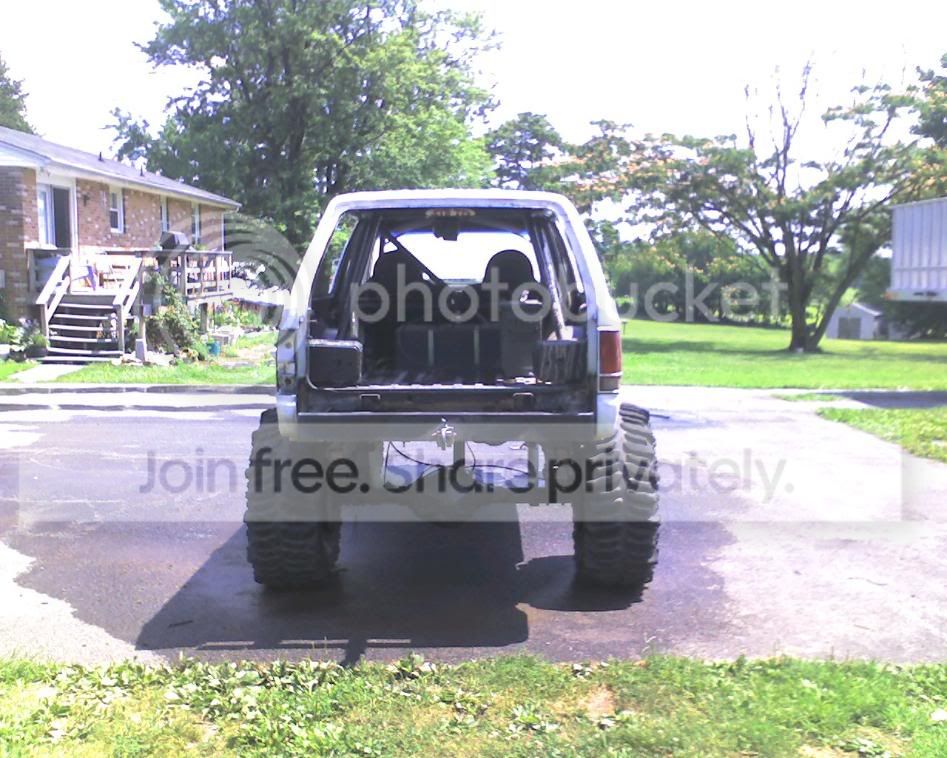

The rear cab mounts

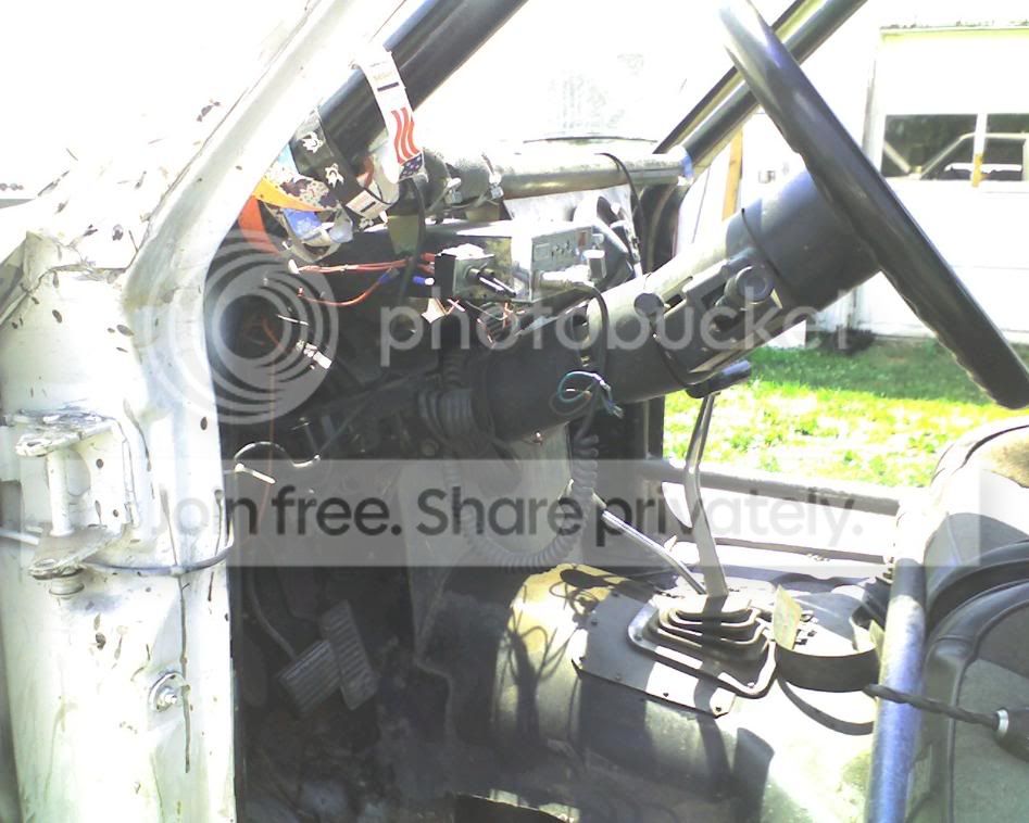

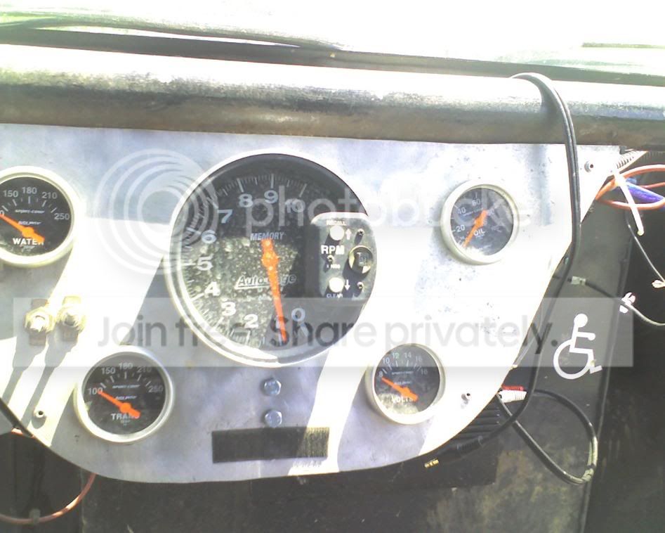

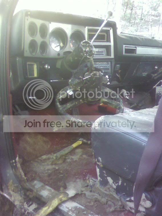

The gauge cluster we made using accutemp guages. i have oil temp, trans temp, water temp, tach, voltage and oil pressure
you can see here how the firewall sits back, this allows the motor to fit while centering the wheel wells.

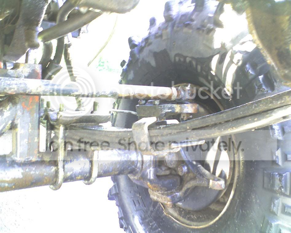

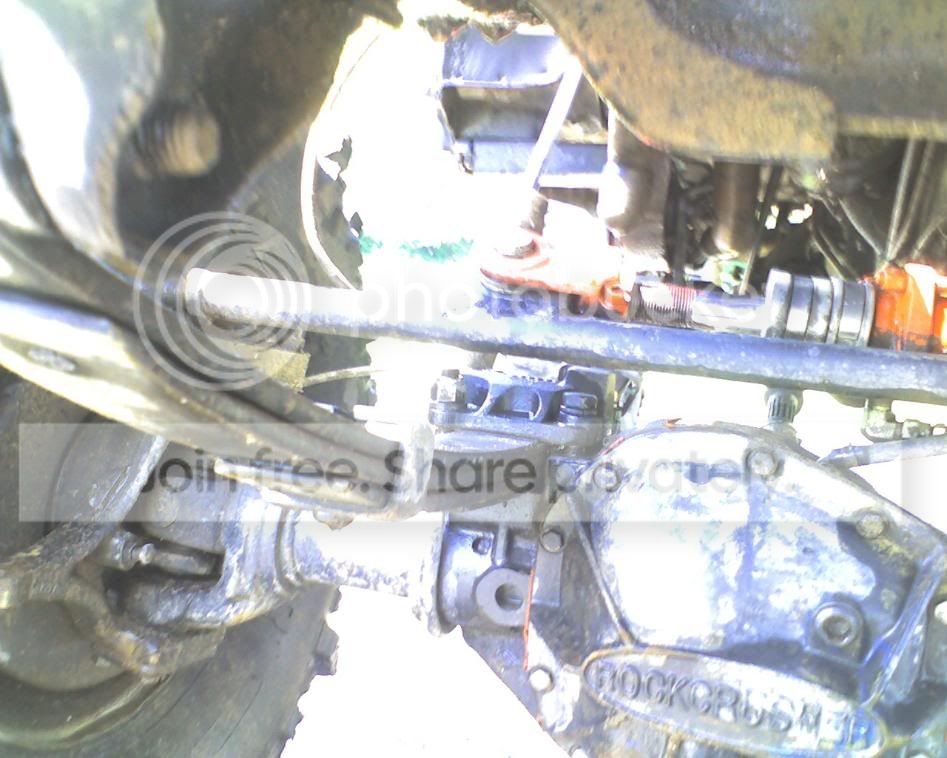

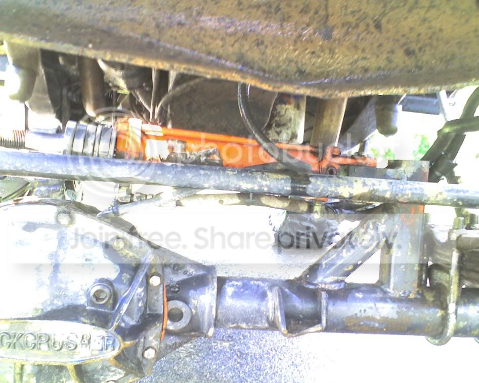

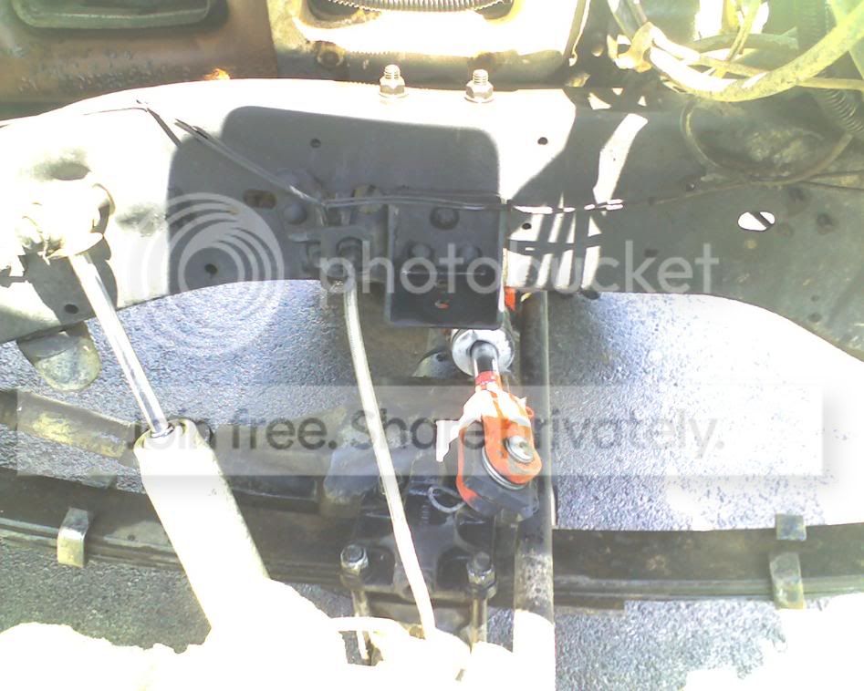

this is my crappy hydro steer. this works, but its not a great setup. This is a howell orbital, with a tractor supply ram running off of a stock gm pump. Im using an inline trans cooler to cool this puppy as well. the ram is a 8 inch stroke with a 2 1/2inch bore.

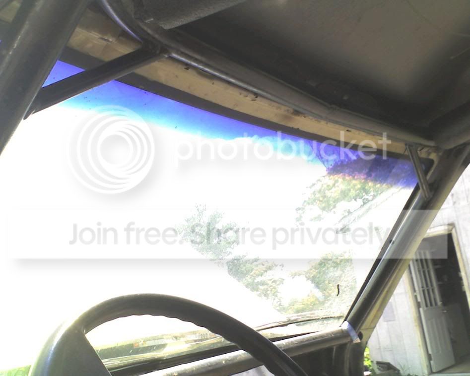

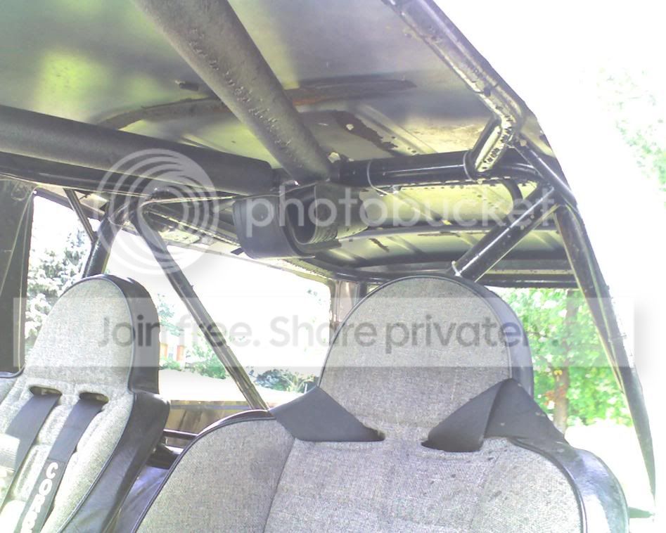

Full cage with a halo, looks great and works well. Once the body is trashed it wont take much to buggy it.
