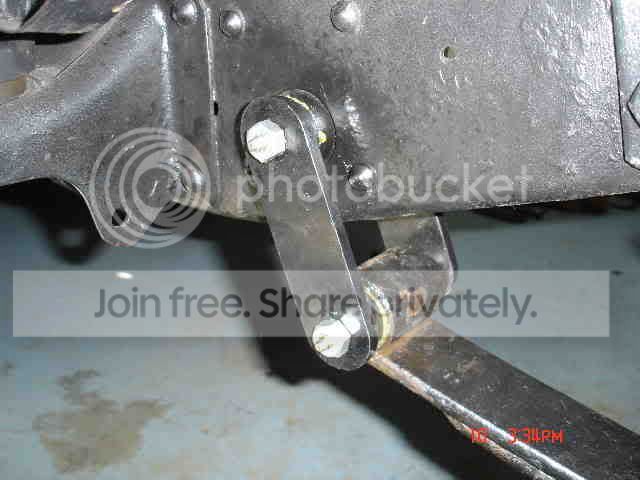

Here they are, $15 per pair

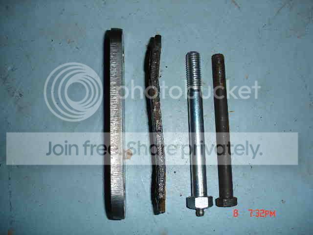

My front shackles bent exactly like your describing. All 4 front shackles were bent in the "s" and I upgraded with the diy4x shackles and offroaddesigns bushings and greaseable 1/2" bolts. Here are some pics.
I have never seen teh DIY4x ones in person. I just made my own when I moved the upper shackle mount...
That said. If you can't make them yourself you should definately get them from Kert. Cheap and bulletproof. What else could you ask for

Yes you have I run the 6" and I have a set of 4" in the garage:D. The set I have is setup for 9/16" bolts so they would not work for your application without changing some things on your rig. The factory bolt is 7/16" and ORD upgrades to a 1/2" greasable which is what I run currently.
