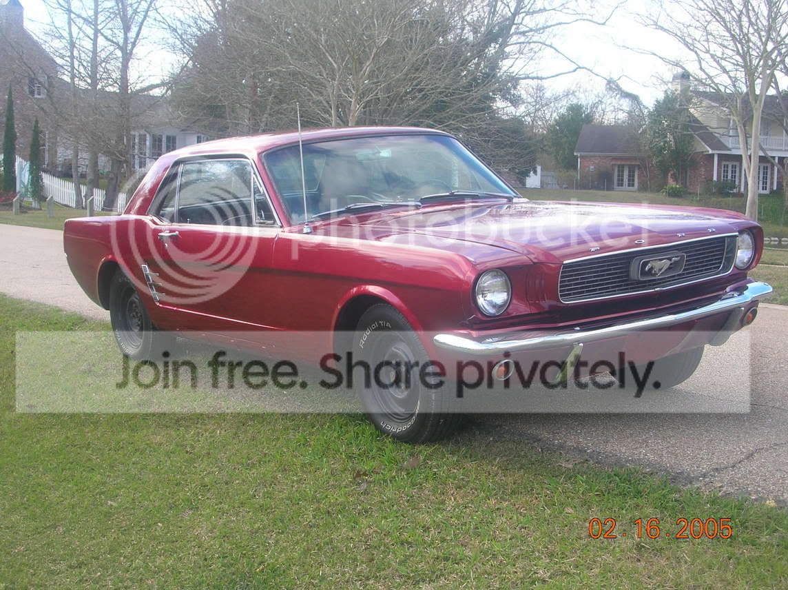

I have a straight 6 200 CI in a 66 mustang and love that thing. I put a mild cam and a header in it and it'll scoot. I then put in a T-5 transmission and that combo works even better. With the inline 6, T-5 transmission, and 3.20 gears I get 26 MPG and cruise the interstate at 70-75 with no problem. One of the best things I've done to this car is to not put a V8 into it.
