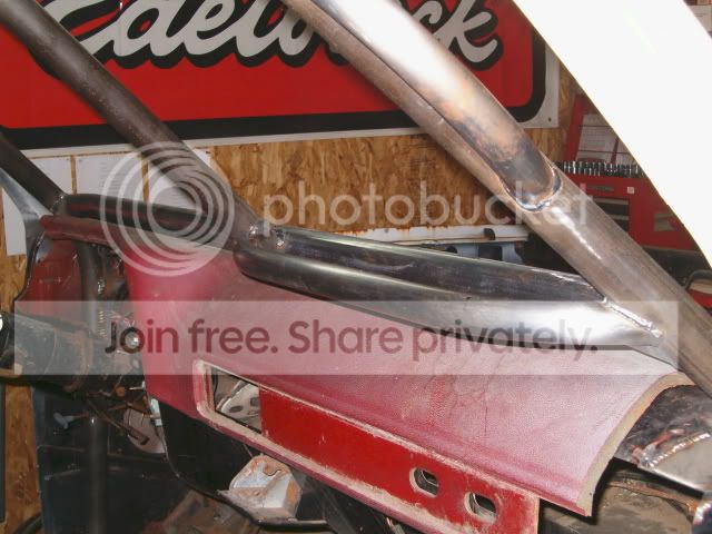

Mitch, I believe you could add a grab bar to the A pillar without much problem. You would have to sculpt it to fit the pillar, but it could be done. I added one to the cage in my truck and its GREAT for getting in the truck. Also ran a bar across the dash to put a grab bar on too:
