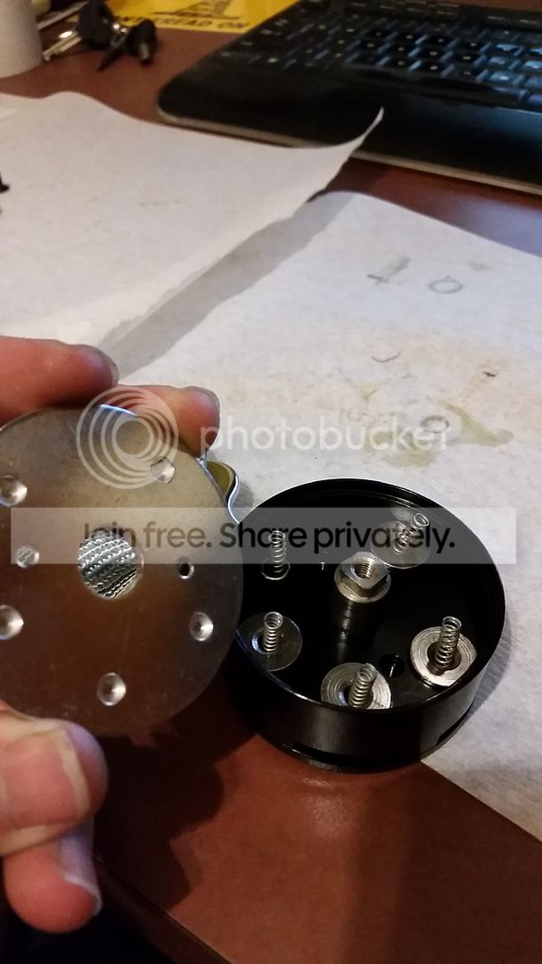

One pin is "floating" while the other 4 are controlled by the camlock. I pulled apart both sides of the first camlock, which I found wasn't necessary. Pulling just the "dial" side apart was enough to change the stationary or "floating" pin location.

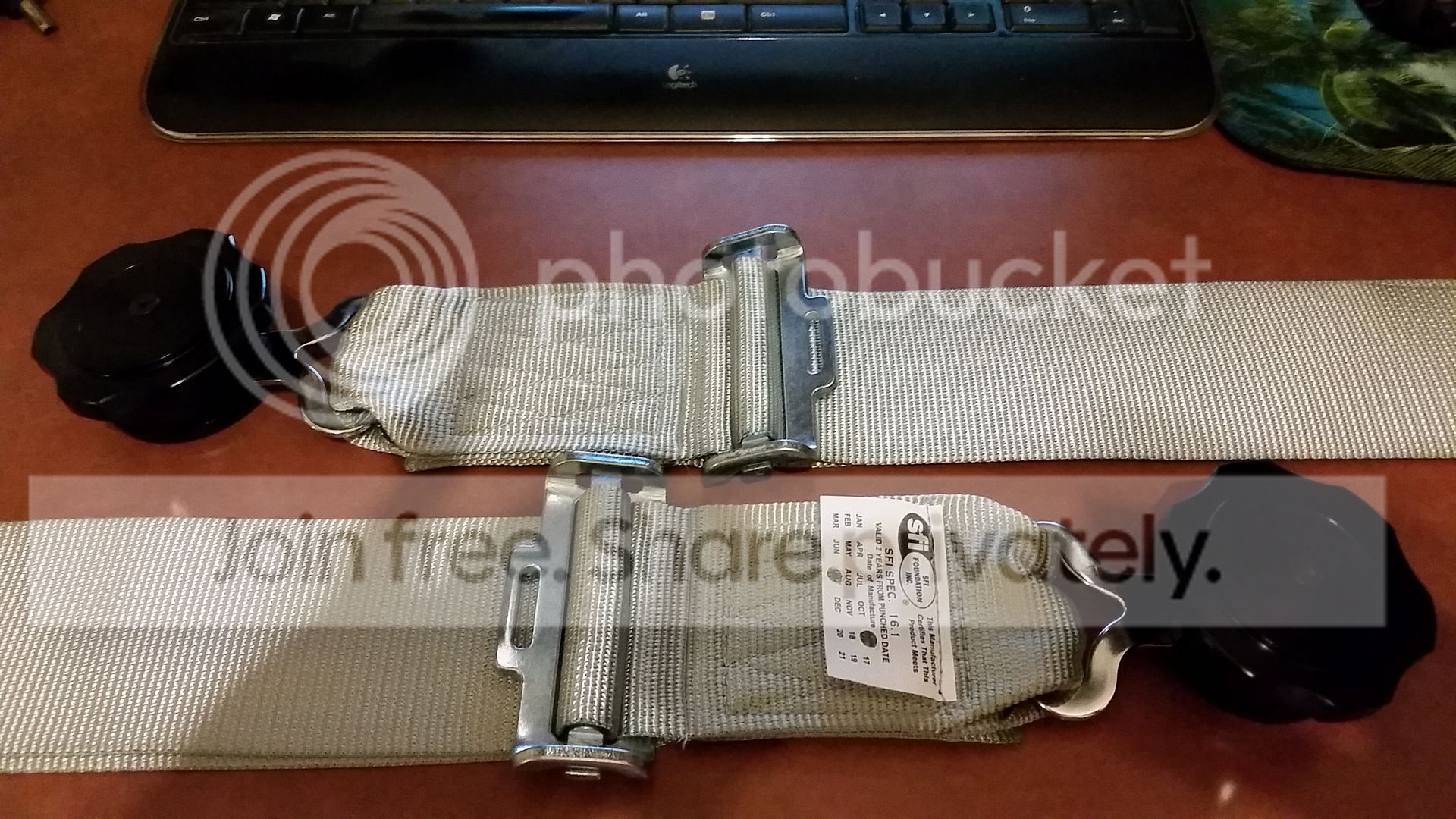

Crotch strap on left. New location for driver on right.
Cam upper right, screws and springs, cover, dial, pins, all disassembled.
Just remove top cover, located under the dial, and swap pin locations.

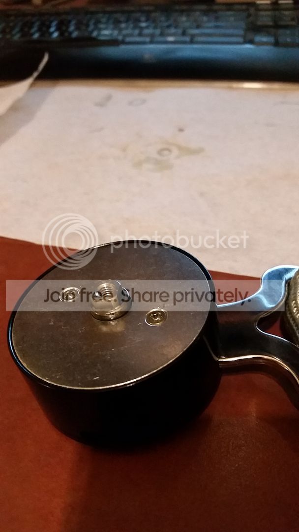

Back together. You can see the "keyed square" that goes in the dial.
Inner strap is now stationary :D
