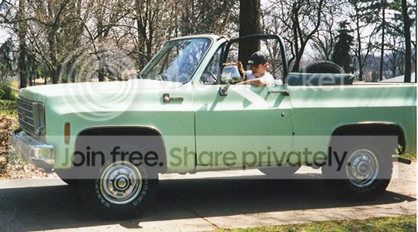

This is my first Blazer, a '75 K5 I found locally and bought just out of high school. The first picture is just after I bought it. The highlighted section is the part I should have paid more attention to...

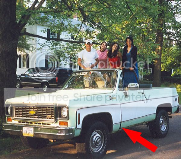

Then I removed the top and it only got worse...

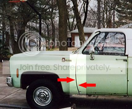

Until it got to the point where it seriously disrupted my once-decent body lines...
Make sure you check that area on any Blazer you look at. If the rocker boxes are rotted out (like mine were), the body flexes right there. There's a body mount bushing right there behind where the fender and door meet, make sure you check it and the surrounding metal to make sure it's all there, too.
Needless to say I had to lift up on the door as I shut it or it wouldn't line up or shut all the way. I eventually just removed the doors and just drove around town doorless for a whole summer. Wish I had some pics of that...
Uh oh... mine does that, the first pic that is. I think there might be a gap all the way down tho not just the bottom
Yeah :whistle: mine does the sam thing except mine is probally worse I thought for sure that my frame was broke when took the top off how hard are the rocker boxes to replace since I know anything with rocker on it on my truck is gone or very rotted like the 15 inches of rocker panel that was gone on my drivers side that has been replace with some sheet metal well at least now I know whats wrong.

My door has a big gap all the way up the door, it doesnt slant in (a little but not really). There isnt much rust on my truck (surpriosing for being 30 yrs old) so I'm not worried about it
