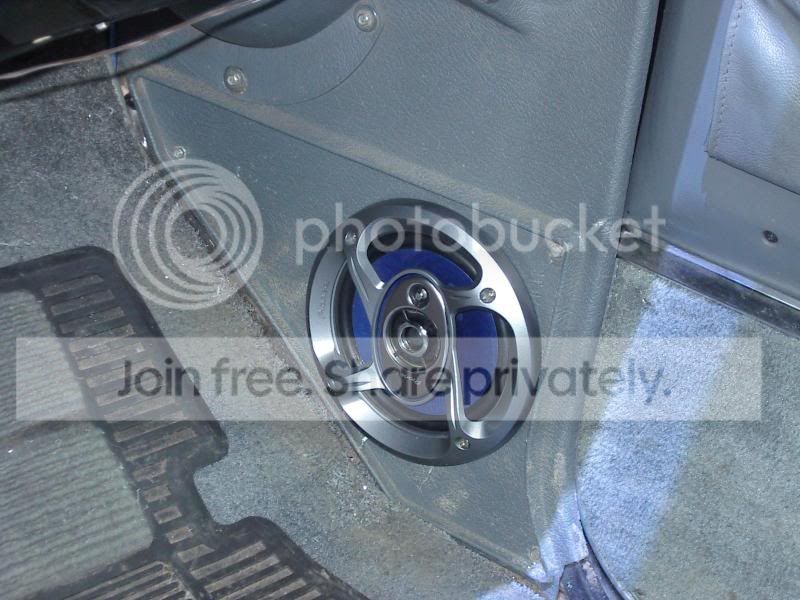

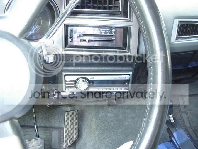

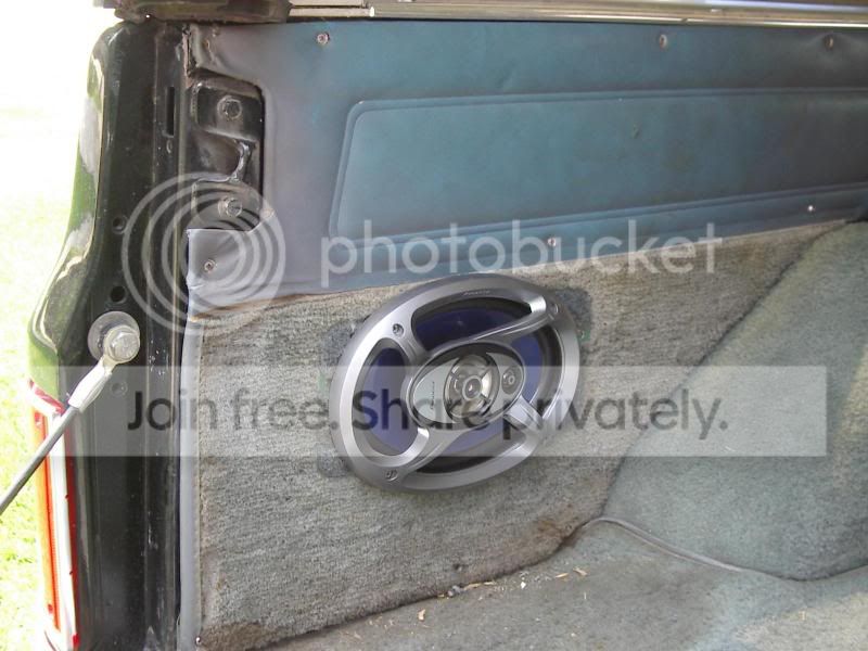

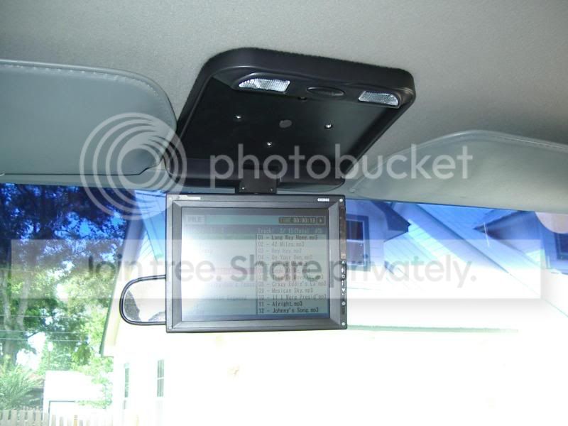

I just got doing mine this week i put in a 8 inch flip down screen dvd/radio deck and 4 new kick ass speakers. I will tell you one thing i will never do it again. Putting the tv and rear speakers were fine but the radio and front speaker pain in the ass. I bought an adapter kit for the radio but it only works for a 87 and up blazer they dont make one for 86 and earlier so i had to cut the dash then modifie the adapter kit to work. then the front speakers were 6 inch rounds that i was going to put in the bottom of the door but they wouldnt fit cause of the dam power windows so i had to put them in the front kicker panels and that waz a pain. right were i cut the hole there was a f****** body beam so i had to move it over more and that sheet metal isnt to easy to cut either. but it turned out pretty good. just have to clean up the dash some kind of cut alittle to much:doah:. But it turned out realy good love the sound so clear. if you get speakers go with Pioner best sound and clear to. i love my new radio just took me roughly 15 hours of work:doah:. il go take some pic to show you wut i did
