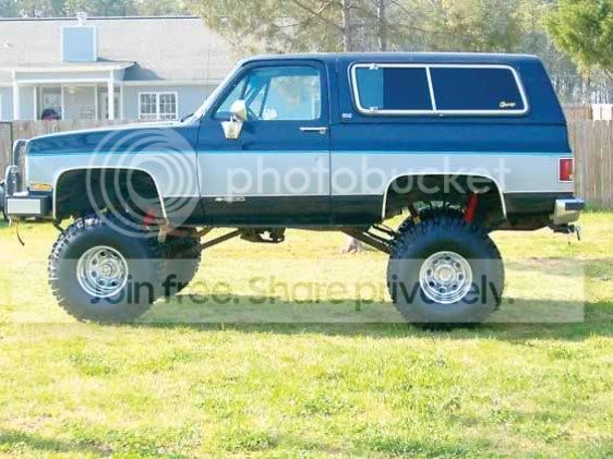

I found this 1990 k5 for $6500. It's got 38's with 10 inches of lift. If I get it, do I have to tell my insurance company that it's heavely lifted? What if it gets stolen or totaled.. will they pay me book value or true value? It's probably worth nothing on paper.
Anybody with good experience dealing with the insurance company and a heavely modded truck?
Thank you for any help.
Also if you could give some pointers in what to look for on these trucks. I'm mechanicaly inclined but sometimes it's good to get the perspective of people who have owned what you are shopping for.
Anyway here is the ad.
1990 CHEVROLET BLAZER, 165K mi, abs, ac, ps, cc, tilt, p/windows, tint, 10" liftkit, 5.7 V8, Cold air, 38" TSL bogger tires on 15X14 wheels 5.13 gears. trades poss, $6,500

Hard to tell from a photo, check the tailgate make sure everything functions, crawl under it check for rust, drive it in 4wd, look for leaks...

I might be weary of that truck . He has 5.13's in it and when I zoomed in they are 6 lug. Those bogger's will give you problem's real fast if you arn't super careful.
What's wrong with 5.13's and 6 lug ?
And I would not be doing any extreme off roading with it, no mud bodding either. The truck would be used 90% on the road and 10% doing light to medium offroading.

imho, less lift is better. 6" maybe. steeper driveline angles of tall lifts put a lot of extra strain on bearings, etc. check the pinion seals. also, there's the obvious issue of COG offroad.
i'm not one of those "everything but 14bff is crap" guys, but i think 38s and deep gears will be pretty hard on those 10bolts (the axle shafts, mostly).
make sure to check the engine for the usual. pull a plug or two and read it. look for excessive oil leaks. is the oil on the dipstick burned (bad rings, etc), is it milky (bad head gasket). shove a paperclip in the ALDL to check for codes, both before and after you test drive it. obd1 codes are easy to clear (disconnect battery), so just checking before won't catch what he's erased prior to you driving it.
