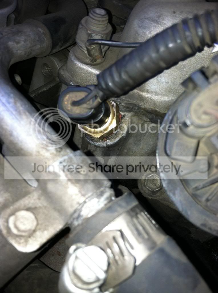

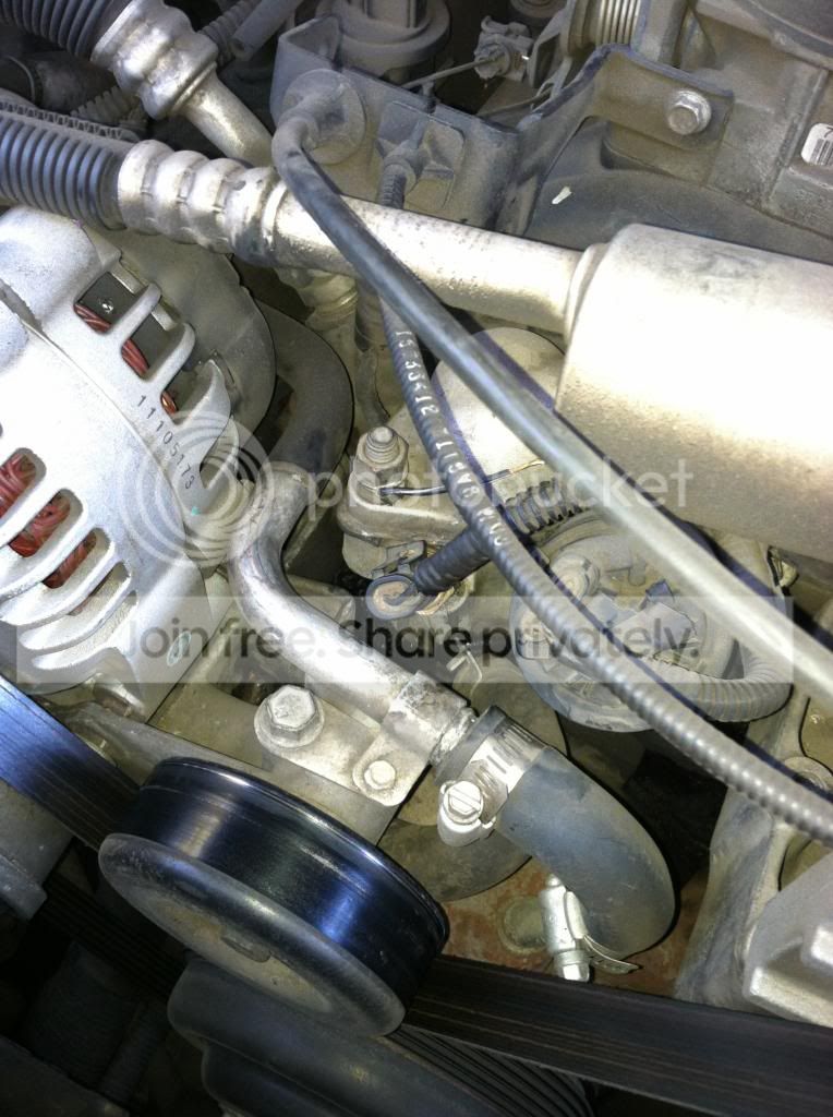

Have another problem on my burb I was replacing my temp switch and noticed a leak after further inspection noticed a hair line crack on intake under temp switch pics are at bottom. What do you guys recommend is there a way to seal it or should I just go to pick part and get another intake and just replace it.thanks guys
Get the felpro intake gasket set. This is a VERY common issue on the vortec trucks. Take a day and tear it down, clean it up and replace the gaskets.
Yeah you can see the hair line crack to the right of the temp switch has tear drop leak.
