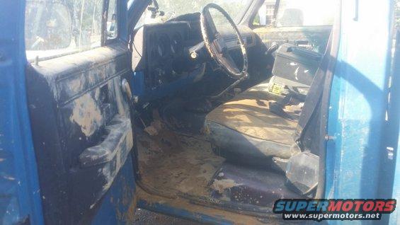

Working a little on my '89 today. The PO pulled out all the carpet and left the insulation/plastic/tar whatever stuff that was under it.
My plan is to cut the top off in 73-75 style and add a canvas top.
I am concerned that this mat will get wet. Rhino lining sounds good in some ways but what about noise?
So far I have not seen any rust in the floors and don't want to encourage any either, what have y'all put on the floors?

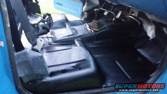

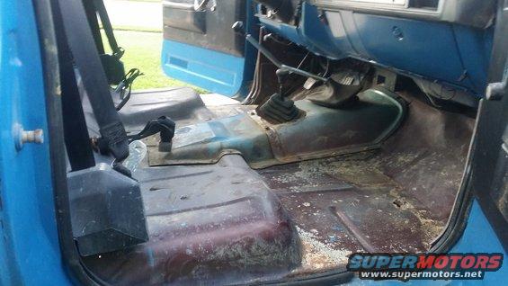

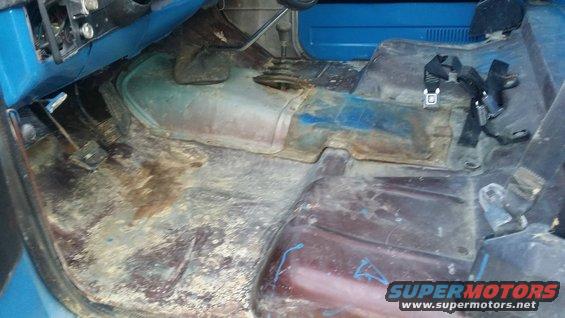

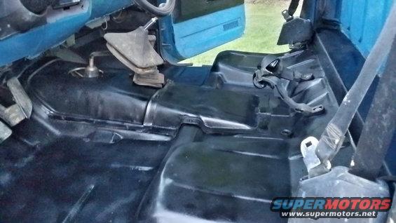

Here’s my low buck adventure:
I wanted to ditch the sponge-like characteristics of the stock carpet and jute liner. I pulled them out. I was greeted by a floor that didn’t need too much repair, thankfully.
First I addressed the rust holes. A few holes here and there. A sheet of 20 gauge steel and some 3/16” steel rivets, and those were dealt with. I lack welding skills and don’t like to ask people for help as you probably know, so that was my solution. Materials cost about $20 right there. Took some super fancy rubberized coating spray— the most expensive part of this so far— and covered the steel patches top and bottom. Sealed all the edges with polyurethane caulk. Day one.
Wow I’ve had a few drinks and I can feel it when I’m typing this! Bear with me!
Next up was removing surface rust. Sanded those spots with 80, 180, then 220 grit by hand. Covered with Rustoleum Rust Reformer, two coats. That was day two. Total spent so far about $45 including sandpaper since I didn’t have enough on hand.
I then laid down two coats of the super fancy rubberized stuff. Took a day to let each layer dry. Topped that with two coats of Rustoleum bed liner. I tried to cheat by using spray cans but found they had to be shaken almost constantly. Pain in the ass. Switched to brush-on formula. Waited two days for the first coat to dry. Then three days on the second coat. Total cost now about $65.
Today I should be done with the floor. I expected to be. I hadn’t driven my Blazer in two weeks because I was working on the floor. The darn bed liner stinks like crazy and has already chipped in a couple small spots. I didn’t put any cargo back onto it and I stepped into the truck carefully. Now I’m wondering if I went too cheaply on this project by using that bed liner, or should I maybe make the final outer layer be the fancy rubberized stuff? The guy who recommended it to me says he’s left tractor floors coated with it and it’s held up for years. But silly me read online and saw many people putting the bed liner on top of rubberized stuff for floors, so I thought it was a good idea.
Thoughts?
