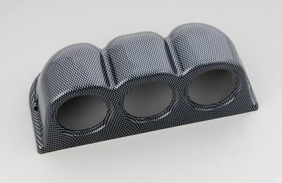

Some other options are from autometer. They actually have other dash pods. There is a 3 gauge pod that is for Dodge trucks that could be made to fit. The plastic in the pod is sandable and filable, so its easy to handfit. Jus check summit for dash pods.
I jus seen this on SUmmit Racing website, It wasnt on there b4, I may have gotten this one
Here is the dodge one from Summit
