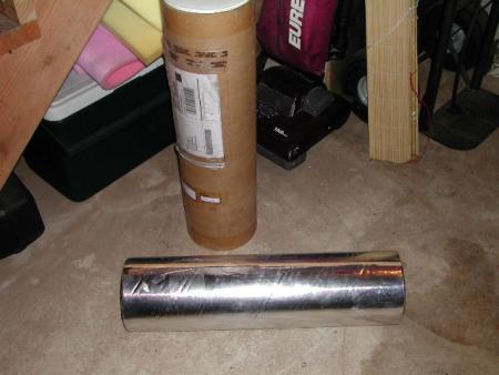

    Well I may as well put it on here as well.
    This is how it's shipped.Only 30 lbs a roll.
    [​IMG]
    It's about 1 mil thick.
    [​IMG]

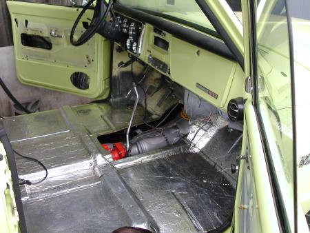

    I took the floor down to metal,got all the crud and crap off 1st then I laid down a coat of spray on sound deadener and rust proofer.
    [​IMG]

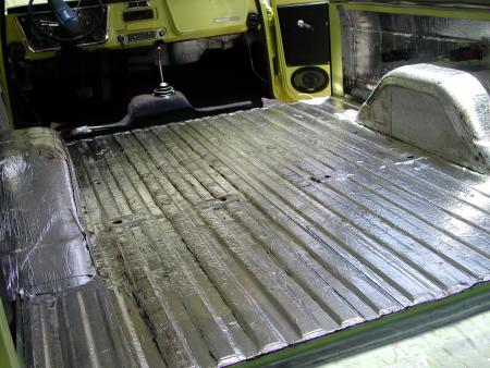

    Then I covered the whole interior of my Blazer.
    [​IMG]

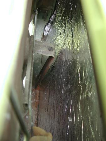

    in the door here
    [​IMG]
    The bed and bed sides
    [​IMG]
    The product is a little labour intensive to install but it works great! /forums/images/graemlins/thumb.gif
    You can get it off E-Bay for about $125/roll.
    A roll covers 70sq/ft.I used 1.5 rolls in my Blazer but then again I covered EVERYTHING.
