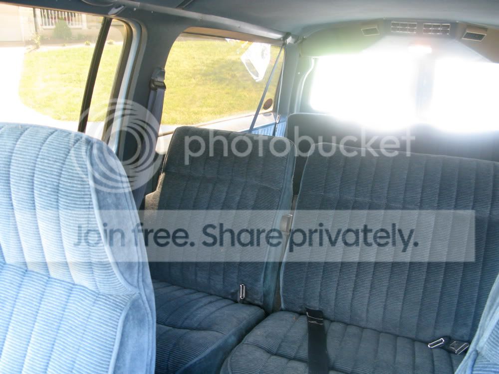

Or, if I retain the crew cab's back seat, does any company make a reupholstery cover for a crew cab seat that matches the Suburban's up trim cloth? (I don't think I have ever seen the same cloth pattern in a pickup as the 89-91 Suburbans, or am I wrong???) This cloth:
Basically, I would like the interior to match, LOL!
Your best solution for nice matching buckets and rear bench will be fronts from an 81-88' burb. Then call LMC or somewhere and get front bucket upholstery and a single cab front bench upholstery. Throw the covers on your burb buckets and existing rear bench.
The foam is different on the 89-91 seats. Good luck finding a nice front bench from an 89-91 single cab silverado or sierra classic with matching upholstery. Not saying it doesn't exist, but rare...
That's what I am wondering, does anyone even make new bench upholstery that matches those front buckets? I've never seen a bench that matches. I wouldn't mind buying a new bench upholstery set but never seen it!
So, I guess it boils down to this- in order to have matching seats, with front buckets, I can't run the Suburban's set since the padding structure differs??? So, would have to go all different seats???
10-4.
Crew or burb front bench from 89-91 will match if its a silverado or sierra classic. Those won't fold for behind the seat access.
Crew rear or reg cab front from 89-91 r/v series silverado or sierra classic will match and fold.
These seats do exist but are rare and $$$ if you do find them. Plus you would need to find one the same color.
81-88 burb bucketd are dime-a-dozen. Easier/cheaper solution imo.

Hmm, looks like this might be a little more involved than I thought, I was hoping to have a matching rear bench with the 'Burb buckets, I suppose I could get another set of 'Burb buckets and run 4 buckets.
The only issue I see with using the older seats with the rest of the 'Burb interior is the door panels have inserts that match the seats so, to make everything all matchy-matchy,I would have to change that portion out too.
