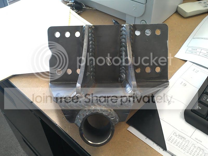

The WFO Concepts Shackle flip showed up today. This thing is beefy!

Shackle flip looks good, I like the adjustability.

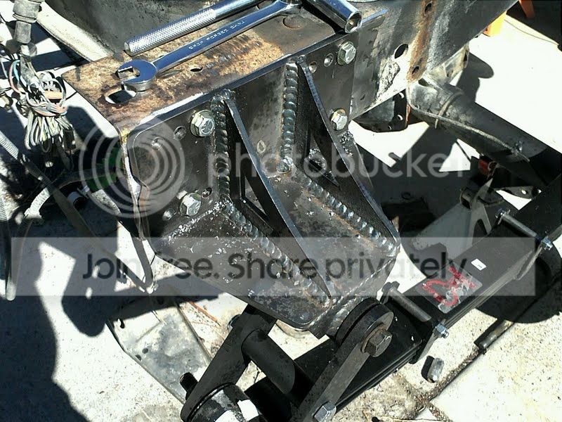

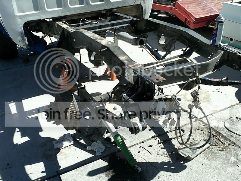

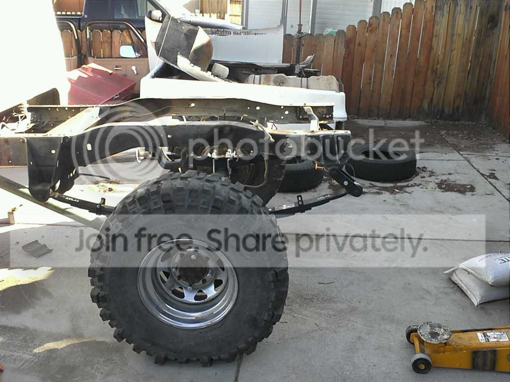

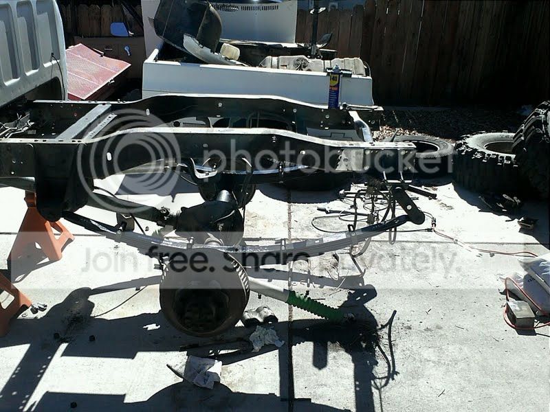

so today was out with the 6" rancho suspension and in with a set of the atlas spring 64" springs.
The leaf pack it a 9 leaf pack but soft as warm butter.

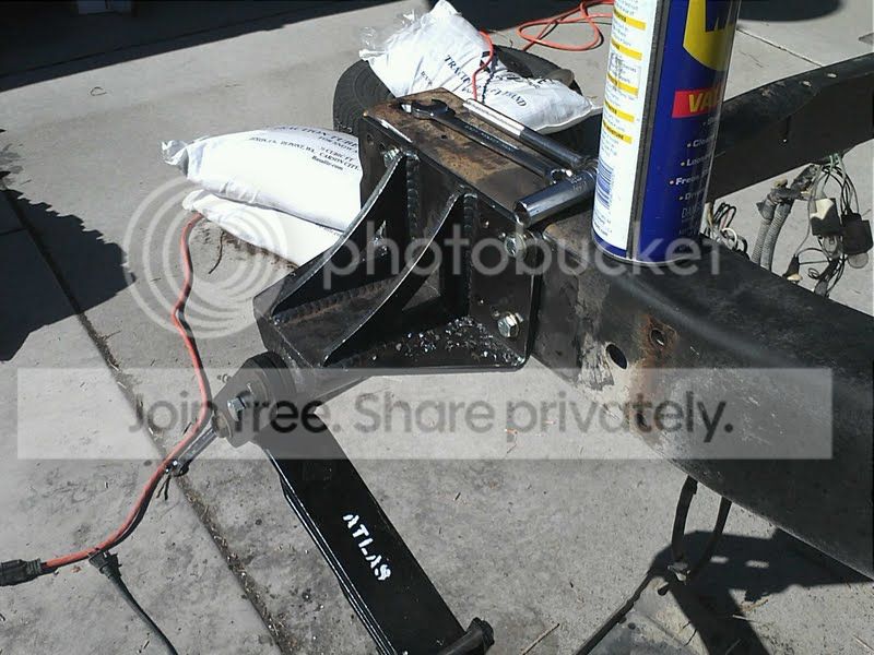

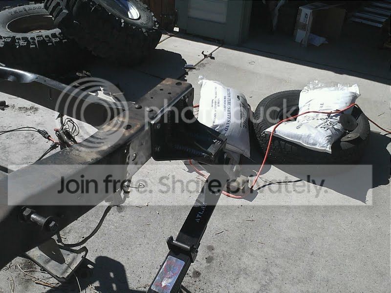

You can also run the 64's while still using the stock hanger. the shackle flip from wfo concepts just got moved to the very end of the frame. which I think it will work just fine this way.
In no particular order.
No the next step is to stitch weld or fully weld around the shackle flip. But i need to have a friend come over and do that.
And also for those thinking that you need a shop and garage to do this, i am proof that you don't. All of my tools fit into a 12" harbor freight tool bag except for my drill, grinder and a bfh and a pry bar. and all of those are also from harbor freight as well.
If you're going to weld, I'd stitch weld, but that's just me. Really, when I put my shackle flip on, I didn't weld anything, however it's not on the end of the frame like that.

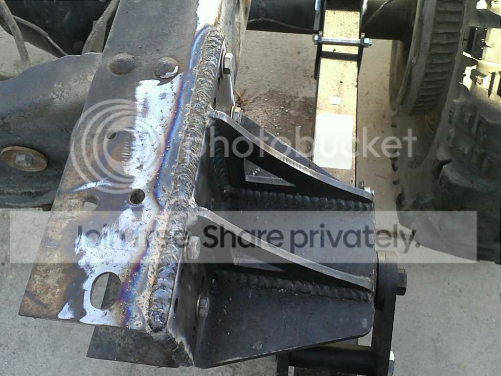

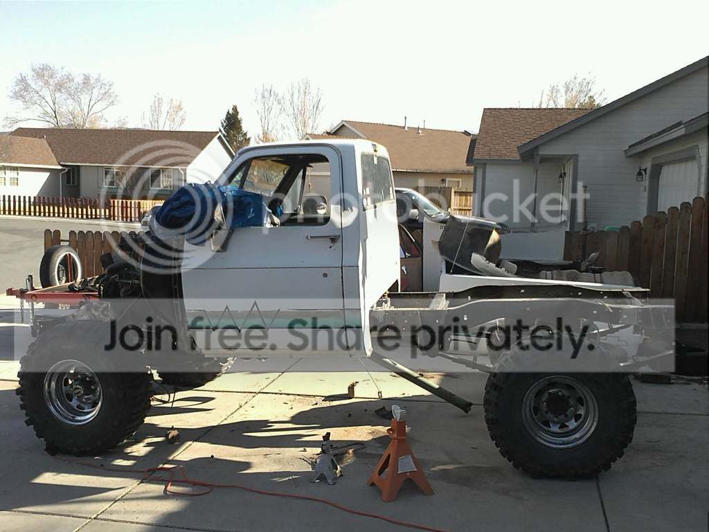

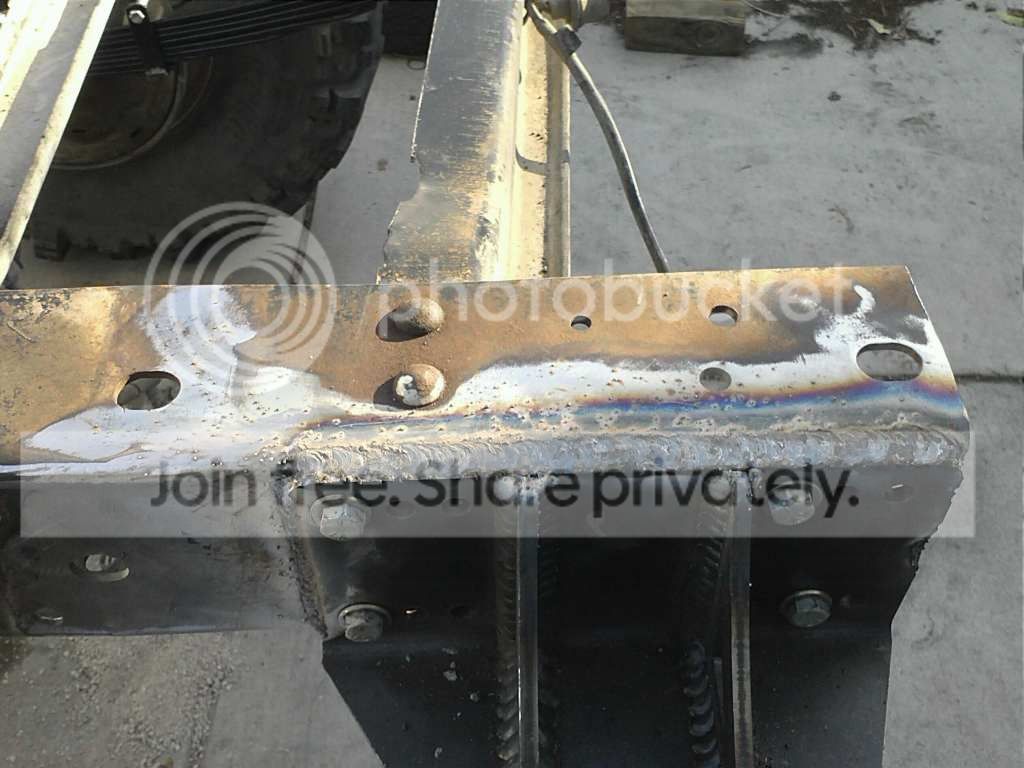

So it has been a slow couple of weeks. But anyways, the shackle flip is welded on, and the flip stretched the rear end about 5". I also got the steering box brace welded on. All of this was with the help of a friend. I can't weld to save my own ass.

One thing if I may you might want to move your front hanger forward a touch when you get some weight on that back end that shackle angle will be 90* it might sit right against the frame
Yeah i was thinking the same exact thing once o put a little weight on it.
