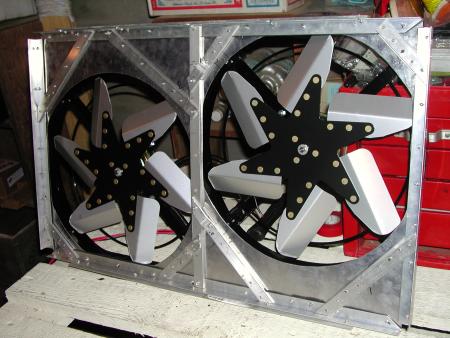

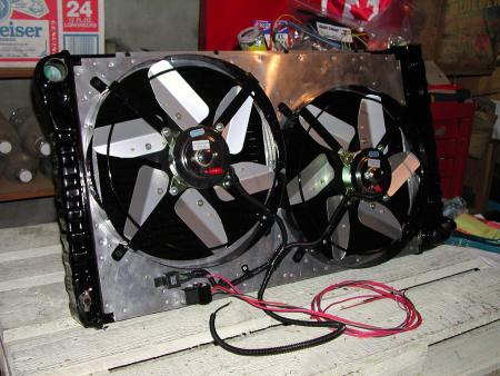

those are my fans, and i need a shroud!! Who made that, and how much to make me one? or do you have any info on how the shroud was made? /forums/images/graemlins/ears.gif /forums/images/graemlins/ears.gif
Re: Is anyone using the dual 15\" electric truck fans from Flex-a-lite?
I made it.That's my set-up.
I used 3/4" angled aluminium to make the frame,all rivited together(I can't weld aluminium).I then covered it with a sheet of aluminium.I cut the holes for the fans with a pair of scissors.(ya it's thin enough).
I made a 2" aluminium strip and wrapped that around the fan's frame to enclose it alittle more and help protect my fingers.
Here's the inside frame(3/4" flat stock aluminium)
mounted on the 4 core rad.
