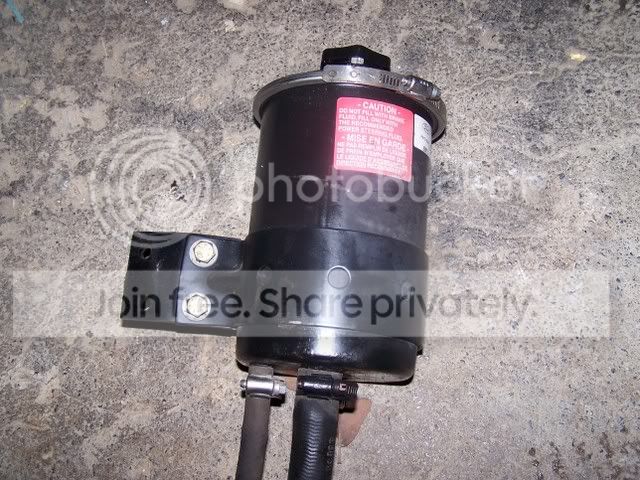

Is it possible
1-tonmudder
Apr 24, 2005
3,052
In a junkyard somewhere
to use a power steering remote resivoir that is too big.I have been looking around for one to use when I do my hydro assist and picked up this yesterday from a crashed Ford chasised winnabego.It will easily hold a gallon of fluid.
No. That thing is great! I have been considering using an older external reservoir myself. Know I know where to look for one the size I want.
that will be great especially if you make it return to the bottom of the res, and not the PS pump... it will help the fluid cool alot better instead of recirculating the hot fluid like a stock setup...
JIMMMMMY is that you JIMMMMY?????? Your trans is on the way!!!!!!!!!!
I have a "T" in my return line going to the pump since I couldnt find a hydraboost pump with a three hose hook up,so I'll probably run the return from the hydraboost to this res.
run the hydroboost to the pump and the PS to the resovoir... the PS gets WAY hotter...
