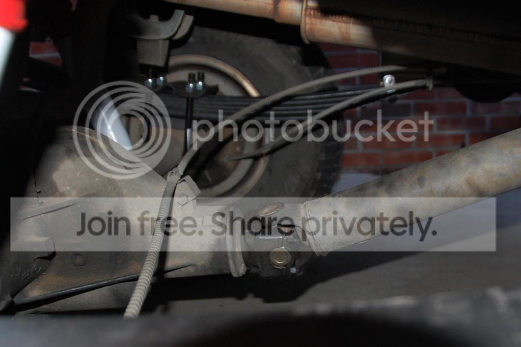

Is my driveline angle good?
kodiakisland

This is with 2.5 inch skyjacker springs and a 1 inch zero rate. The springs did not come with any shims and the zero rate is not tapered. I have not driven it yet, but it just looks like the axle should be rotated up some. What do you think?
get an angle finder and figure out what degree you need to rotate (the pinion angle should match the T-case output angle), then mill the zero-rate accordingly
So if the pinion angle turns out to be the same as the T-case angle I'm good? Within how many degrees off is OK?
These 2.5in springs were the same length from center pin to spring eye and did not have any taper. They also did not come with any shims. I'm wondering if I put them in backward or if it would make any difference. The instructions said the thinck end of shims and the long end of springs toward the rear, but there were no shims and no longer end.
Maybe I'll call skyjacker in the morning and see whats screwed up. I wouldn't think the 1 inch zero rates would be the problem.

Drove it today. Slight vibration up to 25mph and then no vibration faster. I only got it up to 55. It's not licensed or insured so I didn't get far from home. The angle appears to be about the same from the T-case.
