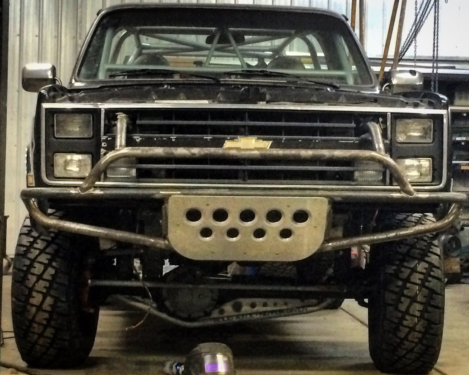

truss it for good measure. I've read the C's are the weak link with larger tires (35's-37's).
Not mine vvv.
