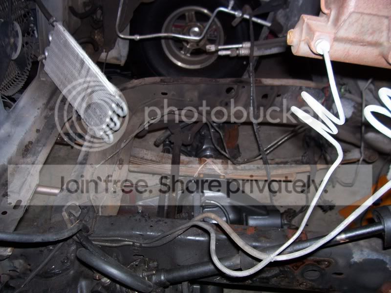

Heres an 86 2wd
Looks like it's on the outside to me
I bet that box is from a chevelle or something. Nascar boxes also look like that
Heres an 86 2wd
I can't help myself right now so i was just going to come straight out and ask you how stupid you are to think this pic is a 2wd with a front 4wd axle with leaf springs sitting right in this pic until i noticed that it is a conversion in the making. :haha:
Now i'm pretty sure the steering box in question is from a 1988 and later 2wd truck.
