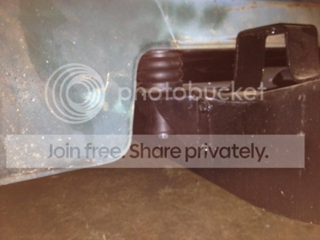

I bought some core support and cab mounts. After putting the cab mounts on and stepping back I noticed it's got quite the rake. Seems like the rear is spaced off the frame farther than the front.
The cab mounts came as a kit, in one bag, but this just doesn't seem right. The front rubber looks like hockey pucks, the rears look like this....
Not sure I'm much help. All of mine on the K5 are hockey pucks.
I took a cab off a '73 K10 and it had those "bellows" looking rubbers factory..
I think they changed them in later years to a more "straight sided" style..they might be taller than the newer style?..
I asked another site and did so e research. Seems these are for 3/4 ton and 4x4 trucks. The big question now is did I order the wrong ones or sent me the wrong ones :(
I've got the wrong core support ones too :( but that's a separate part number and my fault. Fudge
