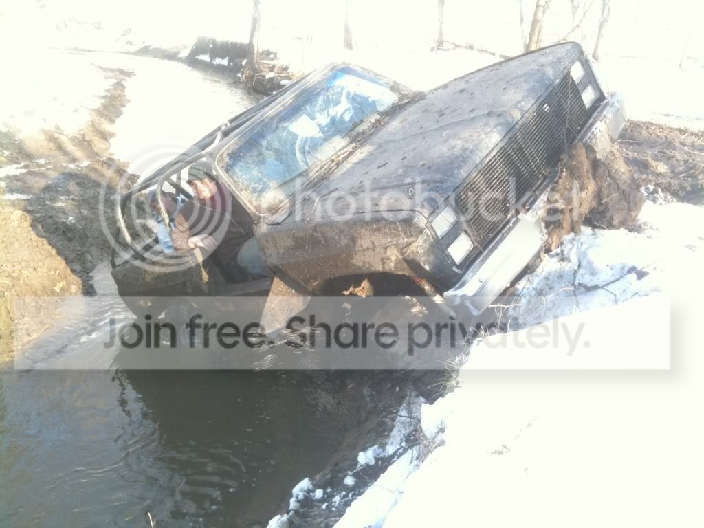

My throttle got stuck today while turning around in a creek and I ended up almost flipping the damn thing at about 20mph. I shut the key off and while I was still moving, I threw it in park. Now if I put it in park on a hill, it clicks and rolls. I know that I broke the parking paw/pin but my question is, if I don't have to put it in park would it be ok to drive it like this? I don't want a piece of metal ****ing something up.
Here is a pic because I am a whore and you guys love pics...
