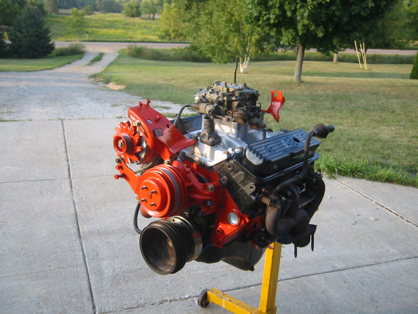

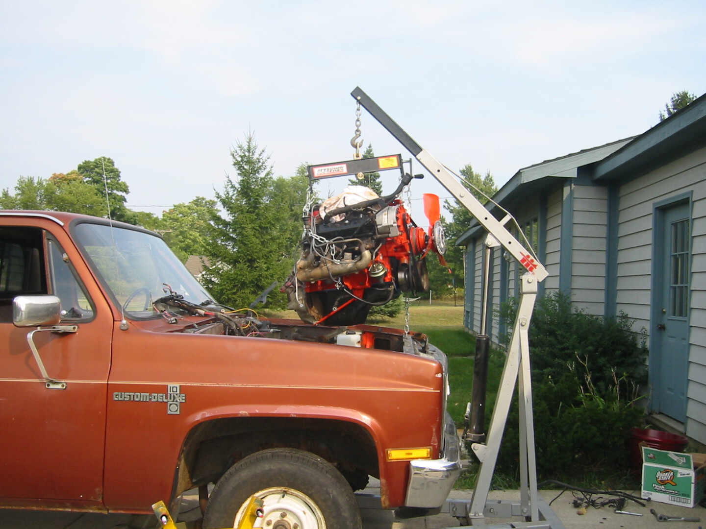

    Well, after many long hours of research, wrenching and swearing, I almost fell out of the cab when my first complete engine build fired over on the first keystroke. Put about 20miles on her today, throttle response is noticably better, way more umph off the line, a couple 1/2 throttle launches seemed better than full throttle before teardown. Idles smooth at 700rpm, smooth and no shaking through whole rpm band. Still needs a couple adjustments I think, blows a little black smoke on hot start ,a little hard to start hot,. Overall, I think it's a good build, but time will tell.
    I know it's just a rusty 'old C10, but it's my Daily Driver.
    Specs:
    1986 4.3l
    1997 Vortec heads (new)
    Edelbrock 2114 Manifold
    Stock rebuilt Q-jet carb
    Silvolite pistons
    Hastings Moly rings
    Block bored 0.030 over
    Crank/rods std. (just polished, not ground)
    Comp cams 252 grind flat tappet (non-roller) cam, timing set, lifters, pushrods
    Proform roller tipped self-aligned rockers
