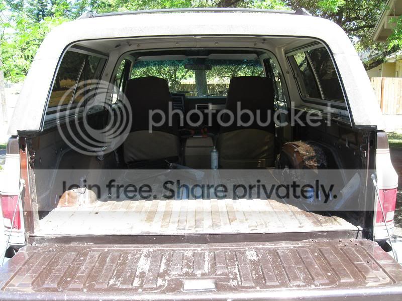

Putting all the interior in the rear up for sale. Going to get this trans rebuilt and have at it. Step 1. Suckering in a few friends to help me remove this topper. :whistle: Not sure on my method for building yet, if you read my other thread. But first this tranny needs to get fixed, or find a new one, and my interior needs to sell.

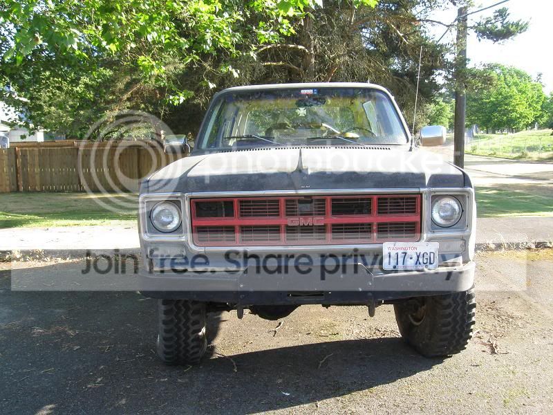

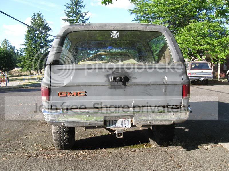

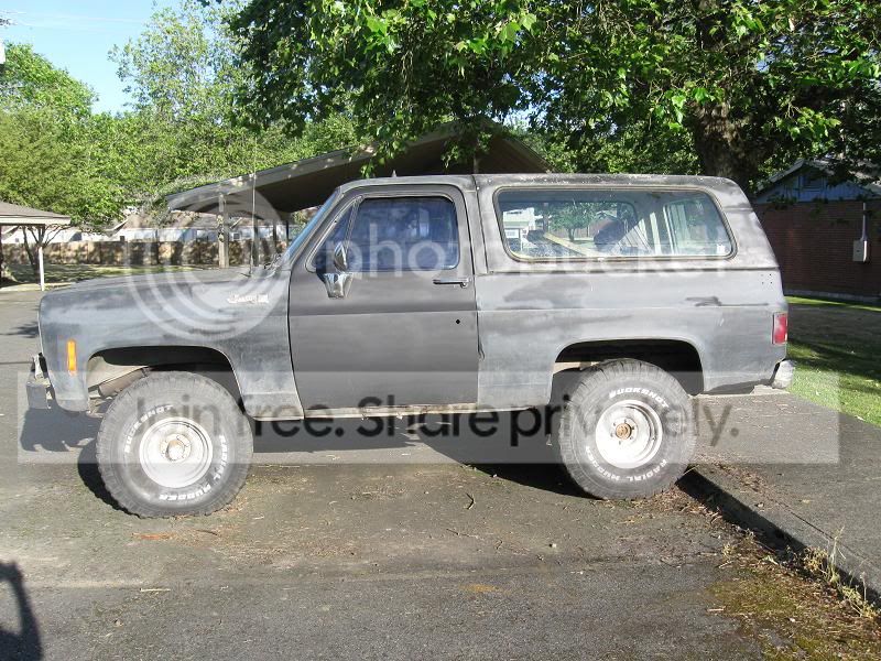

So my buddies 76 Jimmy didn't sell last night like he though. And I've been mulling around the idea of buying it off of him and taking everything I want and parting out the rest. But I gotta decide if doing an automatic to manual swap is worth my time and effort. But there's a lot of goodies also like a stock Qjet from the year range I want, headers, tach gauge cluster, lift, 4.xx gears, winch bumper, and another tailgate. It's a completely working rig, minus needing calipers, tires, and a little brake and ps bleeding. It's a frankenstein, and won't die. But he wants too much for it, prolly let it go for $800. Unfortuantly I can't part it out on post in the parking lot. Just painted the doors on it last week though, look pretty nice. But the rest is pretty rough, definitly a wheeler, and does a damn good job at it.

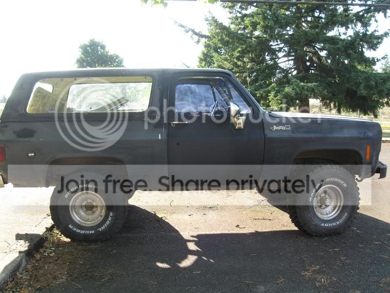

Since your truck looks very much like mine, here's what yours will look like with 4" lift and 35s.
Maybe that'll put a build idea in your head. :D

I'll start stripping the interior later on today, just gotta find some place to keep it clean and dry. Everyone's off work today and tomorrow, so I gotta make some phone calls to get a few guys to help me with the top. Could rig something up with the carport but I bet the neighboors wouldn't like that. I may end up fabbing an enclosure outa plywood until I have the time and material for the conversion.
Before:
After:
Good stopping point for the rear today. Time to take that tranny pan off and see whats up. Buddy of mine was a transmission mechanic for a while, hopefully he'll have some insight.

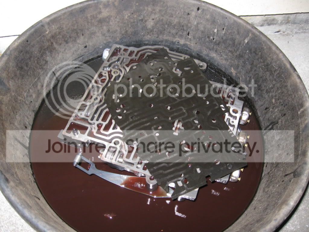

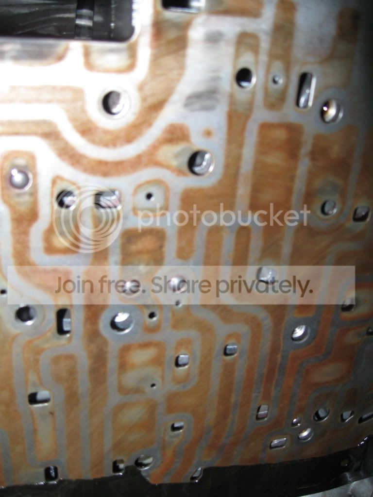

1 checkball, 2 checkball, 3 checkball, 4...
Figured why not, what's the worst that can happen? :dunno: ... famous last words.
Gunna order a transgo kit and book on Friday. Till then I'll take it apart and clean. Was going to hold off until my buddy showed up to give me some pointers, but he's in the middle of moving, and I can't do anything for the pickup conversion till that topper and tailgate sell.

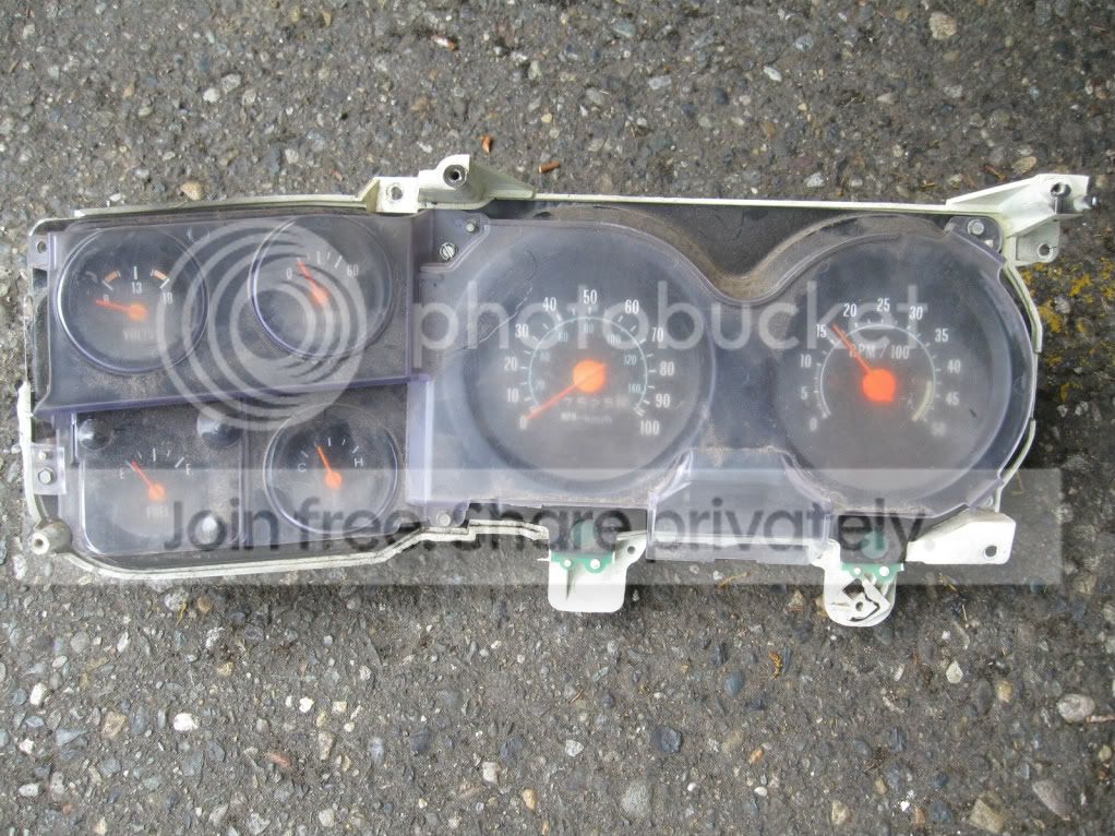

Starting the part out on the 76, trying to decide if I want to put the tach in mine, or sell and put the money towards the 85. :dunno: I do want a tach, but even a cheesy aftermarket one will work. Plus the long term plan is a diy4x aluminum dash with custom gauges anyway.
2 things
1. sell the tach guage panel and get a cheap accurate aftermarket one. i see the autogage ones on craigslist for cheap

I'm leaning towards selling it, at the same time I'm not interested in testing each gauge. I do believe I'm going with a half (or part) cab extention instead of flat against the B pillar. I like that extra bit of space. Think I'm going to modify my tailgate to run the full width of the truck, and weld it in place, insuring I can still access the inside and repair/modify as needed, and get a pickup tailgate for the back. So I'll still have my idea of a electric rear window :waytogo: I did notice in my scheming how the seats would touch the back if it were flat. At least the drivers does.
