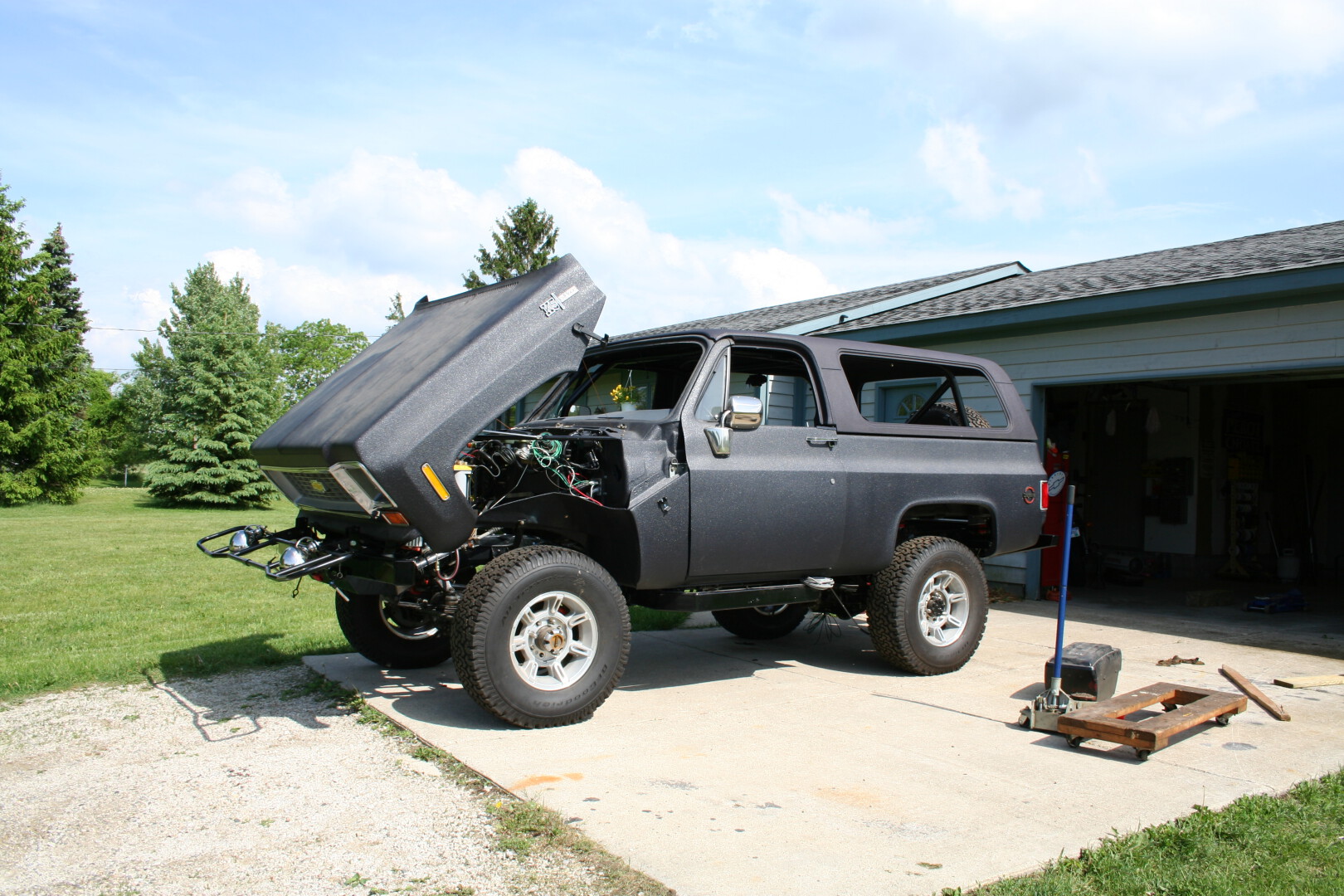

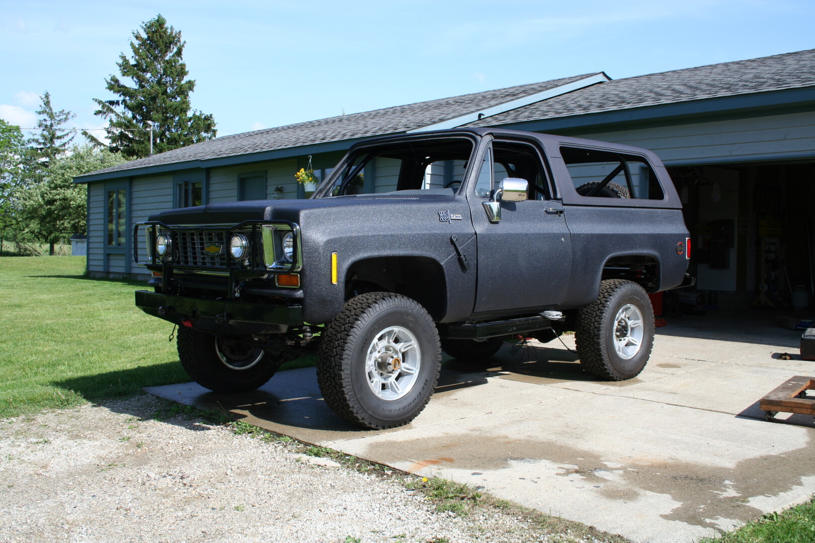

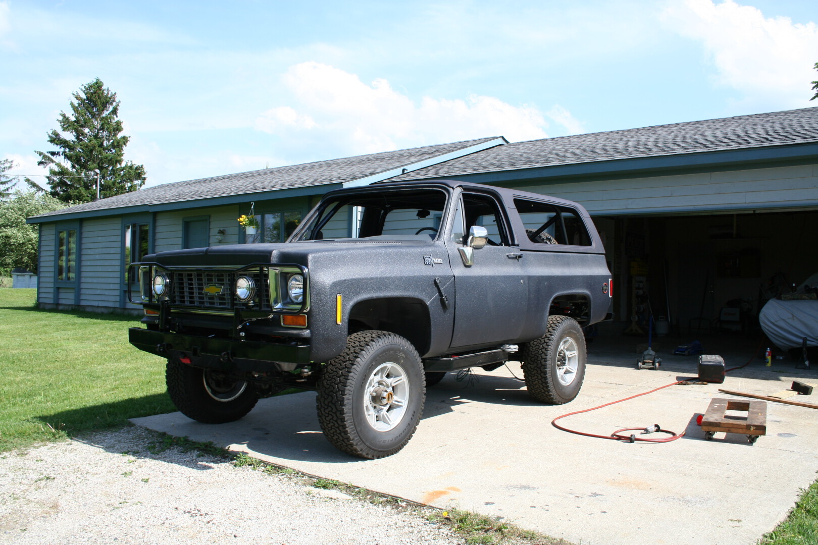

Ohh.....man.......it's a shame we're moving, 'cause that's gonna suck up the engine fund, but by Christmas I hope to have my engine fund built back up again and the RamJet installed....
Oh well..gives me time to work on the odd's and ends...like weather strip (which I bought long ago), interior lighting, dash, and the rest of the interior like seats and belts, those of which I had already pre-fit so they are just bolt in.
You know, I really don't think the fiberglass body is saving me any weight. With all the extra stuff that's been added, huge heavy bumpers, full cage to frame with integrated sliders, at least 200lb's of copper in my wiring job, I'm really gonna get curious as to what the weight is when it's all done....

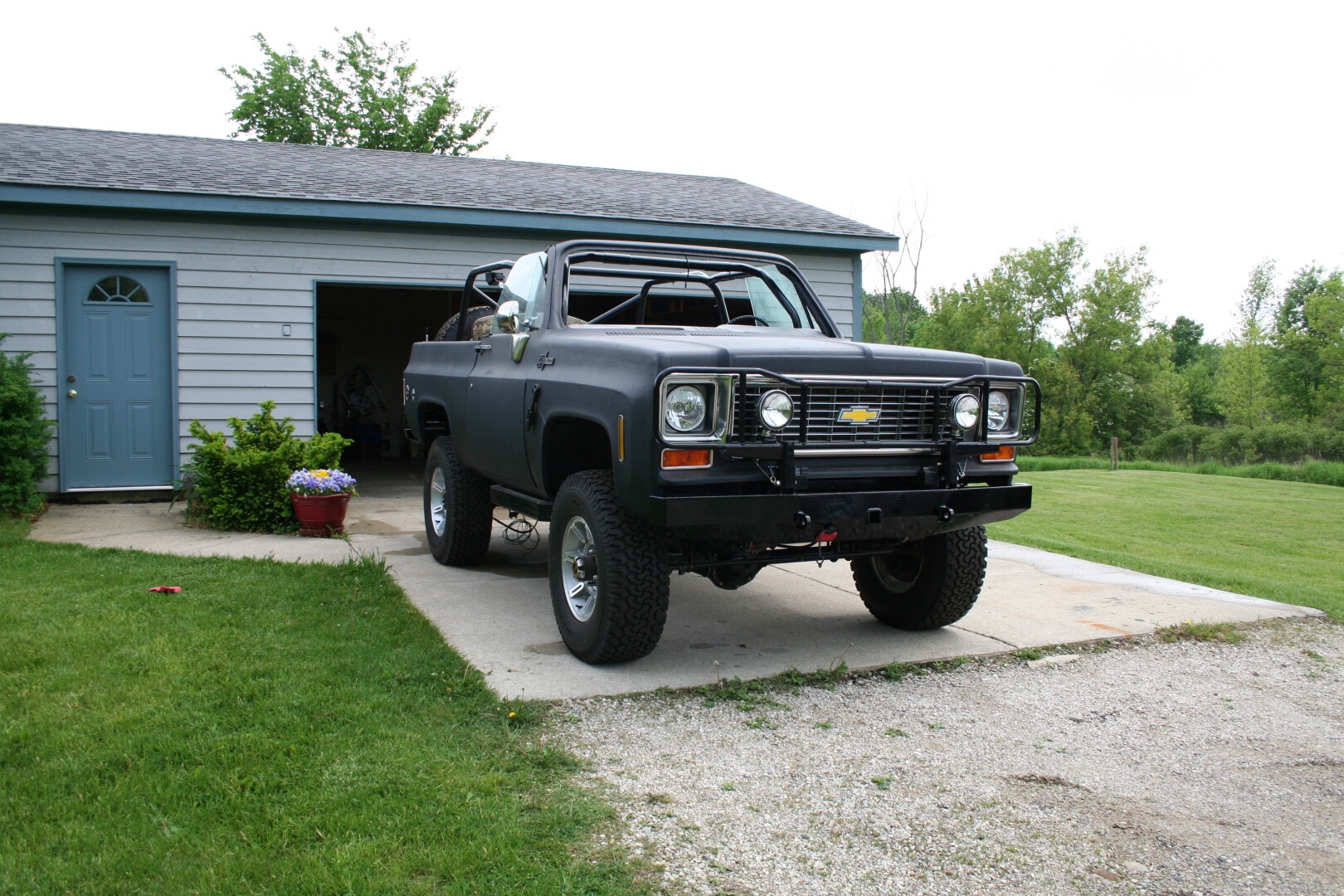

1978Blazerk5 said:
how hard was it to fit the body to the frame?
It wasn't a bolt on deal. They tell you that up front, and all over their website. The bodies aren't for the light of heart.
That said, they (being US Body) could spend a little more effort and line up their support struts (encased in fiberglass) to at least fall on all the stock mounts. Oh well, most of them did.
I made a full cage to frame using some over the road truck steering gear bushing to allow for flex because I was paranoid about cracking the body. Turns out that paranoia was unfounded, many pieces that I've cut off, I can bend and touch the two ends, the glass just doesn't break. The gelcoat will crack off a bit, but the kevlar re-inforced glass doesn't break.
Here's the frame without the body. The body more or less sits on the stock mounting locations, some of which I moved slightly to line up with the body re-inforcment strips underneath. The plates you see there are the cage mounting, there's different sized plates on the top (or rather the bottom of the cage inside the cab) so there's not a cookie cutter effect going on.
Oh, and there's not holes or weld nuts on the glass body as delivered. So every little hole needs drilled, every piece needs fit, cut, re-fit...etc...you get the picture..the body is basicllyl a shell of the shape and contour, everything else, is up to you.....
