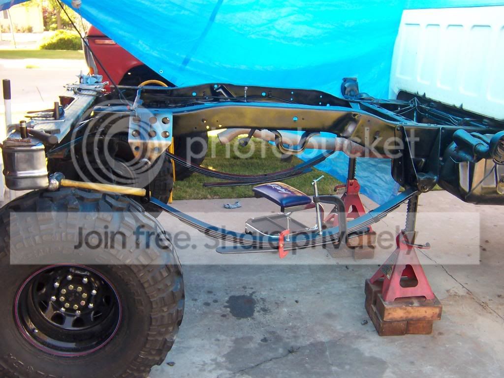

Go for it... I put them under the axle tubes most of the time. If I'm working on the rear end I put them under the front spring hangers (for the rear springs) since they're curved and my jack stands fit perfect up in there.
If you're stands aren't tall enough you can get some blocks like this...
