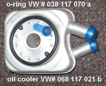

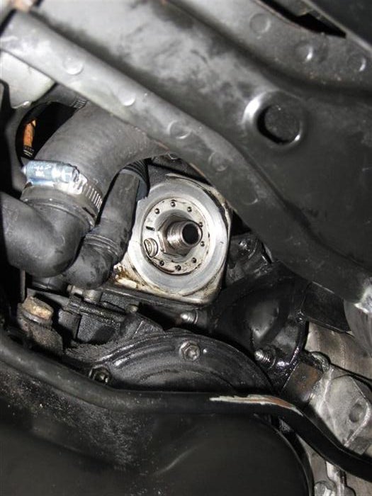

To anybody who owns a TDI already...whenever you change you oil check the 27mm nut that holes the oil cooler flush to the oil filter mount. My car had been leaking oil for quite sometime and I finally tracked it down to the oil cooler seal. A common leak...very cheap to fix. $2 gasket from IDparts.com
When I went to repair the gasket I found the retaining nut to be finger loose!:doah: Appearently like a lot of other things on my TDI the PO did half@$$ed he did this repair as well.
This is the retaining nut in the picture. The torque spec is 18 Ft/Lbs
This is the gasket I'm referring too on the top side of the oil cooler. Luckily for me it has all those little tabs you can attach the two ears to to hold it in place.
Now no more oil leak and I can quit loosing the high dollar synthetic oil that these motor's require.:thumb:
