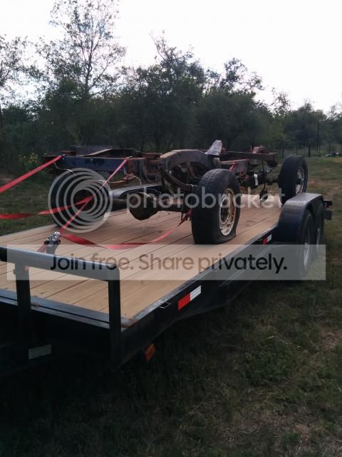

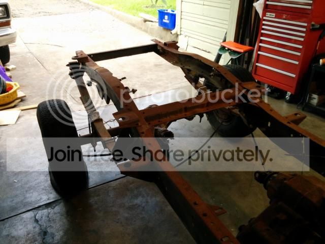

Here's a pic of the chassis after I loaded it on the trailer. Looks snazzy, huh?

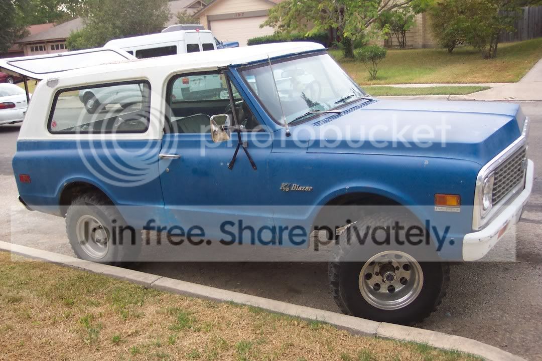

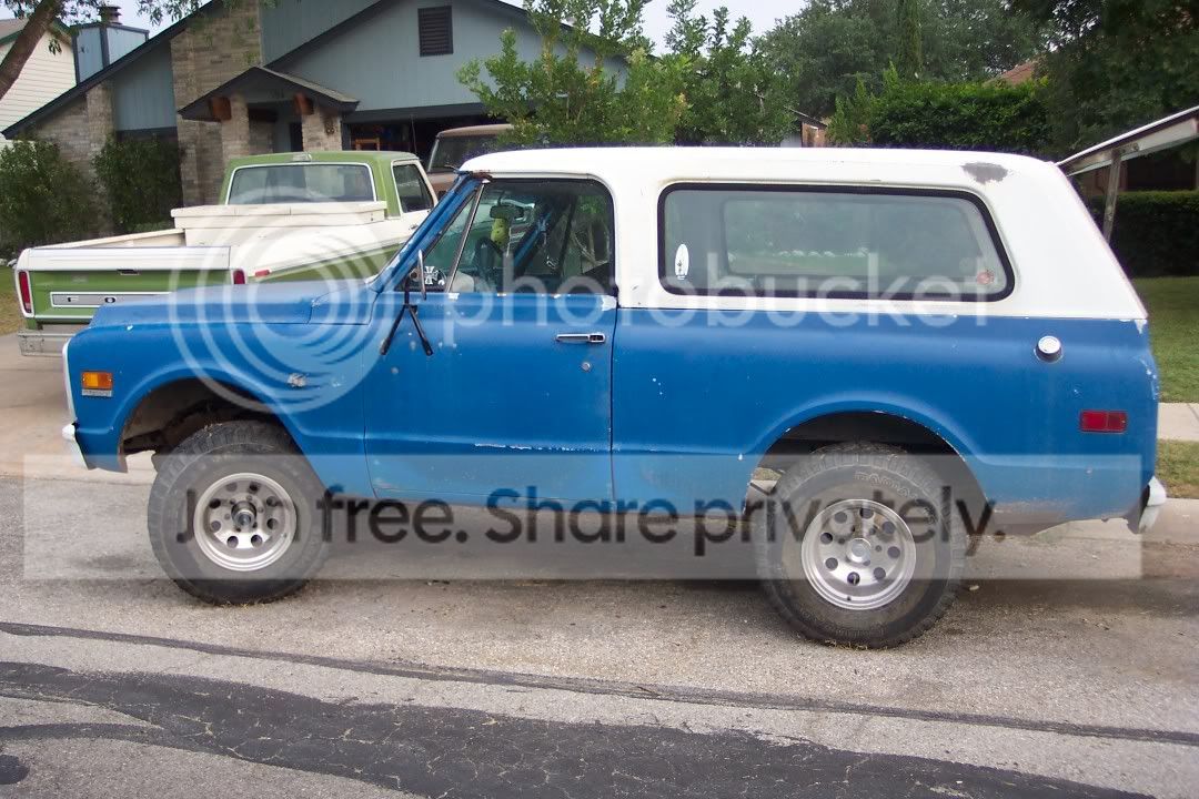

Pics from when it was driving. More snazzy.
It's a little rainy today but once it clears up I'll unload it into the garage and start tearing it down. The frame has a lot of undercoating on it so I will wire wheel it off and take it to get blasted. I also need to get the SF 14 bolt out and weld some new spring perches to it so I can get it blasted at the same time, along with the D44.

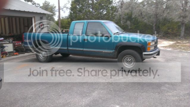

Shameless pic of the truck. I really like it. I'm the third owner. 1993 K2500 with 454 and NV4500. Only 130K on the clock. Pic was taken when I picked it up. It's got some new Michelin AT2's on it now. Those tires were trashed.

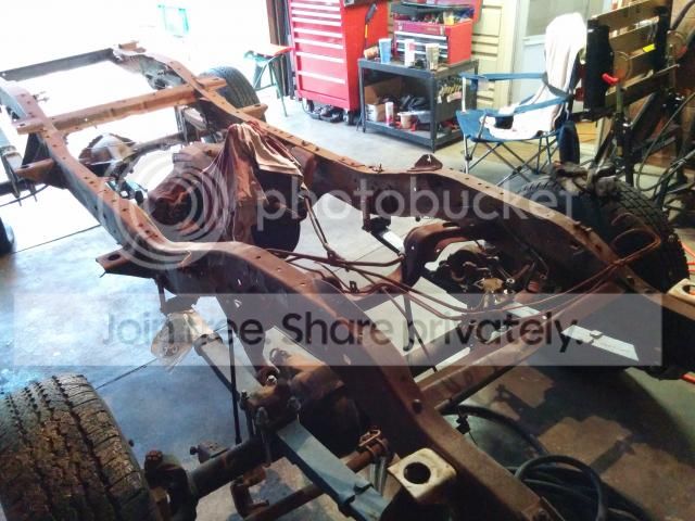

Well, I got it unloaded and rolled into the garage. Considering the length and turns in my driveway, it was quite the workout.
I took a few quick pics before calling it a night and as I was taking the last one I stepped back into 5 quarts of old oil sitting in a catch container that I kept telling myself I should move for that very reason. Pretty much called it a night at that point.
