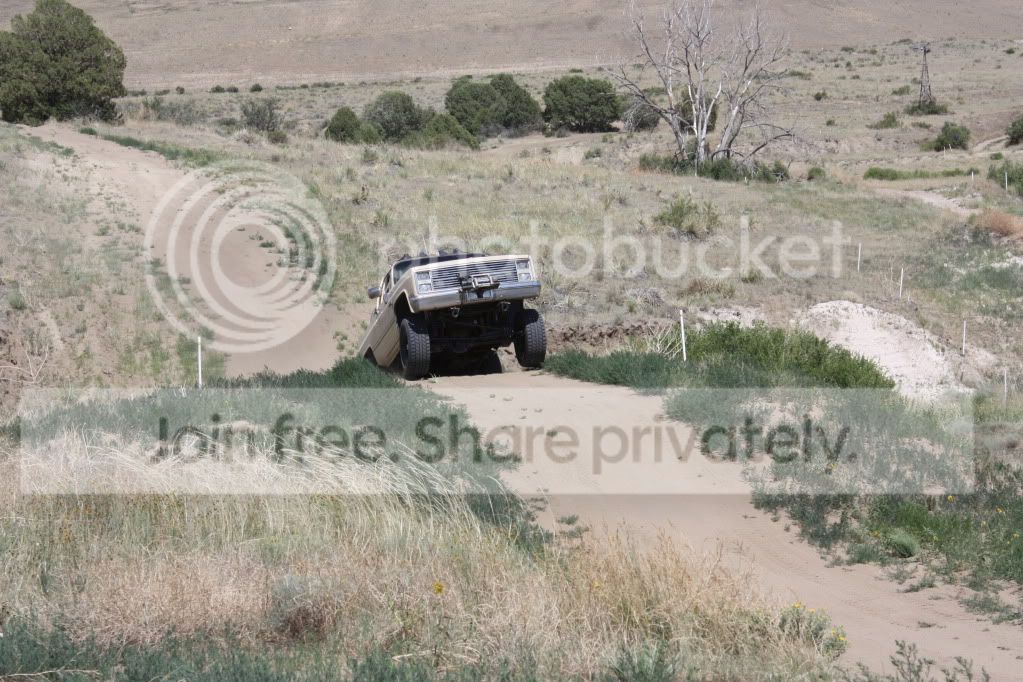

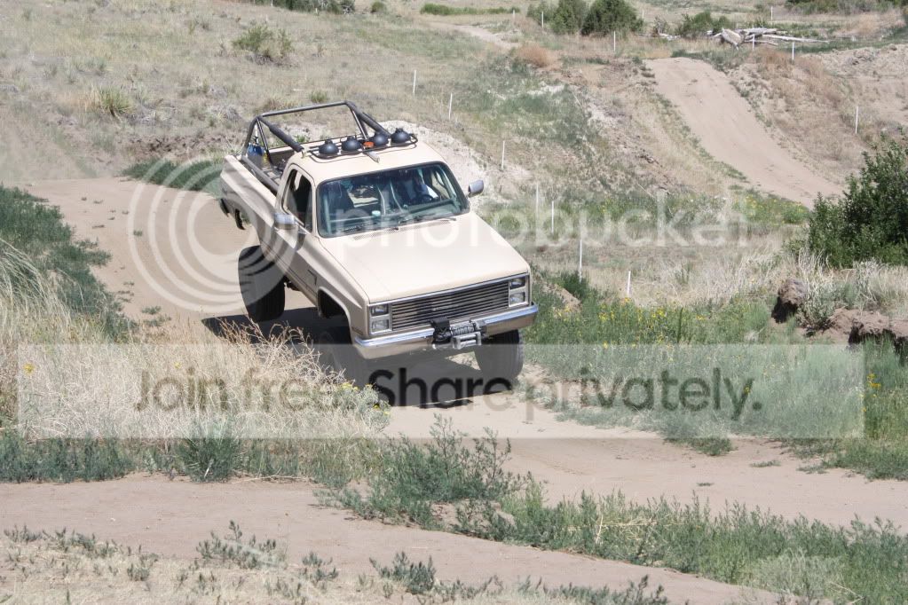

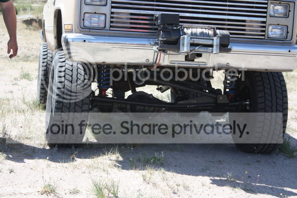

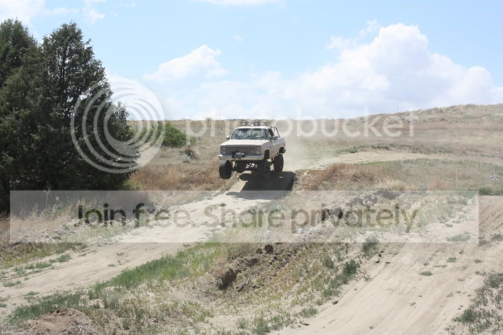

Went to the RAM off road park (XRRA races were a couple of weeks before). Took some guys for rides. I blame the 250 lb friend for the damage. Last 4 pictures are of a jump that I backed off of the throttle and the truck nosed over. I now know how much down force will bend a 10 bolt.

Im surprised your 10b isnt fully trussed. Guess the next one will be lol.

Awesome pic, I luv to see a K5 airborne..screw the mud, screw the rocks, give me some wide open desert.
Agreed, seems like a lot of $ in suspension not to start with a trussed D60 to begin with. Nice flying rig though.

Holly hell Wade, you weren't lying about the new "smile" your tuck has now. Awesome pics!
A trussed front was not an issue in the sand in So. Ca. This hard ground is a whole different deal. Spent bucks on a bunch of steel today. Should have it back in form by Thursday of next week. I am told there are more pictures to come. Friends were shooting as I was running around.
As for a D60. Too much un-sprung weight under the nose. I could not get the truck balanced correctly. If it was a rear engine truck, oh yeh.
Now I just need to remember to stay on the gas a little to keep the truck level.
Light bulb went on on my way home from HD. I had the shell off and the winch on it. No wonder it nosed over so easy. 400lbs heavy in the front end. That was stupid.
