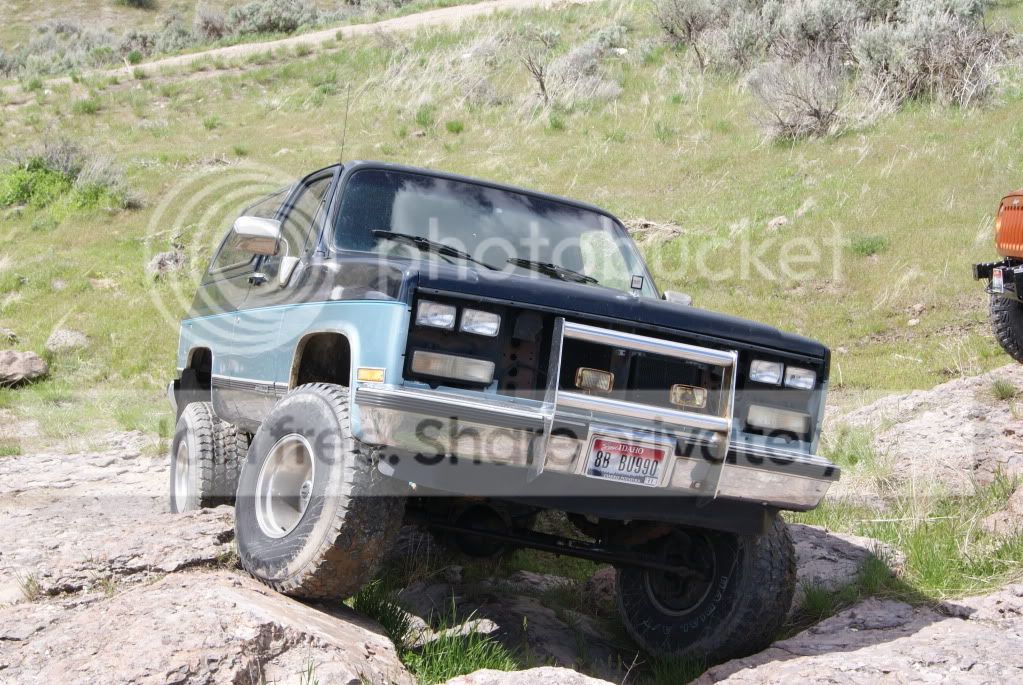

Here is a pic of the Jimmy.
My 35s rub bad when off road with a 6" so if your going to take it off road I would trim a bit with a 4" but I like the 4" much better than the 6" for looks overall. I like the low lift big tire look
