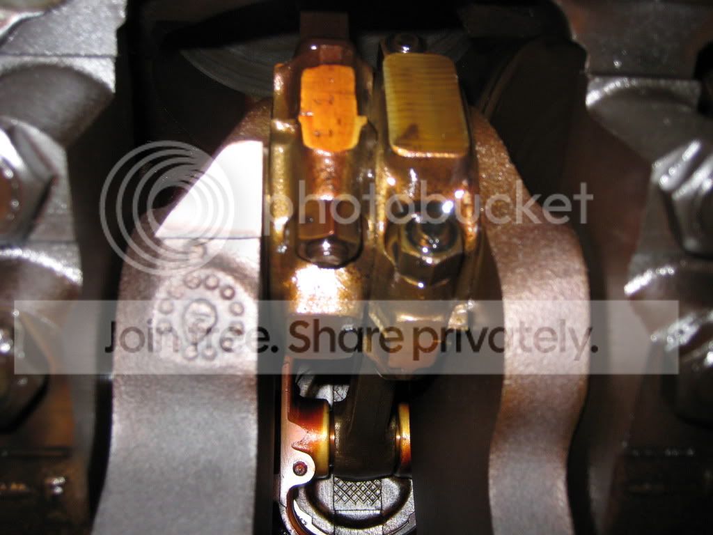

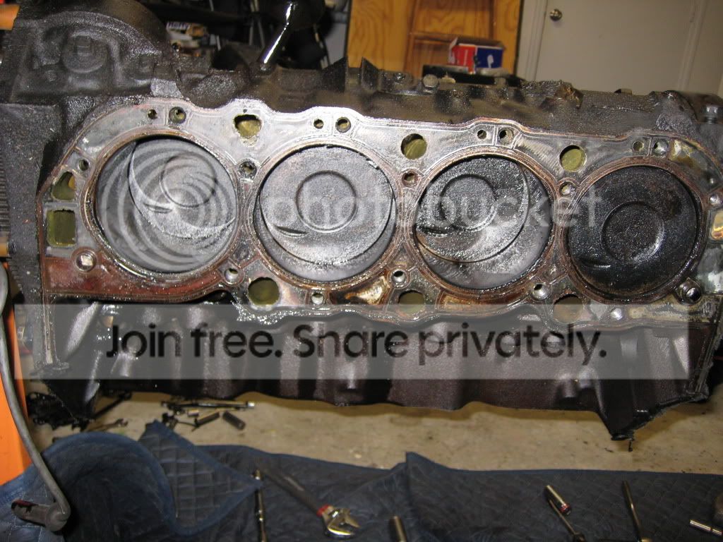

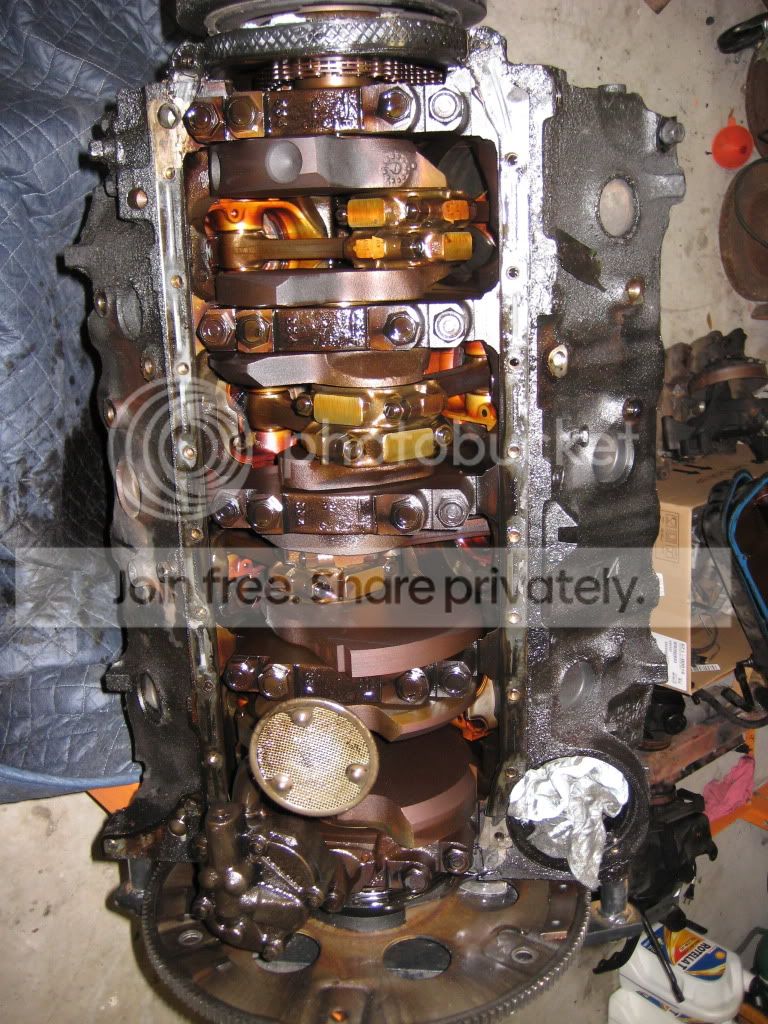

well here are some pics....
just an FYI, my bores were still looking good, but the crank was .020 under. All my caps, and mains were stamped too. So you just never REALLY know what you got til you take it apart. I would at least check a rod or two, and at least one main to see the bearings. That crank does look clean though.
And nice score on the 4 bolt too.

throw a pic up here if you can.

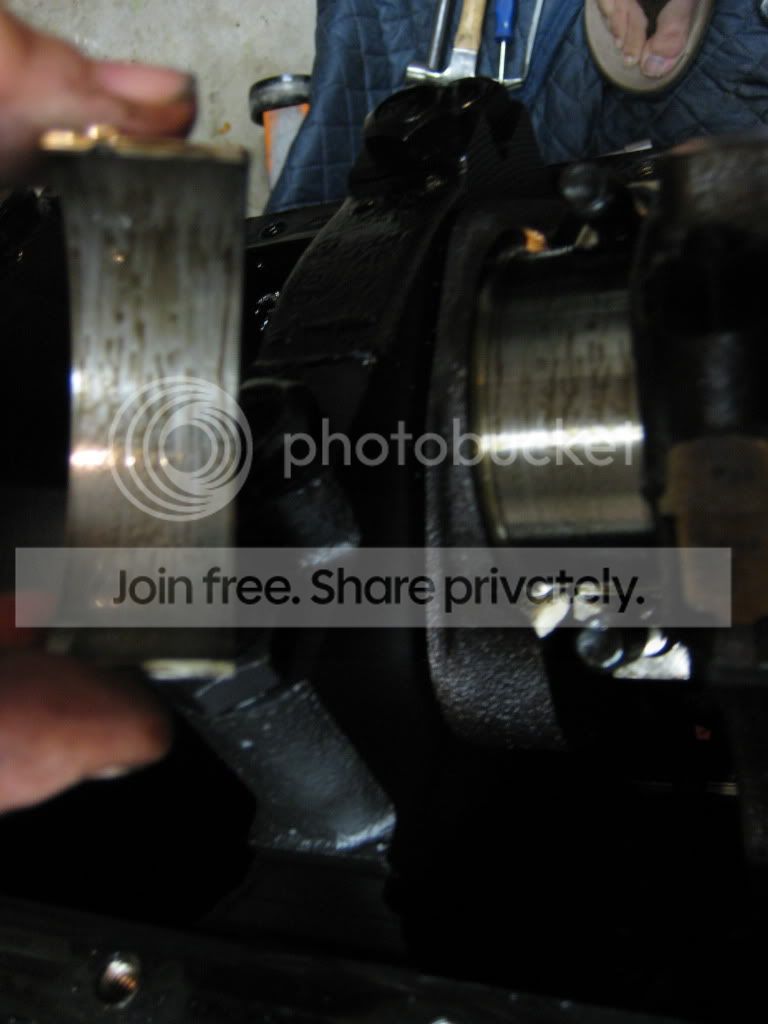

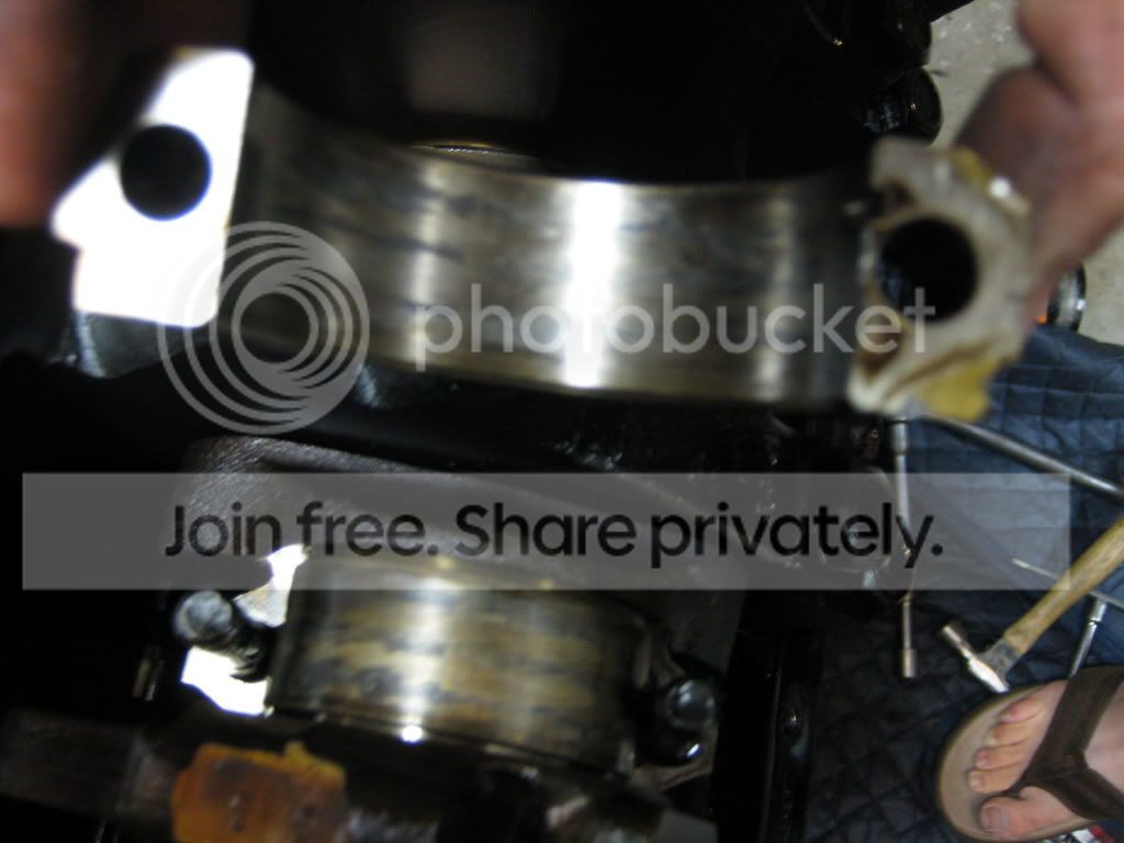

here are the pics i grabbed brother...thanks again

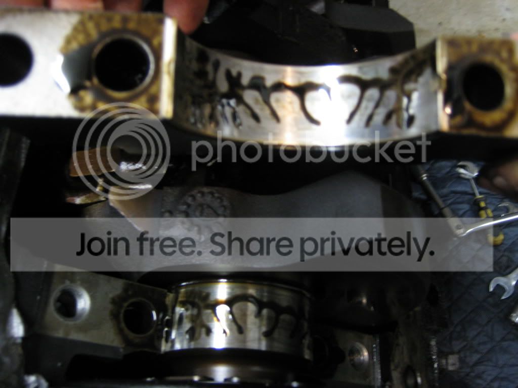

first are the rod bearings

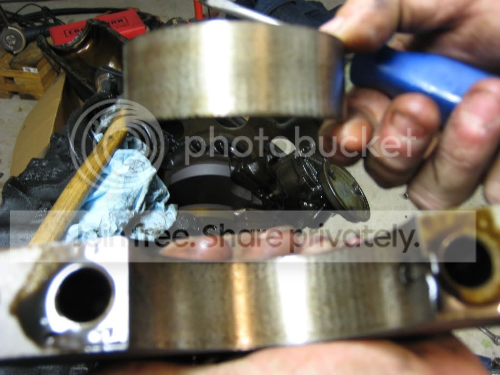

and here is the front crank bearing....
kinda blurry, and wipe the oil off them, do they look smooth, with no gouges or deep scratches, do they have any discoloration, like wearing through the first layer of the bearing material, into the copper? Are the backs of them uniform in color, and no "hot spots", or heat discoloration, look to them?
yeah, they look all uniform in color, there are a few light scratches, but not into the material at all, you can only see them, not feel them.
and i just pulled off the bearing again and this is what it says:
GM4
2621313
7 F 02
They sound like they're pretty good then. If they're smooth throughout the bearing surface, and uniform material of the original bearing surface, I'd maybe check it with some platigage, I'm sure they are fine, but then you know what you have.
