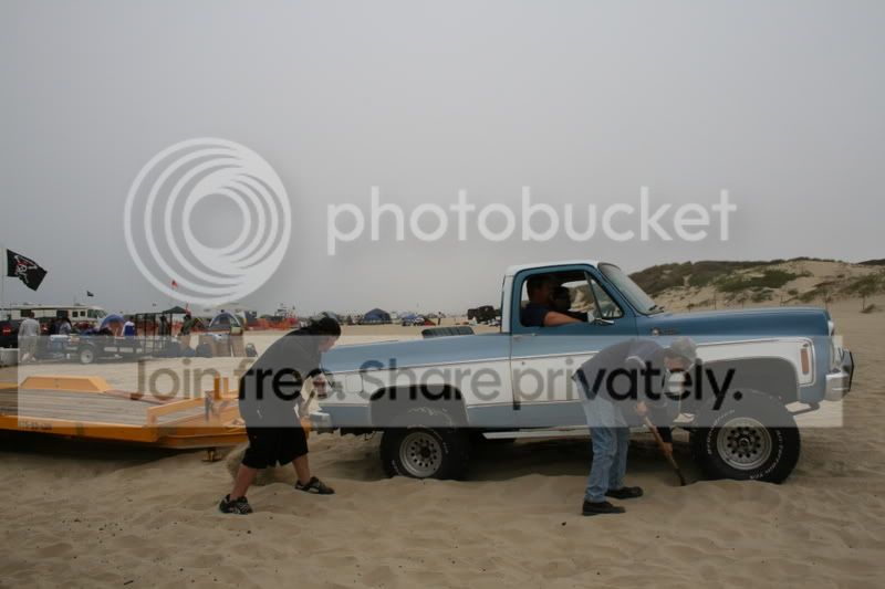

In the summer of 2007 I took it on it's first wheeling trip. For some stupid reason I swapped my bfg's out for my baja claws on this trip. Obviously the bfg's would have been a lot better out in the sand but what did I know.
We stayed down on the sand at Oceano Dunes and I met up with chevyin, two brothers and their dad that all used the same username here on ck5. They are probably the reason I got into wheeling and loving the dunes. They showed me how it's done and really got me interested in building the truck up more.
Sadly I met up with them in and out for the next couple years until they moved away and haven't signed back on here. If I could get in touch with them it'd be awesome but I don't see that happening.

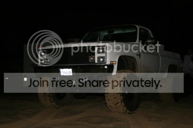

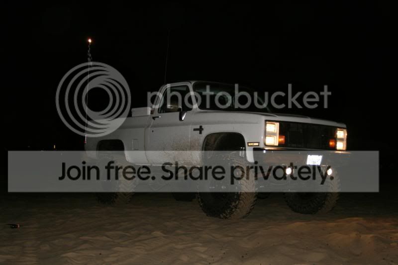

I drove down south to Bakersfield and traded my 38.5" baja claws for some 35/15.5-15 TSL SX's (five of them) and I ran those tires up until a couple weeks ago when I sold them. They were awesome and if I can find some SX's in a bigger size here shortly I'll run them again.

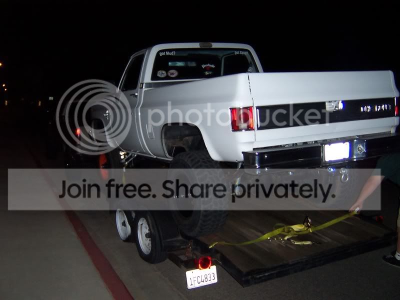

The other thing that happened around that same time was where it all started going down hill. I picked up an '00 K3500 which made the k10 a straight up toy...
It was a good truck for the time but looking back I spent too much. I completely (like $1400+) rebuilt the front end and steering, did a cap/rotor/plugs/wires, put in a big stereo and exhaust. I put on some 305/70-16 Nitto Terra Grapplers on some black steel rims, looked cool and was a neat truck but it didn't like towing up the mountains around here. If I lived in Texas still or somewhere else flat I'd still have it.

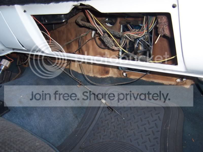

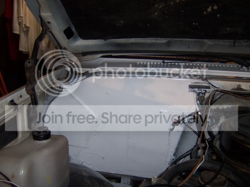

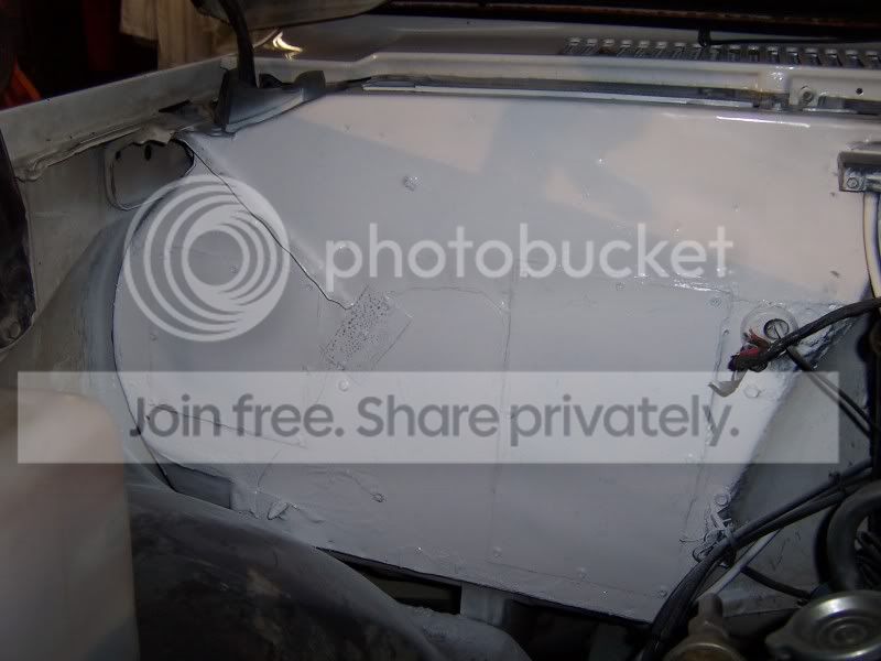

..and did some work under the hood. I pulled all the HVAC out and tried to clean up the firewall a bit.

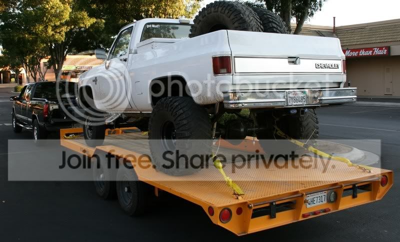

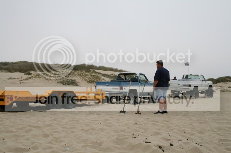

I took it to Oceano to play in the summer of 2008. I still didn't have my own trailer so I borrowed one. As usual with borrowed stuff it all looked ok but once I loaded up and hit the road the tires started falling apart. I ended up having to replace all four tires in Pismo before we could drive it home.
