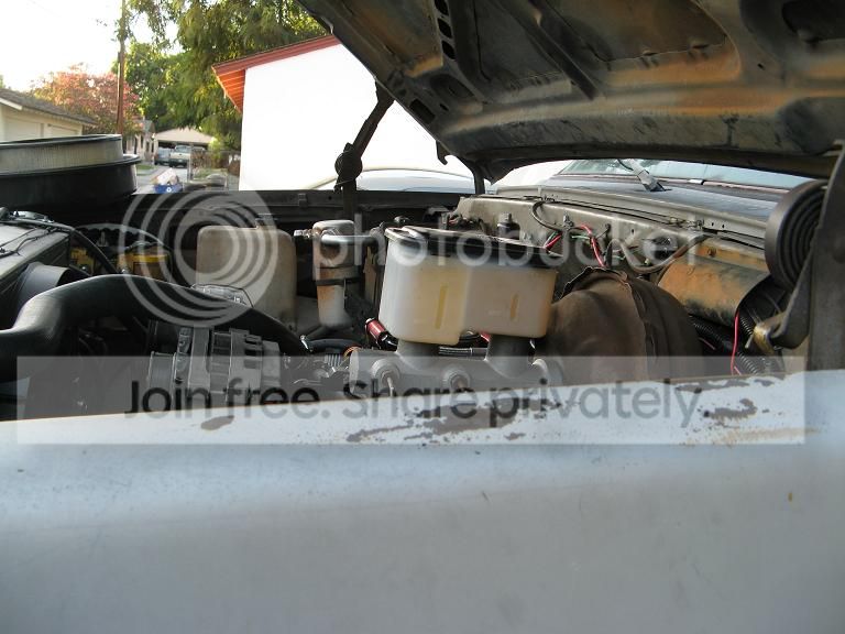

My '99 3500 M/C works fine, but it feels like I run out of pedal. It's not soft, actually quite the opposite. I push down and soon after it gets solid. Not sure if that's a M.C thing or if I'm losing vacuum. I also had to "make room" in the hood for the '99 cylinder. The very back was hitting. A quick hammering on a support area made it work. Here's a pic.
