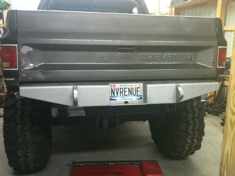

Here's my rear bumper, it's a DIY4X Gauntlet that I had modified (no wrap around ends, mounts higher & tighter than usual).

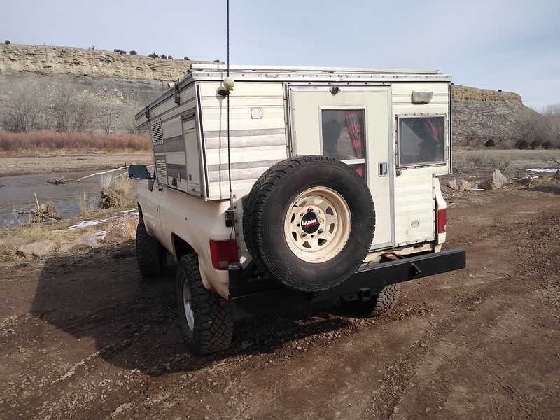

My own design double swing out. My welds are far from great but it will not go anywhere either. I angled each side just enough so that when you pull the 1 inch hitch pin, each side swings out just a little bit. The bolts are greasable and picked up at etrailer for not that much. Only drawback is that I only have 1 recovery pt. Either the hitch pin or the 2" receiver.
Here's my rear bumper. I'm using a D44 hub/spindle as the swingout pivot. It allows it to lock when it's open to hold it in place. I've got a second hub/spindle to change out the basket to allow it to swing out also.

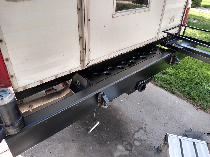

The rear I just finished a couple weeks ago and wanted something that looked clean and fit my build.
