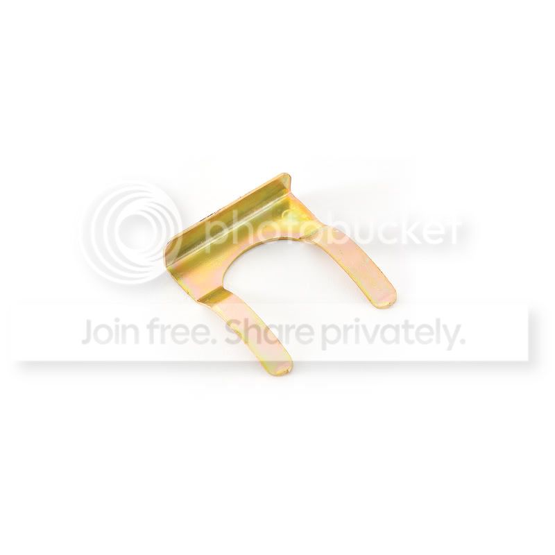

yep, clip will look like this on the backside of the cylinder:
pull it straight off and the lock cylinder will come out! :waytogo:

Just replaced the lock on my pasengers side door... super eazy.
But my clip did not look like that!
Mine was all rusty looking. :D
