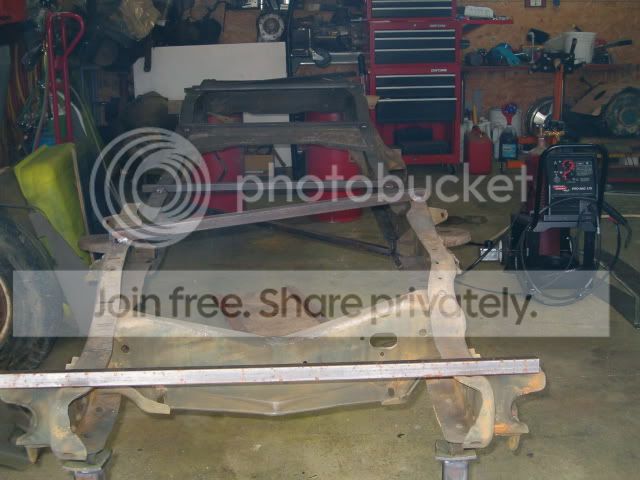

so does anyone know of a resource were i can find frame dimesions for a 4x4 blazer i wanna design a 4 link on AUTOcad so i can see what im workin with ... yes i could measure but its 17 degrees here and i dont wann go out side haha so if anyone knows thanks but if not thats alright...
I have mine stripped, what dimensions do you want.
And its in a 55* shop too...let me know.
I also have a 74 GM service manual....not sure if the dimensions are in there or not.
well i dont wanna put you through all that trouble if you can gimme the width thats a start haha... i need all the goofy angles of the kick up front and rear and when the begin and what the elevation change i gotta plug all those in on CAD and do work i know thats alotta measurin'... it gets to a little tedious.. i appreciate the help though!
check my thread "IRONMAIDEN" for how I have the frame "on a level plane" before I started taking out crossmembers, and boxing. If anything can be had, let me know. I'll try to remember to see if I have a bodyshop type reference drawing of frame measurements.
